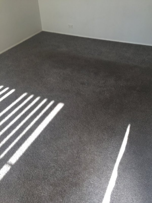

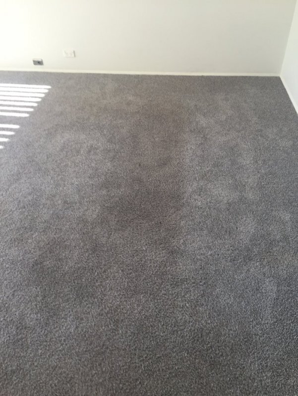

I've cleaned 5 SmartStrand carpets in the last week. One of these was a second visit on a vacated rental property. The traffic lane in front of what I assume was the lounge suite, is grey and ugly. Couldn't get it clean on first visit after multiple attempts. The retailer went out, and sprayed some water on it and scrubbed it with a white microfiber rag, and got some soil transfer and declared the carpet hadn't been cleaned properly. On the second visit I re-cleaned - vac, scrubbed pre-spray, steam cleaned. Photos show not one skerric of difference. I rang the supplier and tore shreds off him for his parlour tricks attempting to discredit my business, and his complete absence of education in the limitations of exhausting soil exhaustion through the HWE process.
I cleaned another one yesterday. I'm warning all customers about expectations before I start cleaning this rubbish. I'll post before and after of yesterday's SmartStrand below. What I'm observing on these carpets is extraordinary absorption of oily soils in trafficked areas or areas exposed to pet coats. Greying out in the traffic lanes accompanied with some matting and elongation of the pile. It is more subtle than with polyester, but certainly there.
Because of the aggressive marketing of this product, some retailers will vigorously defend the apparent miraculous properties of this carpet, and not stop short of discrediting carpet cleaners in there path to absolving themselves of the responsibility of upholding there (claytons) warranties and the shortcomings in performance of the product.
Having said this, I know several of the recommended warranty cleaners for SmartStrand here in Australia and know for a fact there have been instances where they have had to replace.

Photo 1. Before.
Photo 2. After. A big improvement and lots of work to get it to that level, but certainly not acceptable in my opinion (although customer was happy with this).

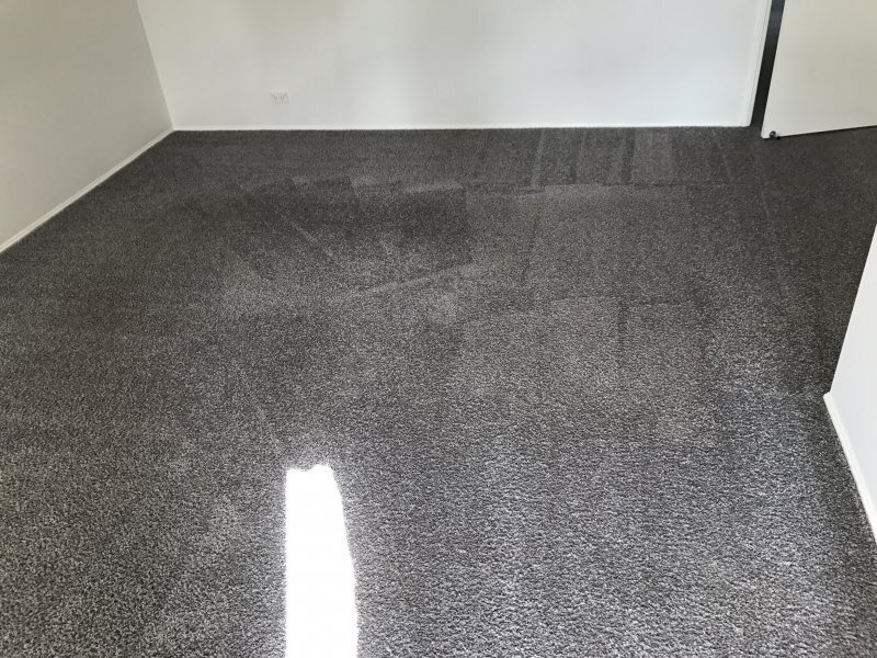

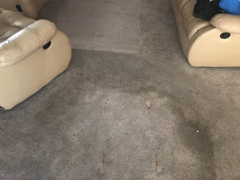

Ok. So the job where I've had to do a secondary visit early last week. The top two photos are from the first clean, immediately after cleaning.
The third and last photo is immediately after the second clean. There is essentially no improvement or difference in appearance less pile alignment from the wand. Both times was vacuumed, scrubbed and wanded.

Have you given the stain stick a go Phil. I think that will shift a little more.
