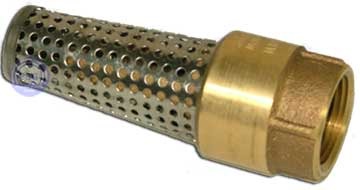

pending on what size hose he has...put a hose barb at the end and screw in a foot valve...this type will filter and only allow the water to be sucked in and not siphon backwards and empty the line.....
Doesnt Judson use those as vacuum relief valves?
D
dgardner
The one Jim showed is designed to go at the bottom of a well or sump, to prevent the water from emptying out of the vertical line up to the pump and losing prime. In our case it would go inside the fresh tank, with the pump inlet connected to the threaded end. The same thing is available with threaded connections on both ends if one wanted to install it inline.
