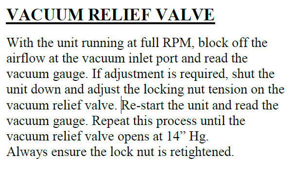

From the SS570 manual:

You are leaving a lot of performance at your machine, get that relief valve set at 14 and you should have some killer vac!

Agreed. According to the manual should check this every 100 hours and adjust if needed.

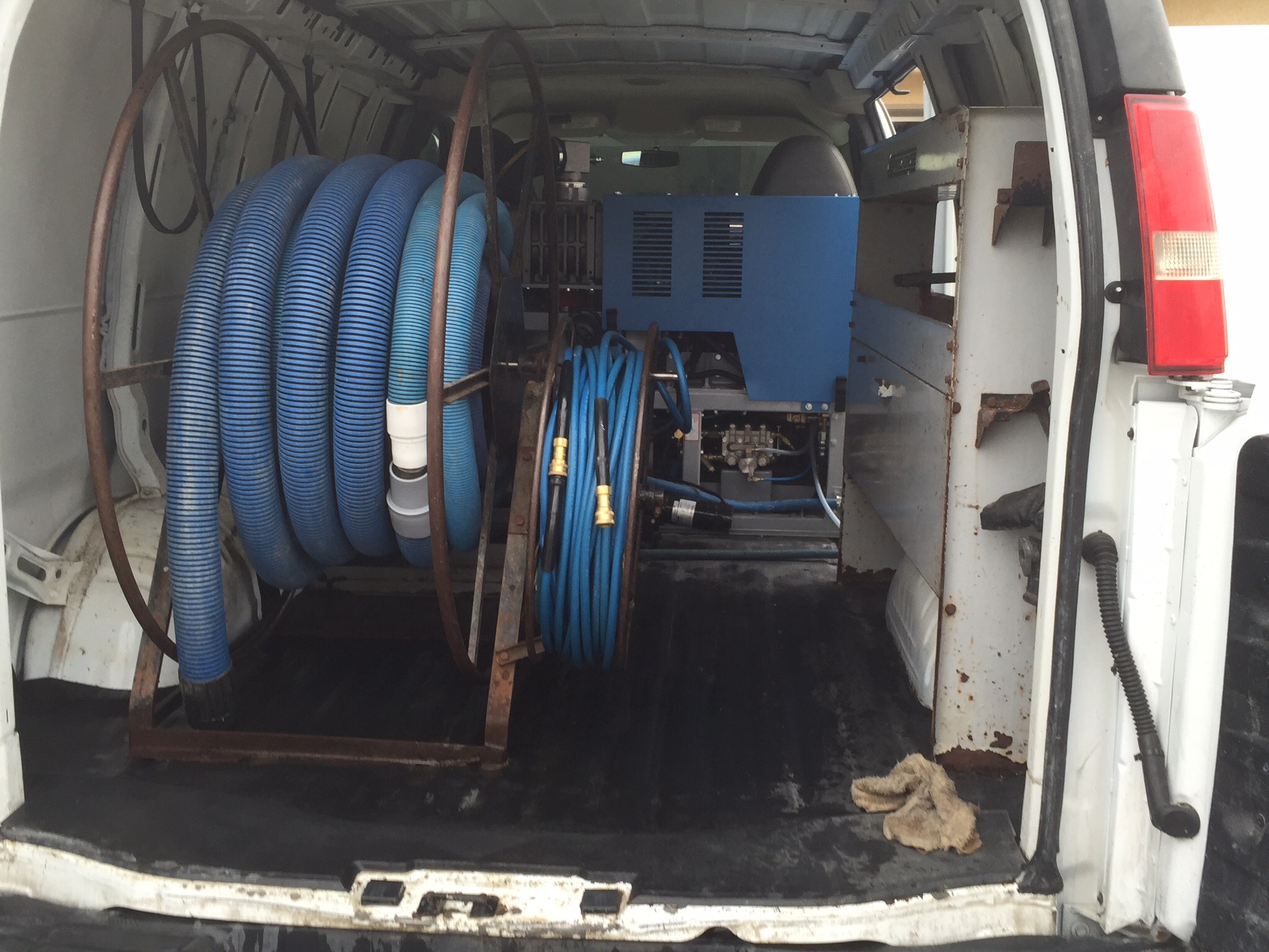

I'd have a hard time driving around with the inside of that van looking the way it does. I'm amazed that you can spend so much on a van and machine and beat the shit out of it.

Ya posting pics is a biotch and I'm not gonna lie that Van is beat up with only 35k miles in it neesds repairs on both side where my son bumped things and the interior needs a major scrub out, after Xmas we might slow down I'll pull everything out and scrub it down. I really need a new chem rack and hose real they're 12 years old and shot.
