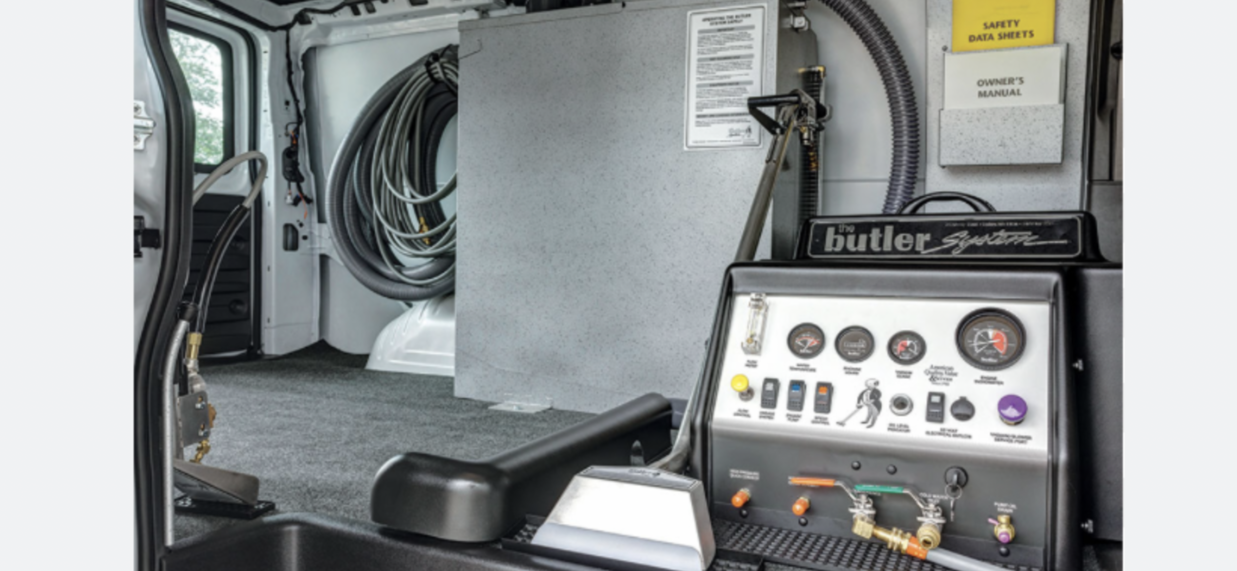

Depending on your budget, I would go with a Butler. You don't necessarily need a carpet cleaning service depot near by. Many pressure washing and small engine companies will service slide in truck mounts.
Butler isn't a slide in doah...you know that already
28,260
I'm saying, if he has the budget, rather than a slide in, a Butler would be the way to go. Simple, reliable, hot and powerful. Butler does some modifications to make the van run cooler. New system can run $80,000-$100,000 depending on options, including the van. At times, Butler has some reconditioned units available.

I decided to post this on here versus *** because there’s a lot of older veterans on here and most of you have tons of valuable knowledge.
We’re moving from Southern California to Coastal Delaware as I’m originally from New Jersey and all my family is there now and aging. I am considering starting up a company there.
The negative is there isn’t a service center anywhere near (2hrs away) and while I am fairly mechanically inclined I don’t do any major work, so wanted to ask you guys what your thoughts of the absolute most reliable easiest to work on truck mount there is?
I am a 30 year vet age 54 and I’ve had the Prochem legend SE (tons of problems) Prochem Apex (some issues ) now the Hydramaster titan 575
I’m seriously considering the Butler system would love to hear from any of you guys about it I know it’s more of an East Coast thing, but looks really simple to work on. They seem extremely reliable. What’s your thoughts?
Many thanks
I've never owned a Butler, but I've heard nothing but good about them. If you're looking at slide-in units I'd highly recommend you checkout and speak with SteamAction. I was skeptical at first of their units, but once I saw one in person it completely changed my mind. Loads of heat, vacuum, and very simple to work on. It would definitely be worth giving them a call and having a conversation.

i have a butler and 2 hydramaster cds out everyday
the butler seems way easier to work on and is a great setup
the cds is awesome and I prefer it but my vans have had a lot of issues the last couple years
one of them has 150k miles and 5k hours and was flawless till about a year ago and its hard to keep on the road now it just seems like something is always off or its running hot or leaking
my butler is great only have had a radiator issue and clutch fan but cleans strong everyday
if I were to buy myself a van today I would buy myself the CDS 4.8 SV its blower is bigger now and if its not employee ran I think it would last a lifetime
I dont like how the butler looks or is laid out I dont like how the pressure guage only works while using the wand or tool I also dont like how the injection system works
and I would rather have the center console on the cds
the cds is way more room and looks way better
you can have enough room for all the vlm crap we are pushing these days and whatever else you want
