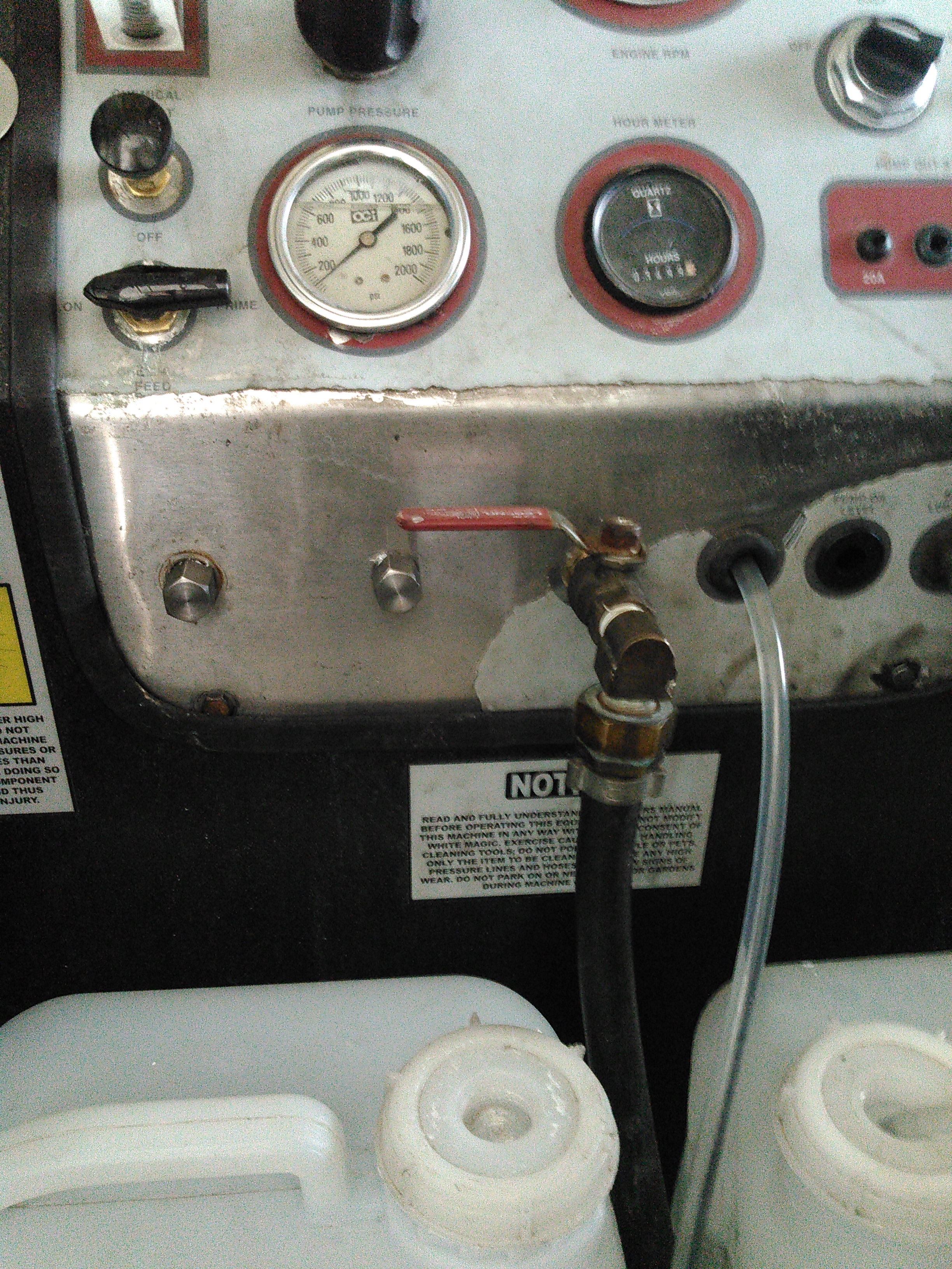

Not yet but my auxillary solution fitting was leaking and when I took it apart all three nipple were broke. It would've blasted me in the chest had they blown.
I capped them off instead of putting the qd back on.
