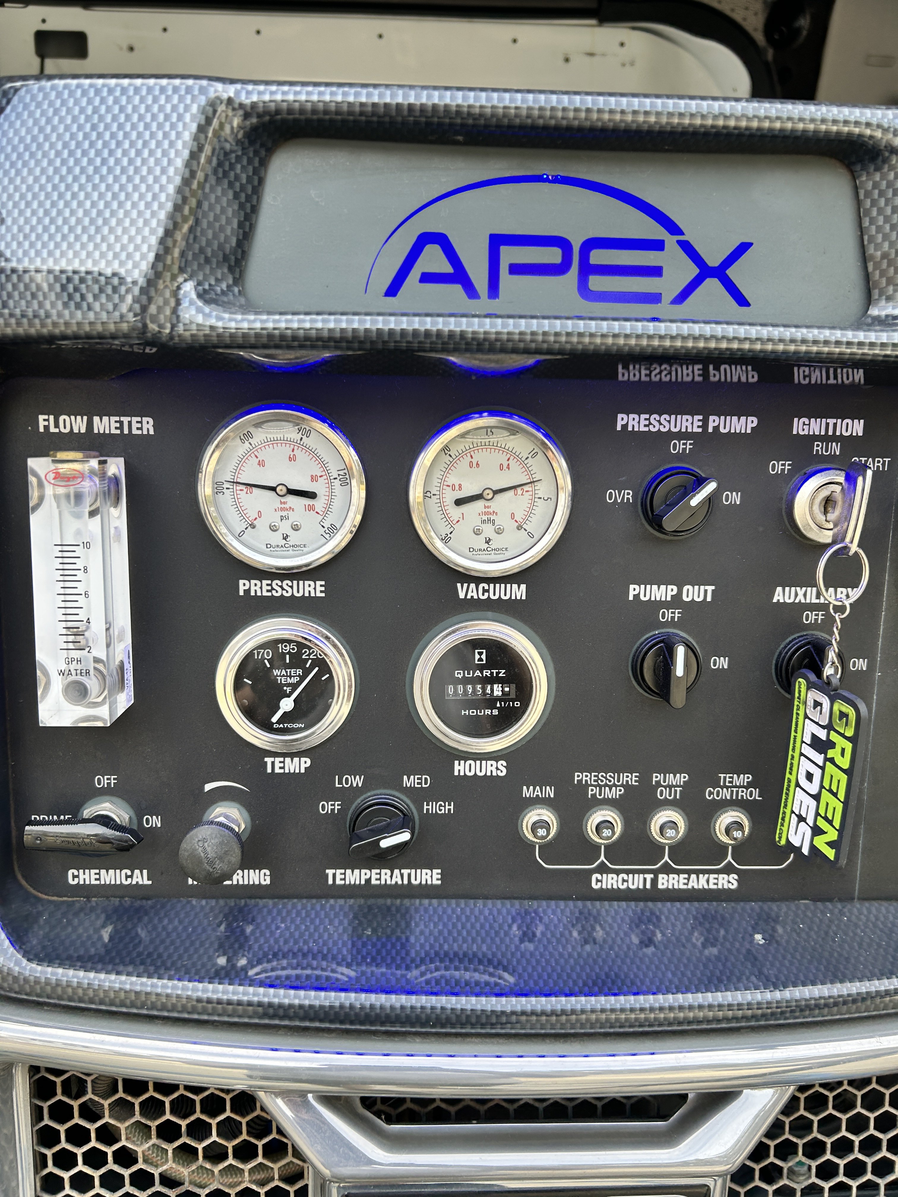

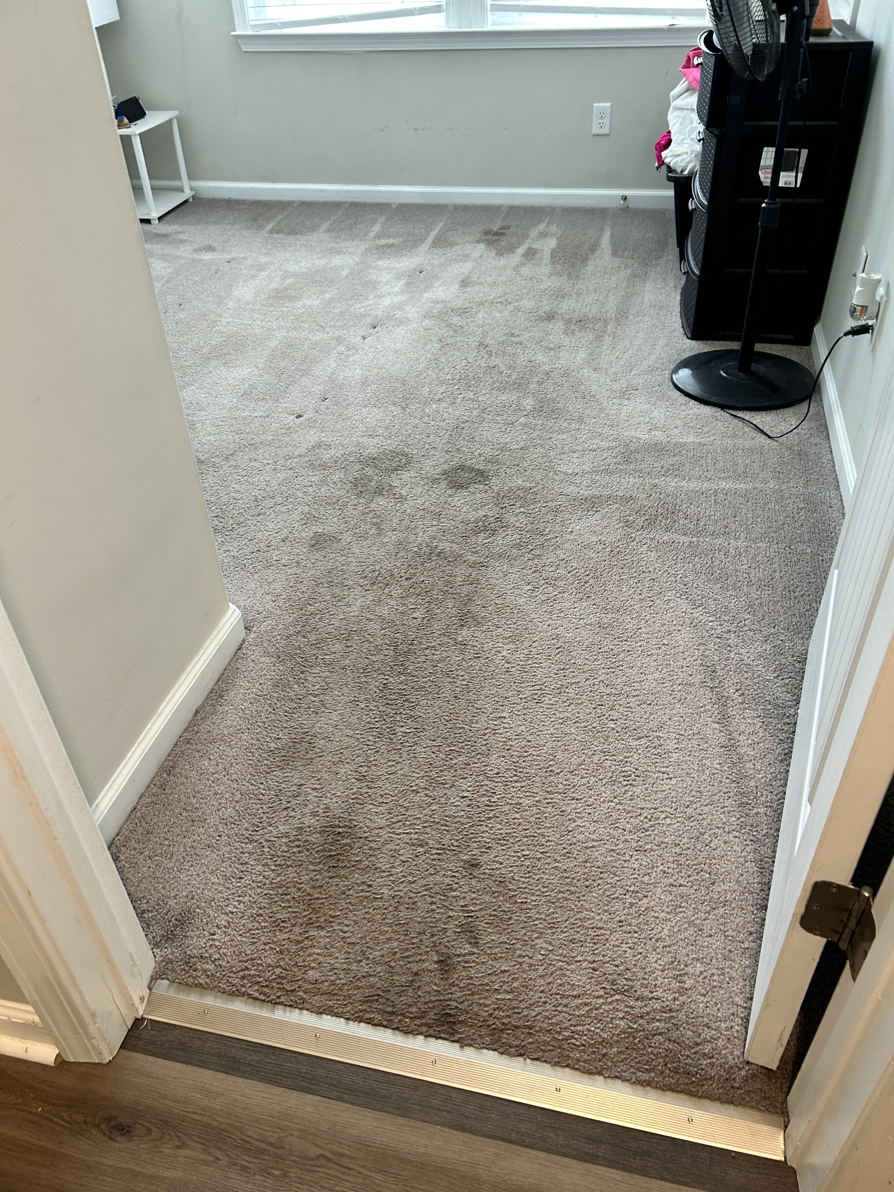

My urine removal process. I don’t have a device that measures urine so I don’t to crazy with the process.
1. Vacuum. A shark vacuum is very easy to clean. I can do it with the whip hose from my truck mount. It dries on the way to the next job.
2. Set truck mount to lowest psi and highest heat. Chemical feed on 3-4. Dry Slury HWE only. No expensive pre treatments that work only 50%of the time.

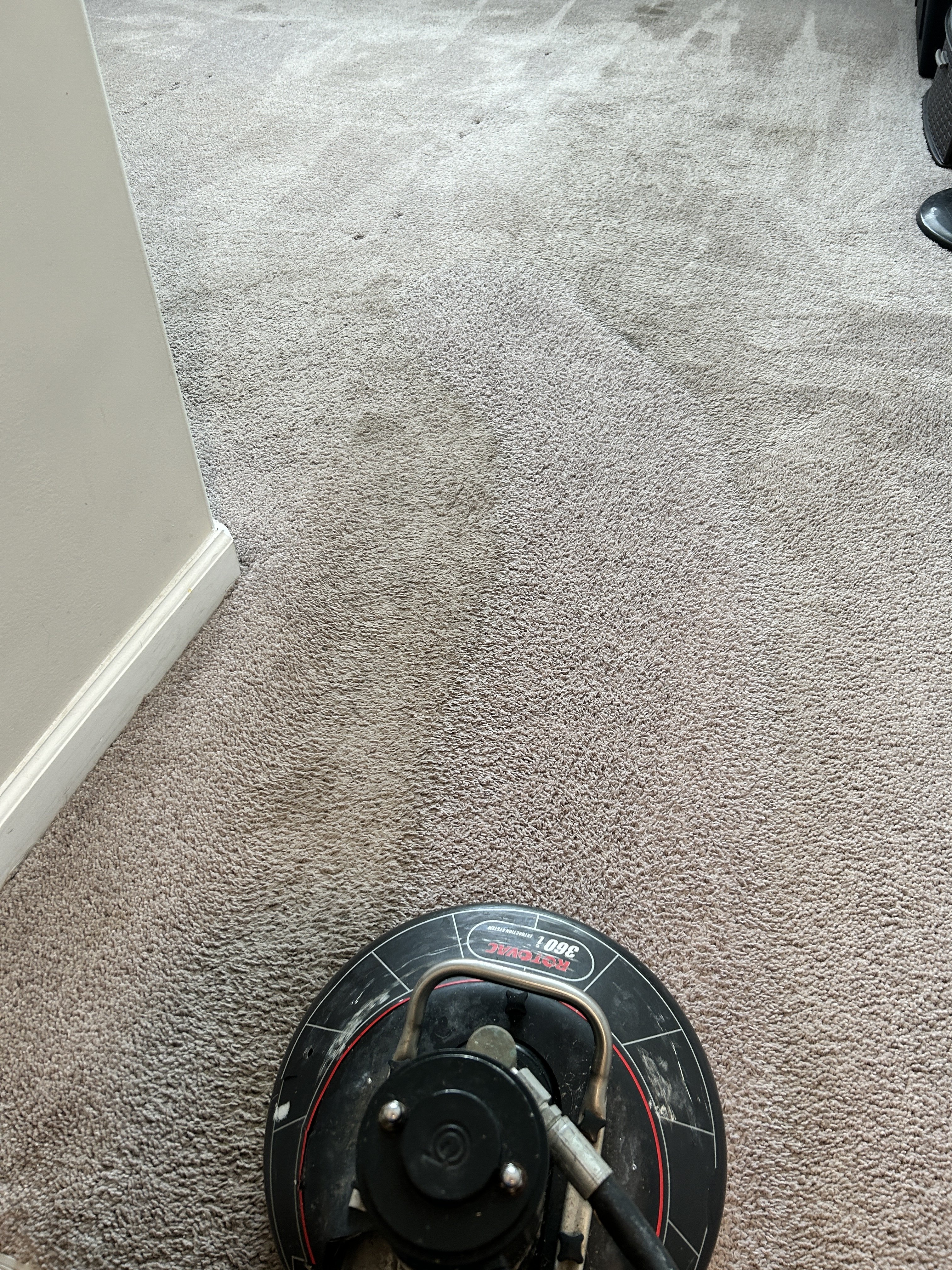

Rotovac in.

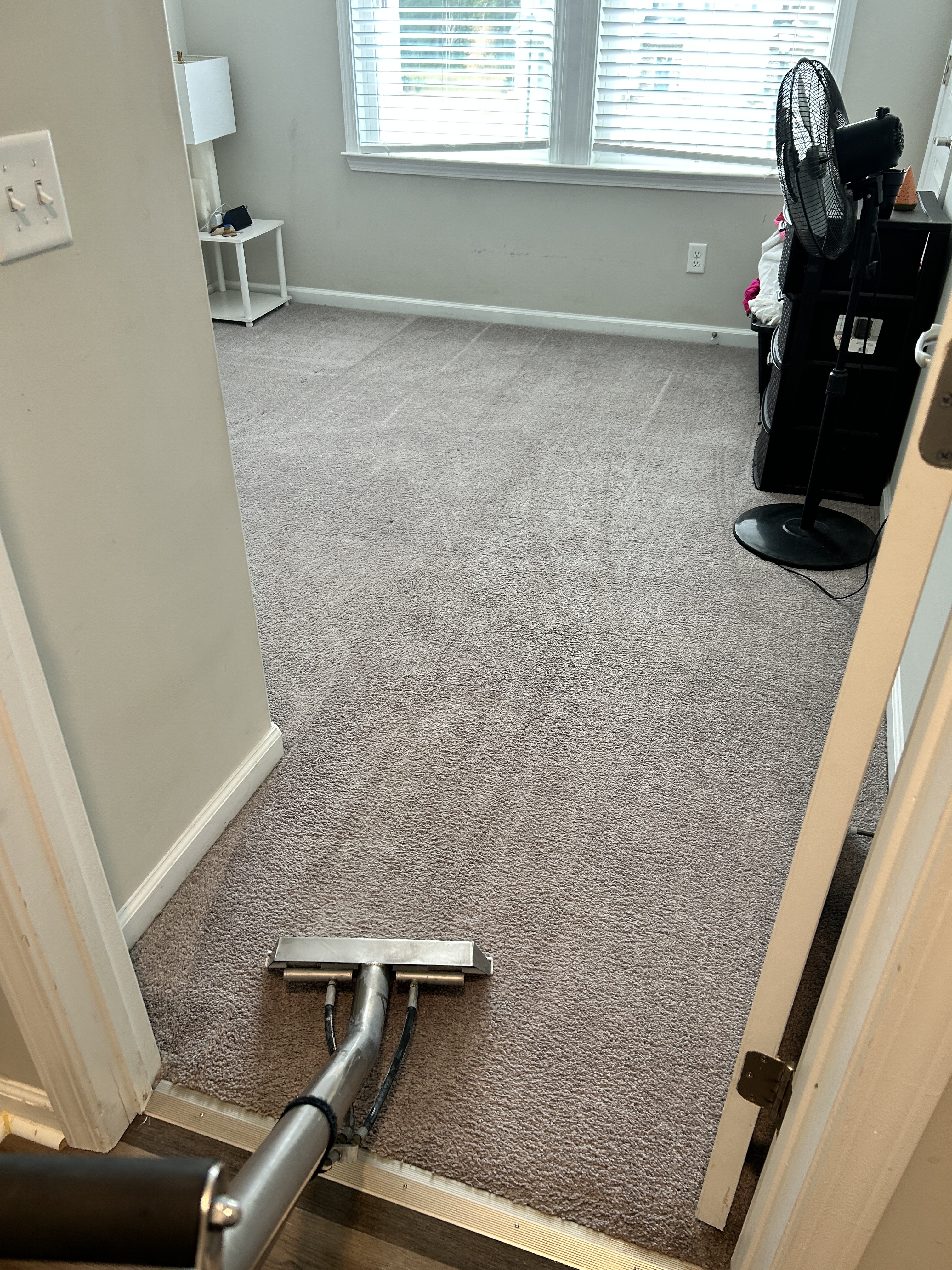

IMG_0763.jpeg3. Wand out with same truck mount setting.
1 wet/4 dry (2 complete dry strokes front to back).
This job was a 3 bedroom only townhome. Took 1 hour 12 minutes from arrival to departure. I charged $215.

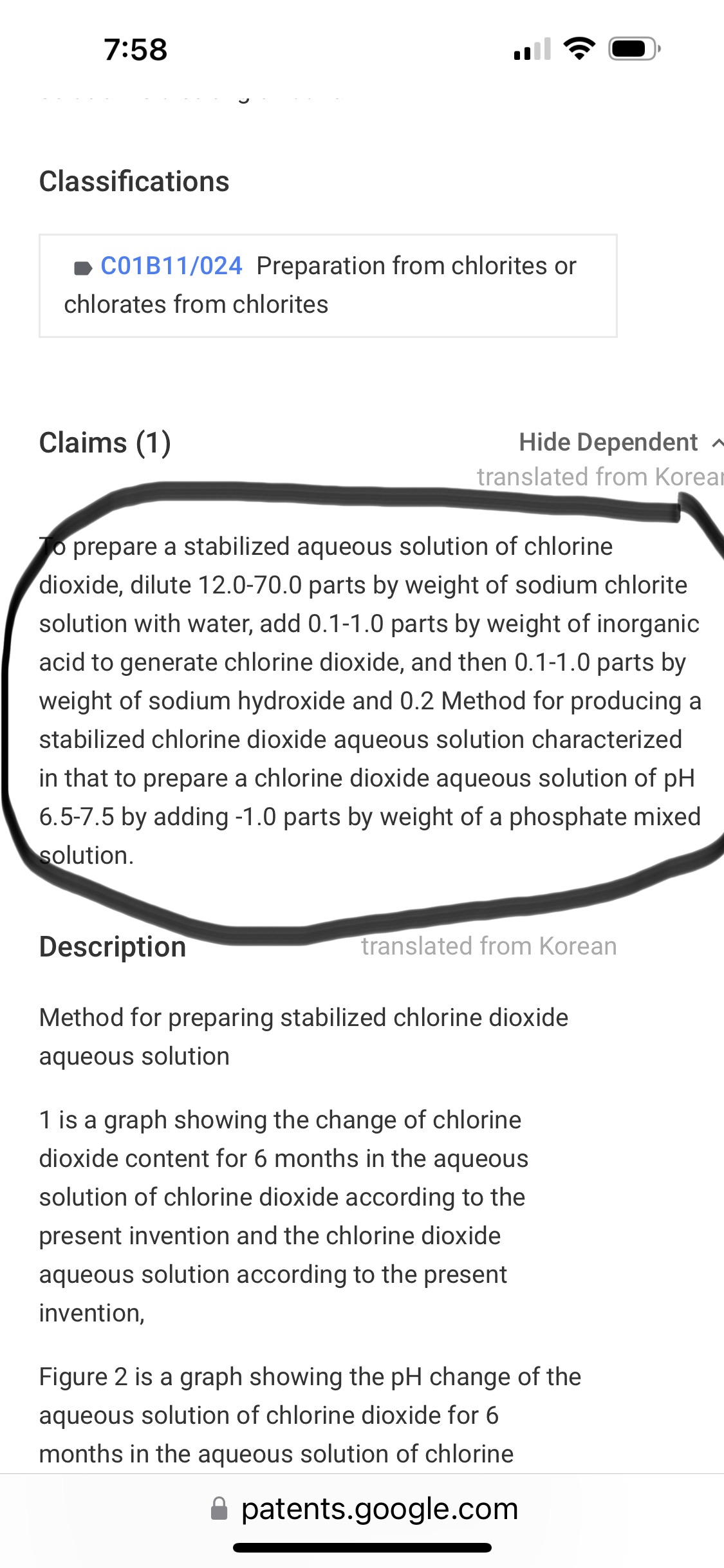

Be careful mixing sodium chlorite (CLO2 products) with peroxide. The duo can cause nasty bleaching.
Also, sodium chlorite doesn’t actually convert to a mild CLO2 until it’s acidic and it doesn’t take much.
For urine deposits, I mix sodium chlorite with PCP and add a pinch of Prochem acid rinse to barely get the solution to the acidic side.
That solution annihilates urine.
The sellers of the so-called “stabilized CLO2” products don’t mention this because they don’t want people going too crazy on the acid side. The problem is those products are absolutely not CLO2 unless acidic.
You could also mix your CLO2 product with Silver Solution since SS is just acidic enough to convert the sodium chlorite to CLO2.
