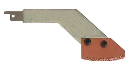

So how do you cut the bad grout out?
I've used chisels when lots or all of the area need to come out, lightly tapping. There is a nice grout drill bit for a dremel tool that works well close to tiles. It's not super fast, but can work.

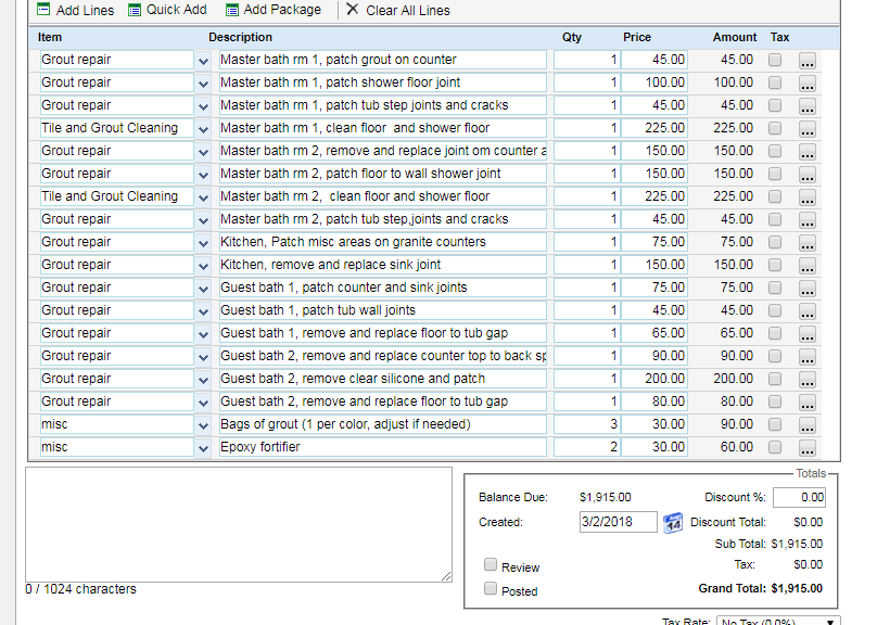

I was going to ask "$18k?..fo-reel
grout saw
need a short stroke sawzall with variable speed for best control
(like smaller Bosch, Millwaukie and Ridged )
otherwise, too easy to bugger up tile edges with large and long stroke saws

18k?
