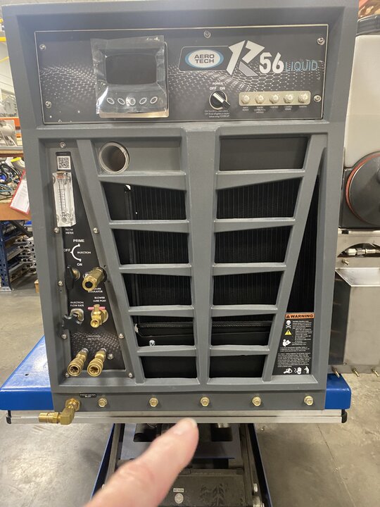

The information is too small to read on my phone. Are the frame, tanks AND REELS stainless?
The frame and main brackets are stainless also the heat exchangers are stainless tube and shell like the XT and DDS. The heat shields are chemical treated brushed aluminum so you can touch them up with steel wool and keep them pretty. The vacuum reel is aluminum and the solution reels are stainless.
Even though we have our own paint shop we choose not to powder coat as that never lasts. The front panel is a bit of a dated look but it is growing on me. We are going to add some stainless bling to the grill and help finish out the look.

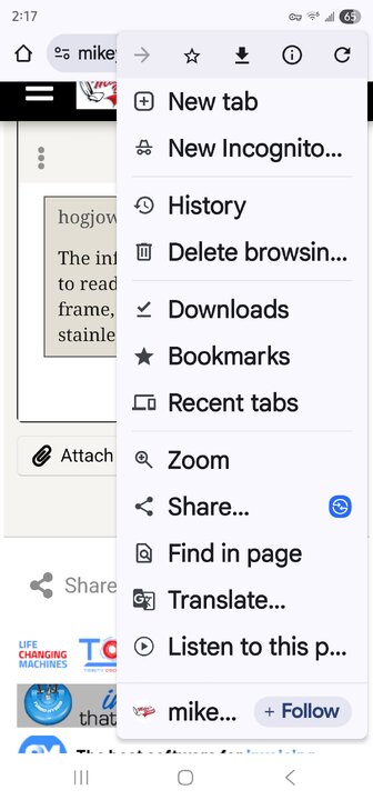

Try the zoom feature.

Wow, that thing already looks outdated. Does it come with a Members Only jacket?
Paint that thing blue, and you got an old hydra-cat or crossfire hydra master, lol
But on a serious note:
Yes it looks like it has easy access to change oil and maybe the belts
But keep in mind that's only a very small percentage of the type of maintenance and repair these machines need. I think it's going through some competition.
It looks like it's trying to compete both with steam-action's design of stainless steel and trying to give it the high tech design of sapphire truckmounts.
I can't get over the fact that it is not very easy to access every part of the machine from the pictures shown. If I'm wrong, bring one over to my city and let's take the thing apart to get the needed access to all the major points of the machine, put it back together and do a successful hour long test of the machine. I don't care if you want to show off the performance of how it cleans in a 3 bedroom apartment. Every truckount does a good job at that, even an EZ truckmount. Ease of access on the job and maintenance to get it back up again is the only important factor!
I keep every tool needed on my Truck to do all popular repairs on the job. Very few I have to leave and go pick up my spare machine. So meet me to the challenge and let's record it. I laugh at chemdry being the tester. Bring it to a real owner operator who takes this business seriously.

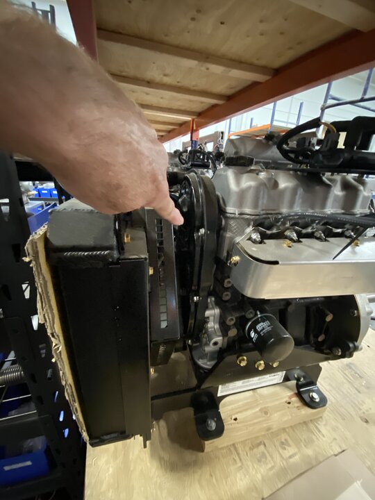

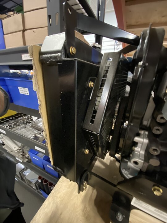

Does that PSI engine have a timing belt or timing chain?
To remove the panel there are bolts that hold the along the bottom and sides. Notice that the plumbing section of the panel will stay in place. Then you remove the bolts that hold the radiator in place then the radiator will swing out and away. Now you remove the bolts holding the cover of the timing belt. Wayne has tested the time it takes for this process and said it’s a two to three hour job. All accessible from the front.
The thing with PSI is that they are not the engine manufacturers. They take the engine blocks and build out the engines from there. This particular engine is a GM engine. The way Wayne explained it to me is that if the belts do fail it will not damage the valves the way this is designed.

2-3hr job is normal for a replacement. I like that they used a GM engine and the heat shield over the manifold has improved since my psi GM model engine was made.
I like that it's all accessible to the front since the basket filter and tank are on the right side. I was wondering how easy it was to remove that if it was needed access from that side.
Thanks for showing us up close access to it.
Is there any future talk about shifting over into Kubota with a timing chain for less of a need to open up that area of the engine once the first run of these machines is sold?

I believe that would be called a non-interference engine.. Which would be an awesome thing..
