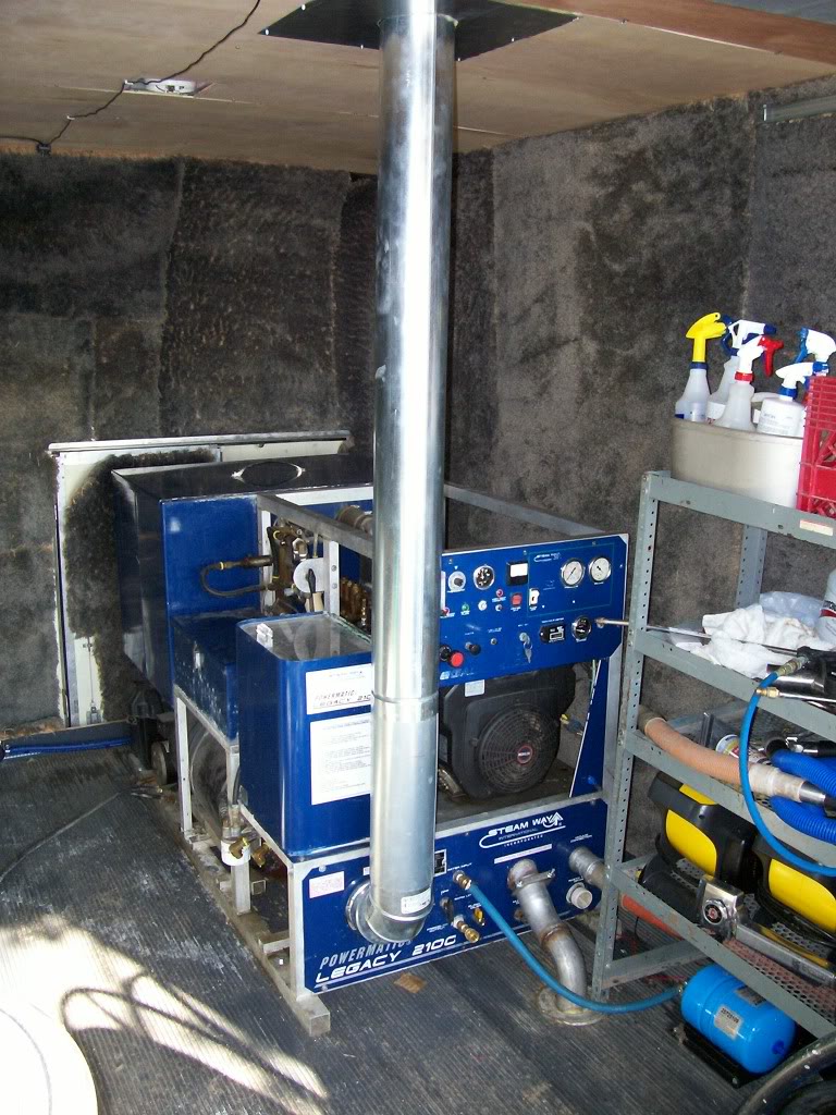

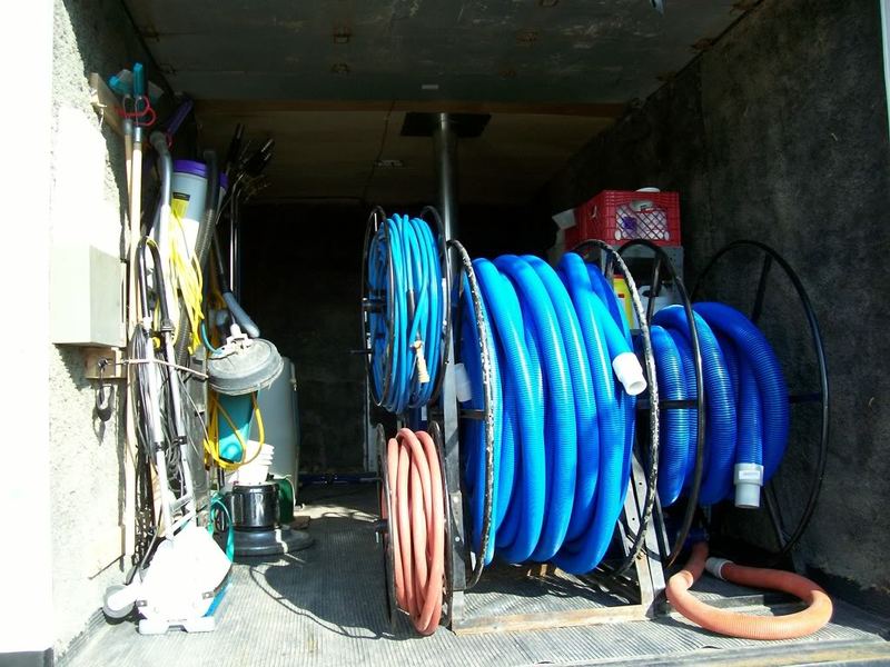

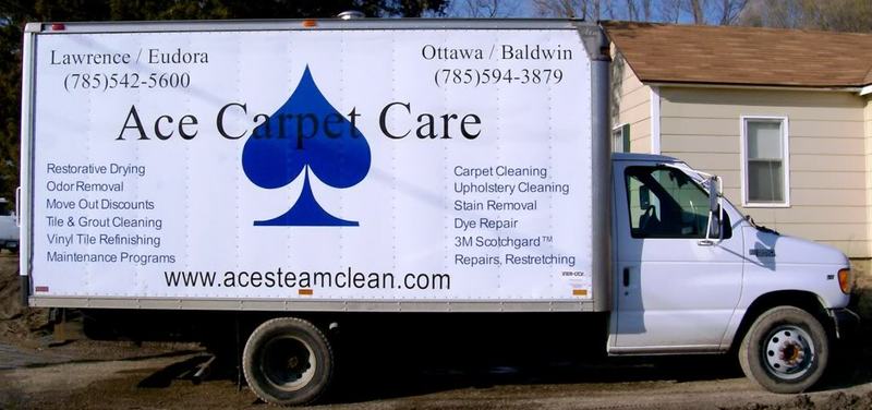

Here are some photos of my new rig (new to me). I have spent around $7,500.00 for what you see including the vinyl.

I like the stripper pole :wink: Box trucks are the way to go if you want to carry it all and stand up in your truck. Congrats.

2 Questions, what's the little blue tank for under the shelf? and is that a little role up door behind the TM?
Boy, I would have had to clean the tires before I took that picture.

Should have centered the TM it will keep your shocks and stuff from leaning to one side
That’s Part of the pump that transfers water from the fresh water tank to the machine.
Yes there is an Access door to the cab

280,000 BTU Kerosene Heater.
It’s hard to see but, there is a 125 Gal fresh water tank that sits opposite to the machine. In retrospect I do wish I had the weight centered over the rear axel.

you forgot to groom your walls.
I spent allot of extra time trying to insulate the walls. I installed 1” foarm under the plywood then the Shag carpet. This was my first attempt at dyeing wall to wall carpet. The dye only penetrated 1 1/4 “ down the 2 ½ shag. I might try again and apply the dye with a stair tool at a higher PSI.

Looks good, you can see it from a block away!
The box is a good idea for hauling everything you need and repairs are much easier. The gas sucks but usually it out weights the positives of having the box.

man, look at that electrolysis going on on your water box.
I had that unit for a few months.
I wouldn't wish that thing on Rob Allen.
Now I know what you think of me! :p
My guess is you couldn't stand the HEAT! :wink:
For those who don't know, I bought Mikey's Powermatic, electrolysis in the 7 year old water box included at no extra charge. :lol:

Mike, you did GREAT on a 1500 hour machine for $1500
Now do yourself a favor and change the POS heater flow switch to an aftermarket flow switch.
Buy it from Jeff at Steamway Express
(he's a great guy to deal with and knows his chit)
http://www.steamwayexpress-ohio.com/
It's a direct replacement and will take 20 minutes to change
burn kero in that bumer too ...you have much less problems
BTW, it's a 231,000 BTU burner
and will sustain 250 degrees @ 2.1 GPM
You got that right Larry!! The meathead I was bringing my machine to for service put a ST-6 or something like that.. worked about 10 times, seriously, and that was it!! Kept giving me one lame excuse after the other about why it wasn't working.
Called Jeff @ Steam Way Express, sent me the aftermarket switch he carries took about 20-25 minutes mainly because of the cramped quarters in the back of my van. Doesn't look like Mike with have that problem. Anyway, since putting in Jeff's switch she's been roaring ever since with no problems. Jeff's a great resource.. a little chit chatty sometimes but that's because he really wants to educate, you the customer, from start to finish. I wish more were like him.
I've got to give Larry a huge THANK YOU too. He's helped me out a ton with little things, a lot of them embarrassingly enough were operator error because I'm not extremely mechanically inclined and very green but, he really help me and my blood pressure immensely.

Like Larry said, install a better flow switch.
