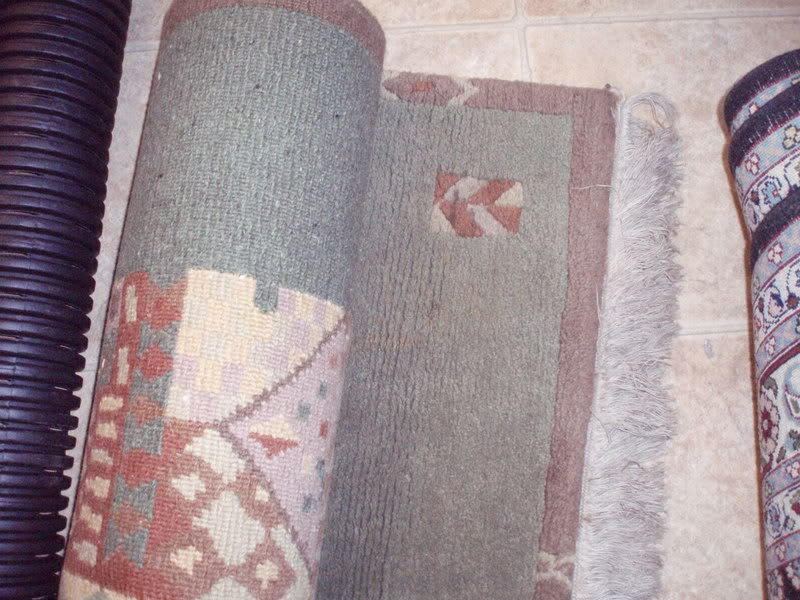

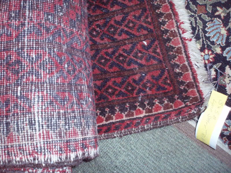

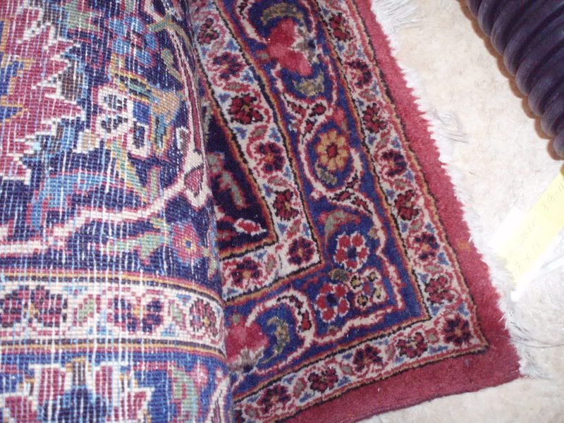

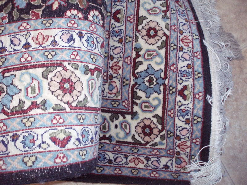

Belonged to the clients grand mother. she claims it is over 100 years old. Measures 18 x 15. Many cleaning tags on the back. No sing of die movement or loss. Lots of bare knots in TA's.
Five year old rug they brought back from Turkey.
Lightly soiled. I was surprised at how stiff the rug is. I guess it's first cleaning will get it to "chilax"..
Very worn all over, No known history.
Plain Jane?
lets hear it.
Thanks.

1 Kashan 1950-1960’s should wash fine
2 Hereke modern black and green are sometimes a bleeding issue
3 Beluchi rug from Iran a little red bleeding the wash
4 Nepalese (Tibetan) rug should wash fine ..heavy fringe browning particularly if it has looped fringe on the other ends

What you'll learn from a rug ID course is why these are what they are. Randy's very likely right about each, but I'll offer a couple of clarification questions:
The second rug could be a modern interpretation of this style made in Pakistan, India, China or even Turkey. What is the identifier that makes it a Hereki?
The fourth rug is made in the style of Nepal, but it has a soft wool look and evidence of a bleach wash that would make me think it an Indian copy. What identifies manufacture in Nepal?
PS: The third rug should be repaired ASAP before it loses more nap. If you don't offer this service partner with someone that does.

#3 could be a bleeder. The fringe is not very visible in the picture. Actually, the first three could bleed depending on what has been done to them by the customer. So never assume a particular rug is okay because you have cleaned one that looks like it before.
In fact, Bryan makes a good point. Be sure you have identified the rugs you clean correctly. In 2009, a Kazak can be made in China, a Heriz can be made in India, and a Bakhtiari can be made in Pakistan. I see these exact examples all the time. Don't rely on a pattern. This will get you into trouble quick.

It’s a Turkish Hereke you can even see the double edge at the bottom of the pic if it was Indian it would have better colors single edge, if it was Chinese it would have better colors and a more uniform & thicker salvage, colors and salvage are wrong for a Pakistani too. The Tibetan refugee rugs from northern India have a couple peculiar traits most don’t employ a split shed weave causing the knots the to be elongated taller than they are wide and the N.Indian rugs use machine spun wool. I think you need to get back in the wash pit!
If I had to choose between ID the rug or pretesting I’d take pretesting. I use the heavy duty paper towels you can get them at lows/home depot in the pain center they come in a big square box. That said I don’t test rugs very often or use dye loc.
Thanks Randy, the why is important in rug ID, as so many rugs look similar and copies are made all over. Even older Persian rugs can be confusing, as the makers in one valley would alter their designs if the the rugs made in the next valley were selling better. Rug experts might stand around a rug arguing opinions of origin based on what characteristic they think is most important.
