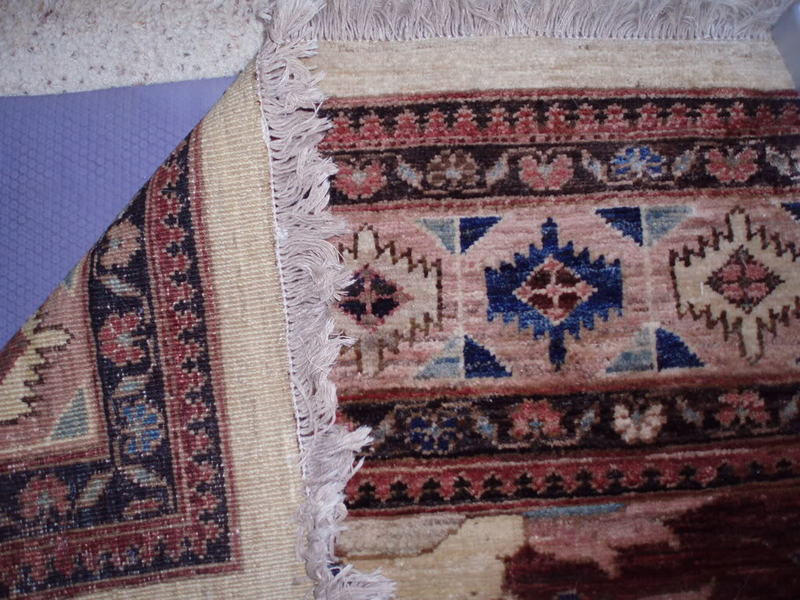

Got a few more..
( how long will this thread go?)

OK, Mikey
1. Probably Pakistan but much of the new stuff is being made in Afghanistan…. it looks like an a rug made by art resource. Colors, design, heavy chemical wash wet a corner it should feel slimy and smell like chemicals or vomit. These can be problem bleeders and a weird slurry of shit usually comes out of these in a wash

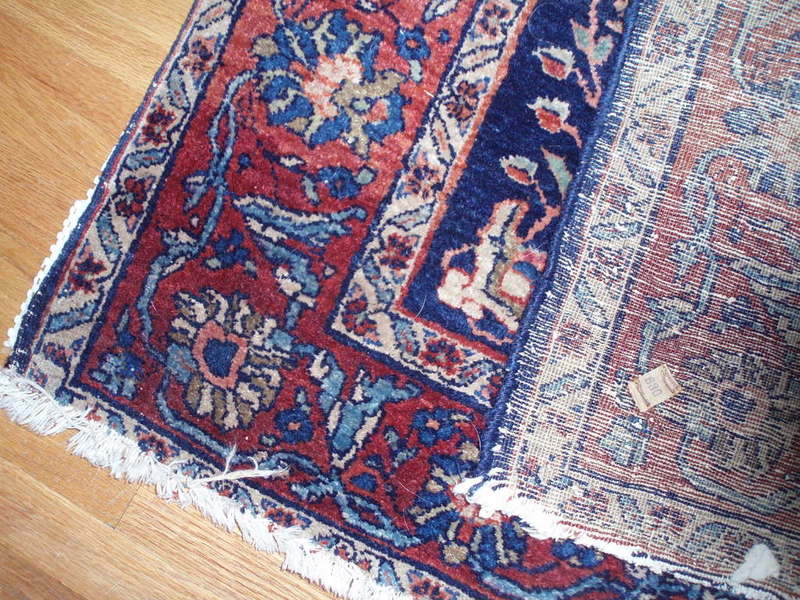

2. Sarouk is the quick answer although some are not actually Sarouk. Colors weave, design. Should wash fine dry rot is sometimes an issue be very careful when handling wet

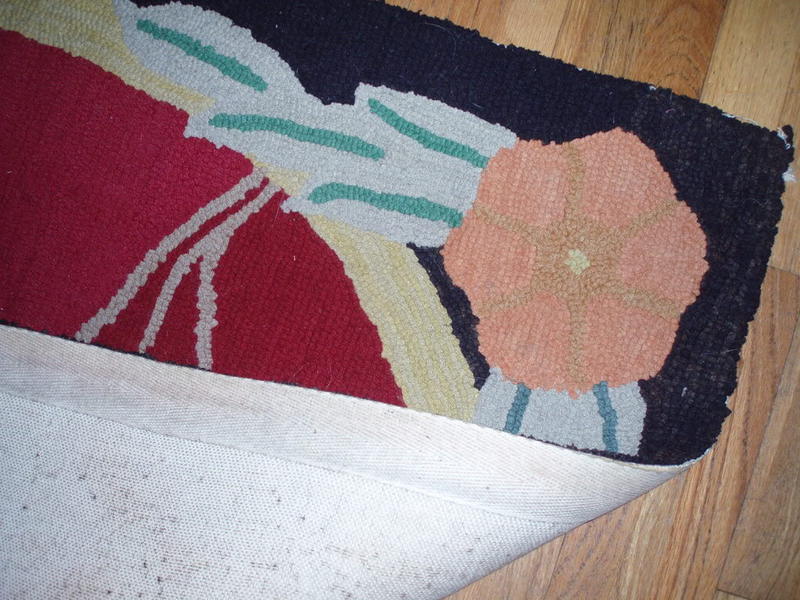

3. Hooked rug. If the binding on the side is a glued on separate piece of material it’s Indian. Cinese if folded over usually hand sewn sometimes glued One way to tell a tufted rug is from China or India.

Hooked rug. If the binding on the side is a glued on separate piece of material it’s Indian. Chinese if folded over usually hand sewn sometimes glued One way to tell a tufted rug is from China or India.
I sort of put that hooked up as a joke but damn if I didn't learn something to impress Mrs Piftleton.

Mikey I test my product first with hot water and a white cotton towel. See If there is bleed. Bleding can occur not only in the cleaning process but in the drying process as well. I am sure that you will be calling many of these fine gentlemen here when an occasion occurs. Trust me I do. Just like Jose also said I worked numerous hours on rugs that were not my fault . The client does not understand that so the fault could be yours. That is why I have my mentors. And I do thank them they know who they are. So get your mentors ready. You'll need it.
