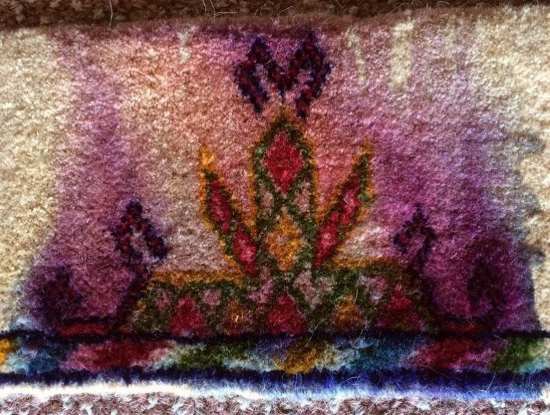

When fabrics bleed in this way, the color damage throughout the natural fiber fabric's yarns is such that its unlikely that this would be a rewarding effort.
I'm not saying this to contradict your knowledge of chemistry and stains, which I respect. Its just that I don't want readers to think they can bleed things with impunity and then be able to fix it.
Should someone encounter very localized bleeding, say from spotting efforts, it would be an interesting test to see if these products would work well on rayon, cotton, or silk, which are the usual bad actors when it comes to colorfastness issues in upholstery.

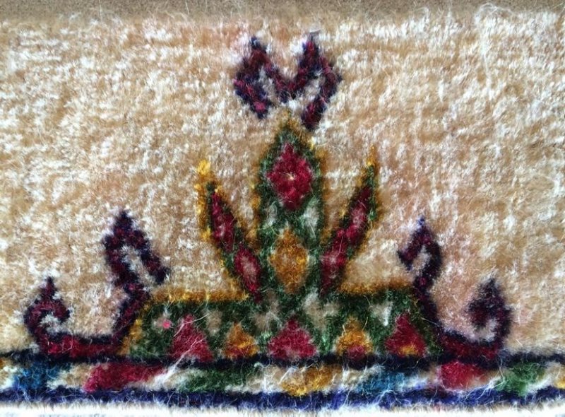

Why don't Larry send miracle product to Jim to try on photographed cushion and provide pictures. Including comparison to the base unit.

I would be happy to conduct such experiments, or to send fabrics to Larry if he'd prefer to, since he has the best understanding of his products and their use
As Ron mentioned, in small, localized areas such correction might make sense. The challenge in large areas is the time involved, as well as the nature of jacquard weaves. The red that you see in the picture above has come through from the back. Where I've had the most challenge when I've corrected these is where you need to remove the red next to the raised yarns that create the pattern, and that contains other colors. In a tufted carpet or rug, is a bit easier to control with shims.
But in a woven fabric, the reducing agent migrates along the yarns that run both over and underneath the pattern, and invariably the reducing agent migrates into these areas and removes the other dyes as well.
With prints or needlepoint it works if you are very careful, and also on area rugs. With jacquard upholstery fabrics, even when I've used a hypodermic needle to apply small drops of reducer, I could not control the migration of the reducer through the yarns and into the adjacent colors.
That said, if there is something in Larry's formulations that can work around this issue, I'm all for learning about it and spreading the word to help others.

Larry, I'd love to correct the damage if it happens. I'd also like to know what are the chances of success and potential damage, how it will effect other adjacent colors as well as potential changes to the base color, before I go through a time consuming process.
The experiment will be interesting on the damaged piece, but will be even more helpful if we can see what it looks like in comparison to an untreated piece.
As the client is not likely to be satisfied if the entire cushion turns out to be a different or lighter color.
This is one of the problems we run into even in correcting browning. Much of this also depends on the mercy of the customer and whether or not they like or resent you at that point.
