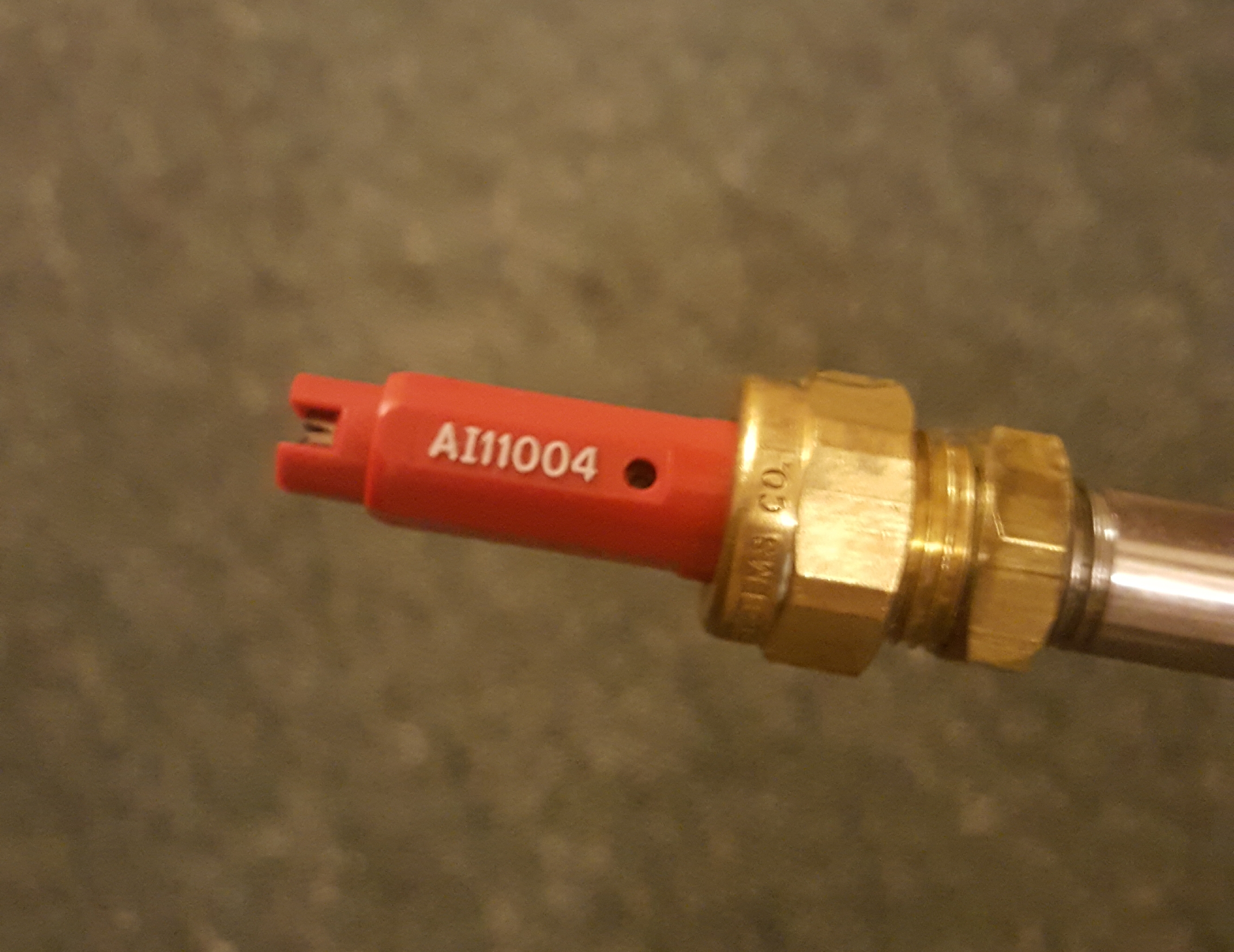

teejet is a brand and make both threaded and capped and a 1000 others in between primarily for the horticulture industry.
My air induction teejet on hydroforce sprayer, puts out slightly less than original but being air induction it cuts the fines and gives better coverage. Being plastic and $40 each not for careless techs
