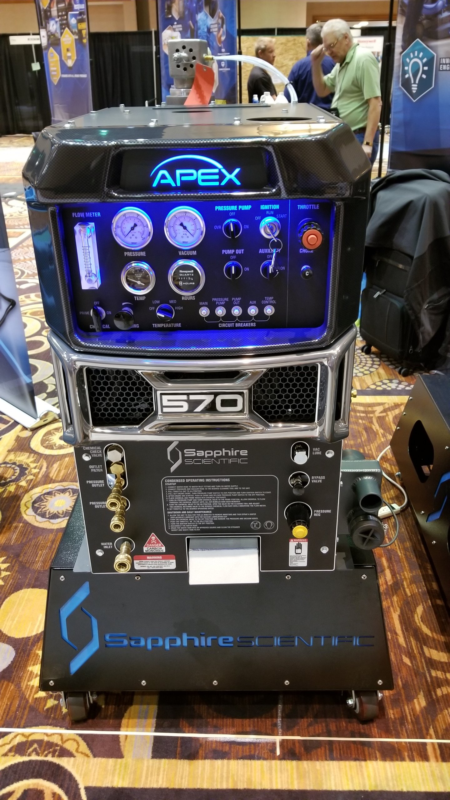

the Prochem Apex is on its way out. I heard that the Apex will be under the SS name now (see Sunbelt catalog) in a month or so. Not sure what motor or changes they made, but to me its a new machine and since Im looking to get a new one, Im not going to be a Guinea pig on a new model
Apex in a 570's new clothes..

yep, that's the one. PRRRRRETY machine but still a new model. that and the fact that SS doesn't have the greatest track record/history
Ill stick with a new Hydramaster Titan 575
