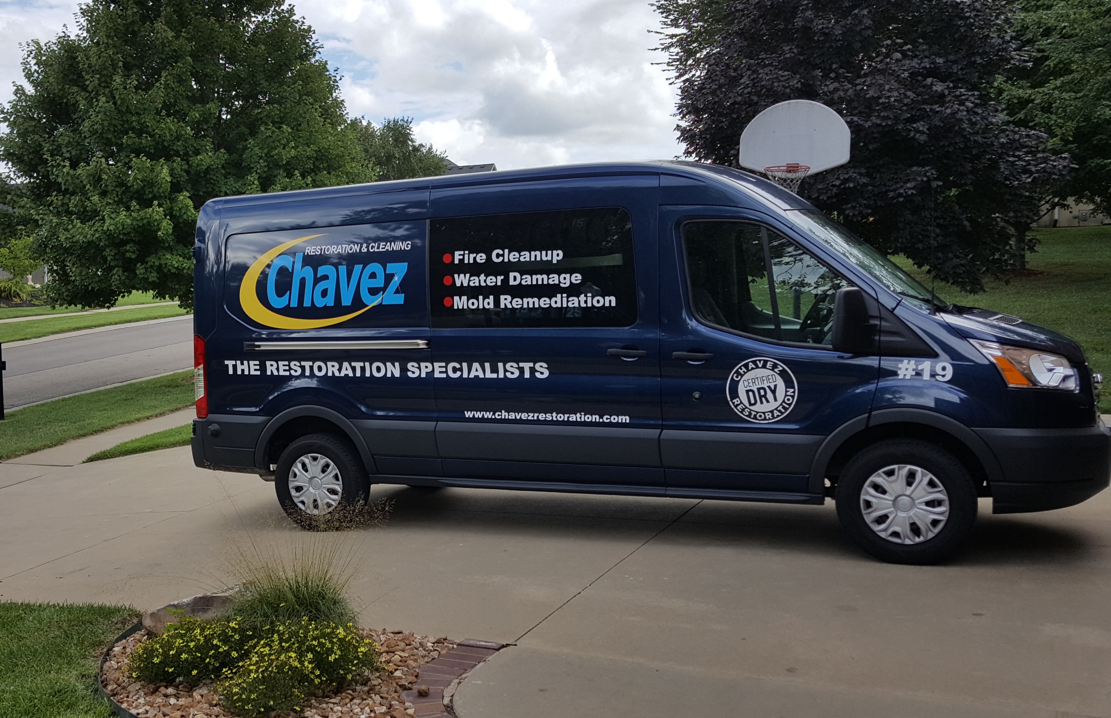

Not sure. We don't have hills like you do. The turbo boost sure has the power though. Reminds me of the old powerstroke diesel we used to have. She takes off and push you to the back of the seat.

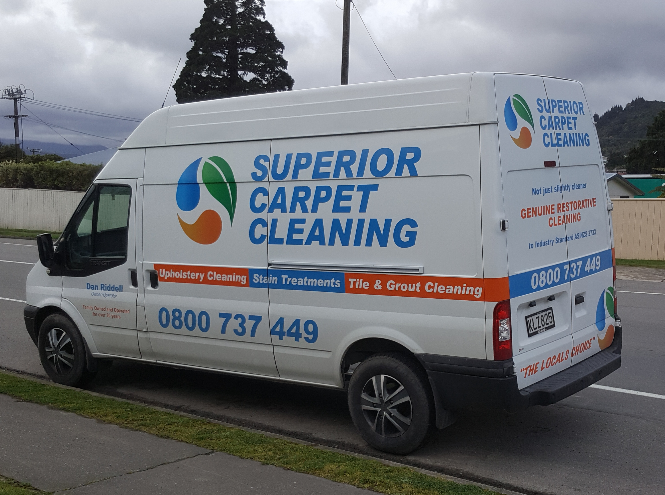

We only get transits in diesel, love my 2.2 turbo diesel ton of torque drives suprisingly well for a large van... its in the panel shop lol :redface:
Reactions: Mike Pailliotet
Hack Attack
Dec 19, 2017
5,620
Dan
Do you get the lower roof heights? Like under 6' 6"?
Yeah from what I've seen we get the same body shapes as you but ours are all diesel, current engine is 2.2 turbo in either 130hp 150hp or 180hp all with 6 spd box. I've got the 150hp I'll chip it to 180hp once the warrenty is done more for kicks n giggles than necessity :biggrin:
28,282
I think the lowest one we have in North America is 7 ft. I have seen the diesel versions in the UK under 6'6". Great for getting into parkades.
