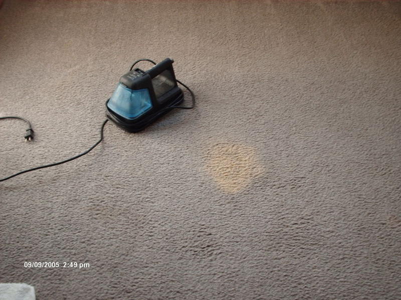

I found that I was not getting up as many red stains as I am with a steamer now, Made a big difference for me. I got my steamer at a pawn shop I think its a Crain carpet steamer.

do they make one more compact than the wagner? That suckers huge!

Steamers.. for a nice compact one:
http://www.walmart.com/catalog/product. ... id=4360372
