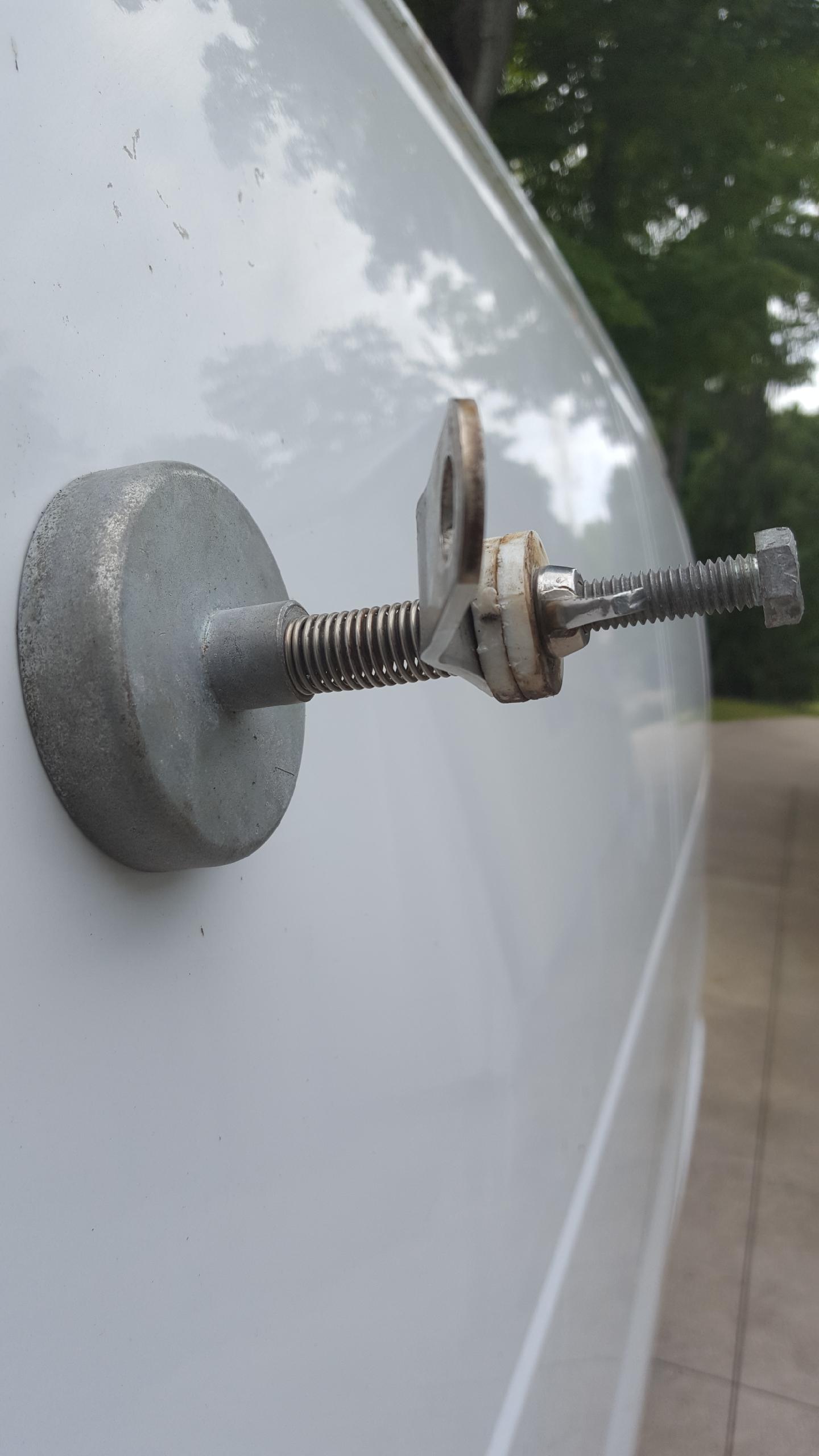

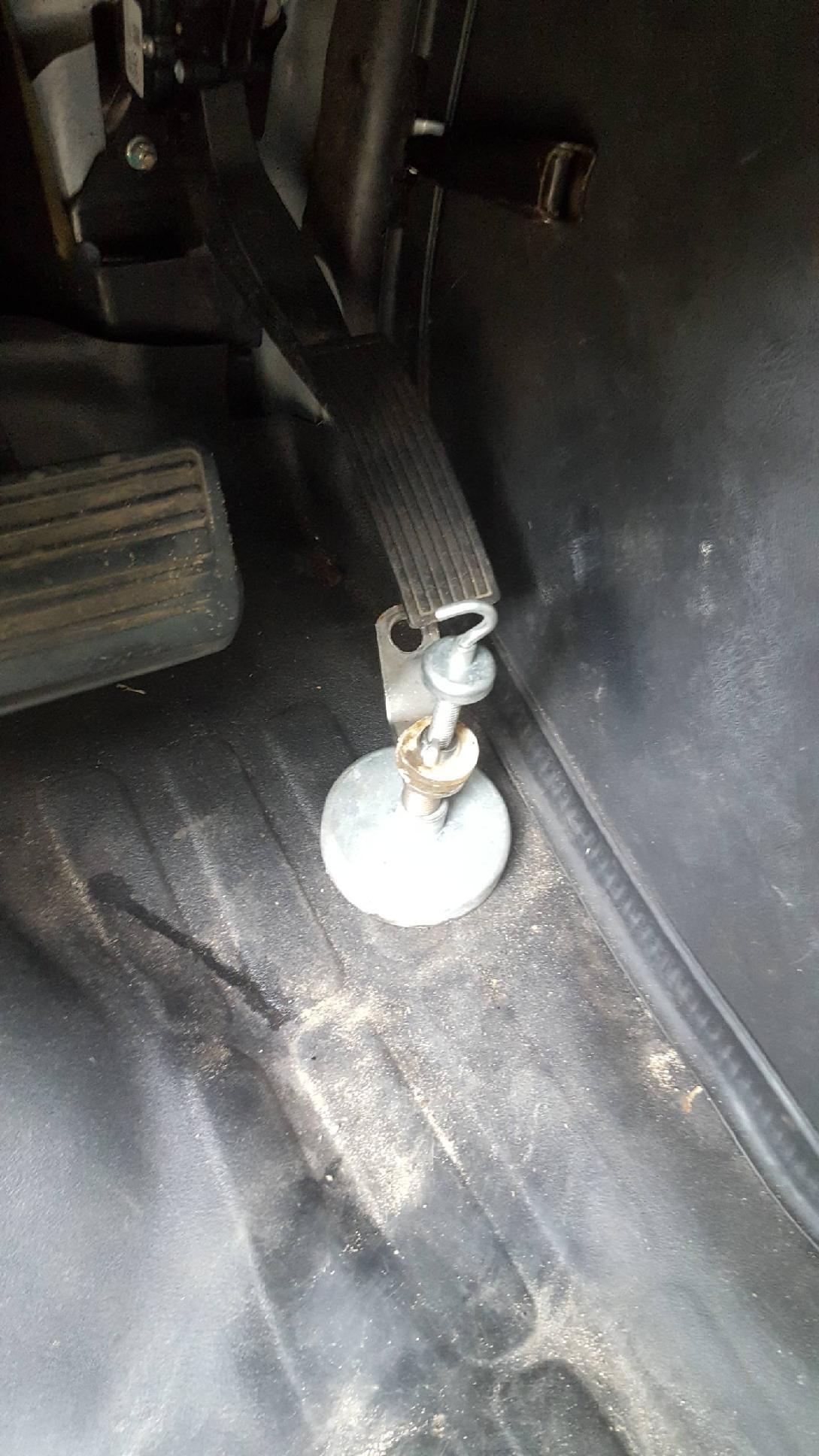

@Rob Grady Made a cool gadget to work with electronic throttle (drive by wire).. A magnetic mount adjustable to desired RPM..
@Able 2.0 Sent me this as a joke, but it's not stupid if it works..
View attachment 112602View attachment 112603

It gets mounted under the dash.. You drill a hole on the top of the throttle pedal.. It pulls the top of the pedal which simulated like stepping on the pedal.. It works on a 2000 Chevy.. It works for other diesel applications..
I’m sure it should work for you.. But then again, I have no “real hands on” practical experience with it yet..

Patent not pending. The magnetic throttle control I use for my 07 Butler works well for my purposes. I can set speed/rpm by dialing down on the threaded rod, using a TinyTach to determine engine speed.
I am only using this setup as an interim measure until I can dig deeper into the mysteries of the Butler wiring this winter.

It''s not complicated. Look at the pic Nate posted. Nothing more than a heavy duty magnet with a threaded rod and a SS bracket that dials down/up to set rpm.
