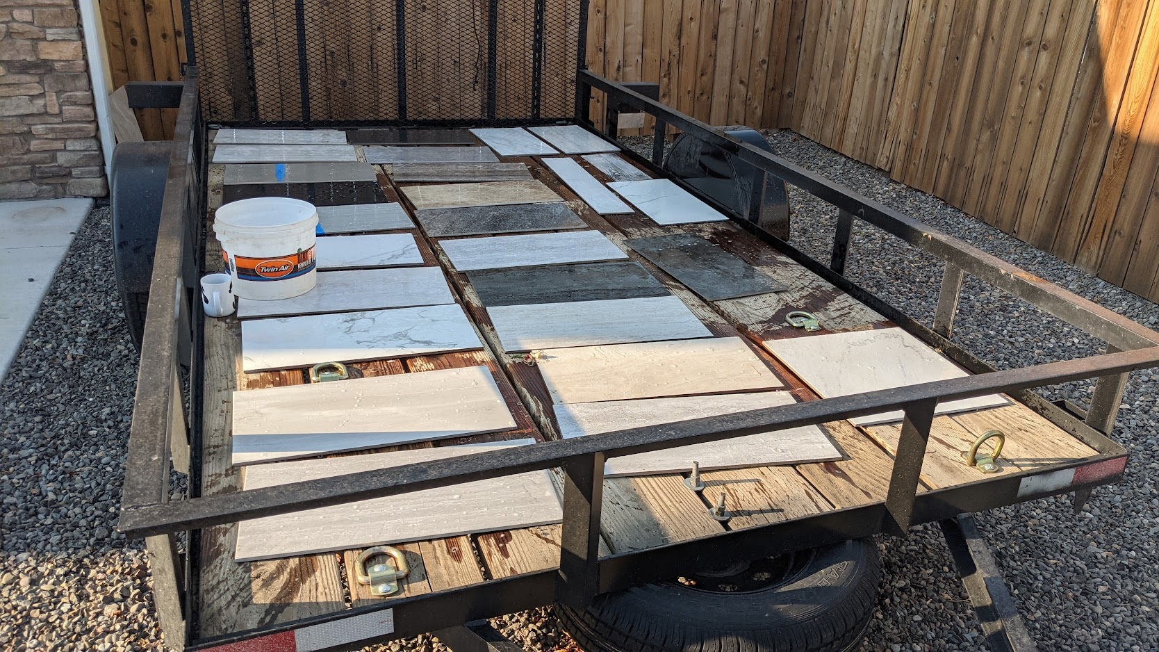

The photograph on these tiles is so close to the surface that our new saying needs to be, "Mrs Piftleton, I can get your grout spotless but I'll ruin your tile in the process"...
