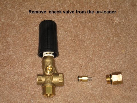

did you remove the check valve...???

Have not removed check valve. I'll try that. Thanks.
That did it! Thanks, Jim!!!
Eric at Cat Pump suspected the check valve. Thanks, Eric!!!

So you just take out the check valve and leave it out? What does it do?
