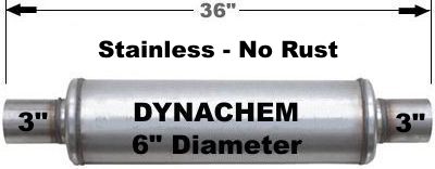

using high flo 4 I.D muffler for #5 blower

Would a straight through 4 I.D high flo muffler be TOO LOUD?
Depends on what "too loud" means to you. I like the looks of it though. I have often thought a longer muffler with an adequate i.d. would do as well or better than a short choked down silencer. Only speculation though. It is another thing I have thought but not tried.

Ashley;
The muffler in your picture is too short for effective silencing.
This is the minimum length that we have found to be effective on a #5:
Larry

Larry, what is the actual measurement of the shell of that silencer without the inlet and outlet. I was going to order one but want to make sure it will fit.
