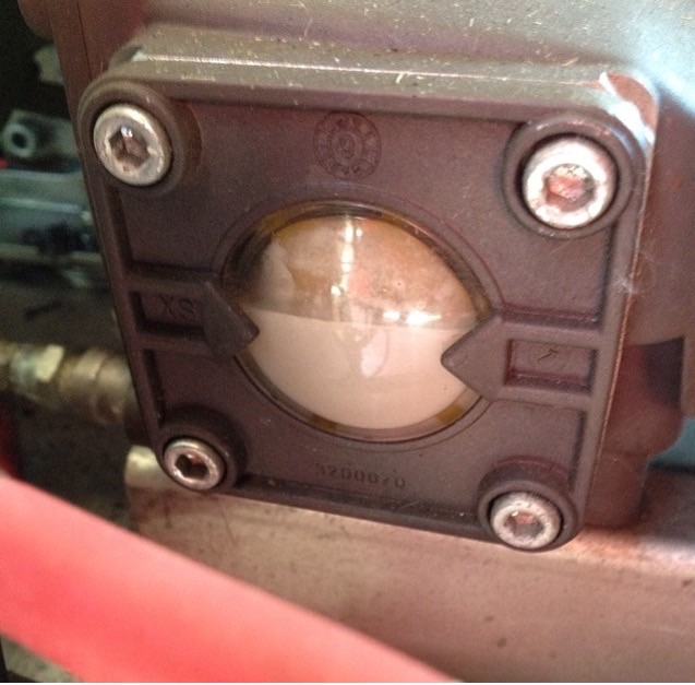

Did it look like this?

...a few ounces showed up in my AT's cat pump.
Saw it in the site tube AT installs..
Drained it out but it's obvious the oil's been polluted.
What causes the high pressure seal to fail after a year in a half?
Seals can (and sometimes do) get ruined in one day! How? Running a pump ā€œdryā€ or running at too high of a pressure are two typical ways this can happen. What has happened over the course of a year and a half? How many hours are on the pump? Maybe the pump has been cavitating, causing the seals to wear? What about the water temperature or chemicals being used?
A worn high-pressure seal will not leak water; a worn high-pressure seal will cause a loss in pressure. A worn low-pressure seal will cause a pump to leak. As for the reports from other users who have had many years on their Cat Pumps without issues, odds are they are operating well within pump specs and have the pump inlet plumbed properly. In our experience, the inlet condition is the main factor determining pump life, everything else being equal.
One more thing: just like you would not run your truck for 100,000 miles without an oil change, it is a good idea to drain and replace the crankcase oil every so often. We build our pumps like tanks to run for a long, long time, but please do not tempt fate!

Oil is stinking cheap. Change it twice, now, and after 30 minutes running.
If you leave the water in it for any length of time you get that milky emulsion that won't drain completely the first change.
