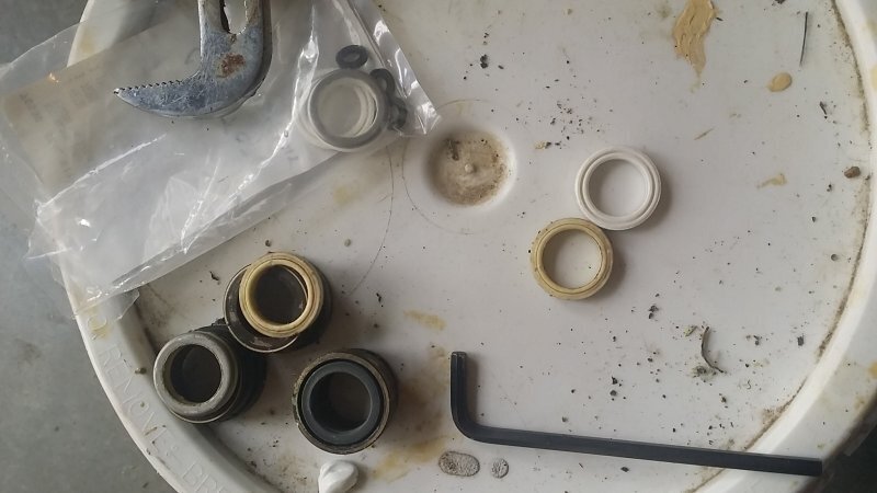

water in my cat
May 16, 2010
1,191
Noble Carpet Cleaners
sucks but sometimes mechanisms fail earlier then perhaps many other like it. Tiny amonts of water could be sneaking past the piston seals. Just monitor it and see how she goes..

That doesn't look right. Something else is going on. Your water softner is running salt through. Check the water in the tank that goes to the pump. What's really in it.

I just had a 5cp pump rebuilt after 700 hrs, Cat said the check valves and seals showed excessive wear:hopeless:. The older style Cat pumps that Butler used would go 3500 hrs plus. My next pump will be a General, half the price and from what I hear a much better pump.:rockon:

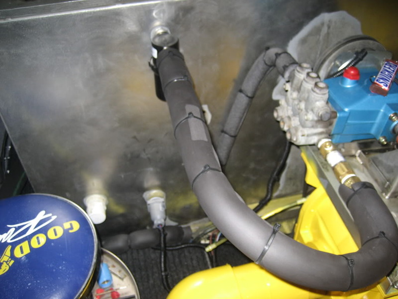

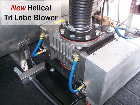

As mikes machine as well as rims machine are newer aerotechs that have the pump Mounted to the floor in the box well below the fluid or water level in the fresh tank.
You will notice the cat pump right in front of blower on floor of truck.
Older trucks like mine have the pump mounted above the blower always above the water line by at least a foot or so and the pump has to pull one foot up and at least two feet across to get the water.
I had cavitation but only because of that General pump fine inlet strainer connected to pump would suck a bit of air, once removed never have had cavitation again. Our tanks after a couple of hours will hover at 150-160 degrees preheated by motor while driving around.

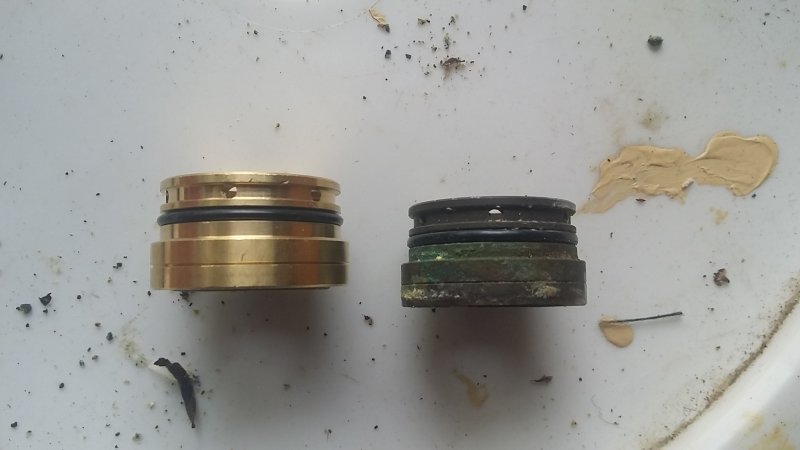

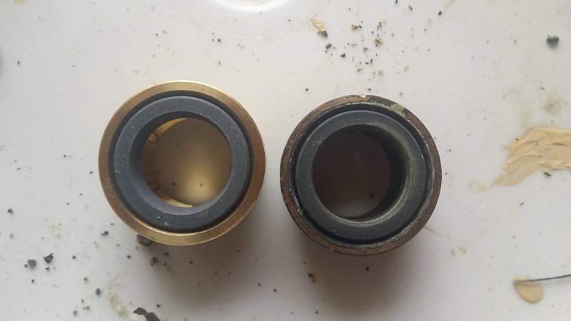

That didn't look so much like wear as it did something aggressively attacking it. ???

That is what I mean as the brass plug mike has posted a pic of does not move, it is stationary. The plunger moves in and out of the middle of it creating pressure in the head. So what ever is "wearing or eating" it has to be in the water.

I agree. severe cavitation can/will erode the pump materials but not (in my experience) discolor them like that. Certainly looks like either chemical attack or electrolysis to me.
