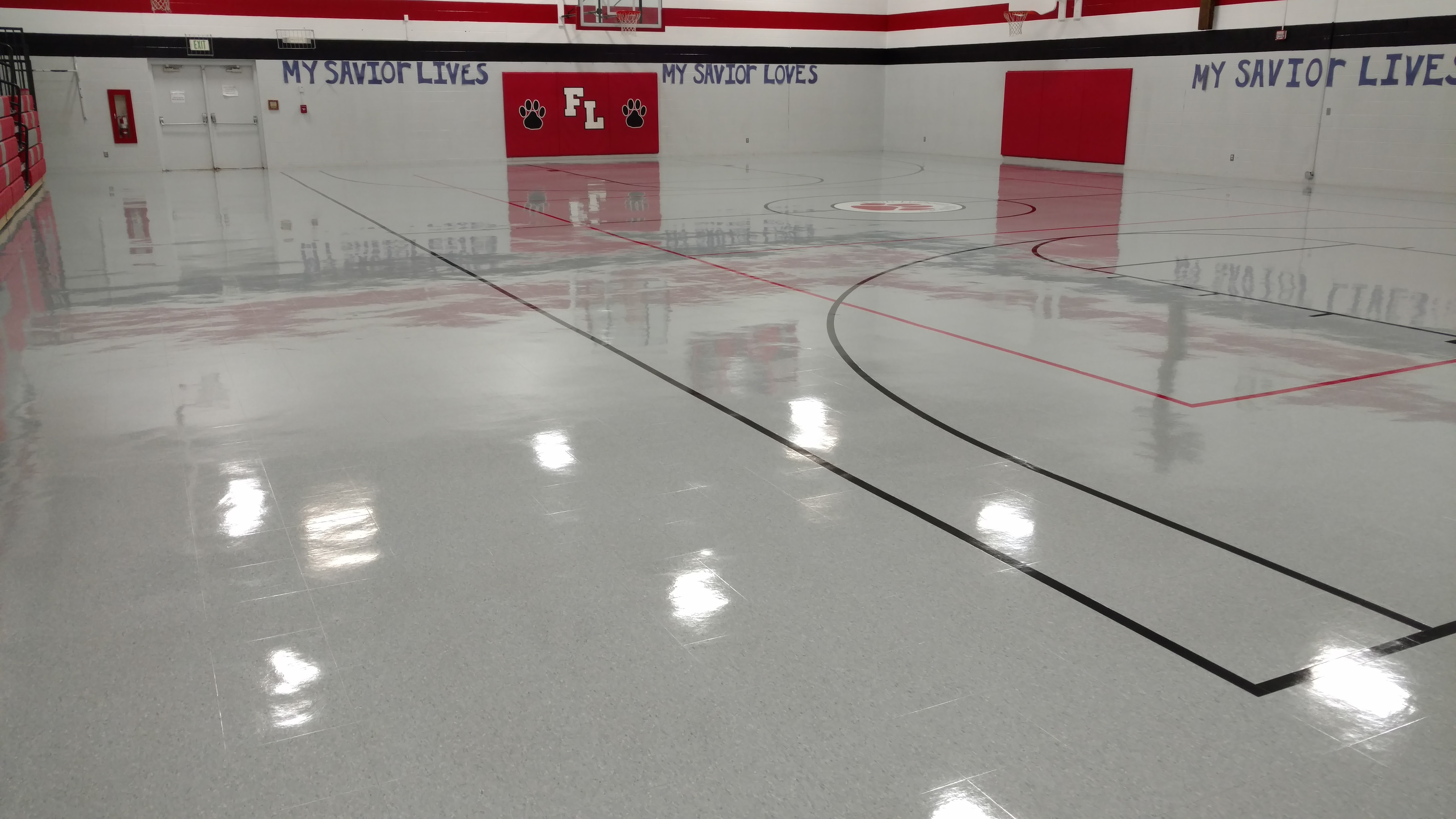

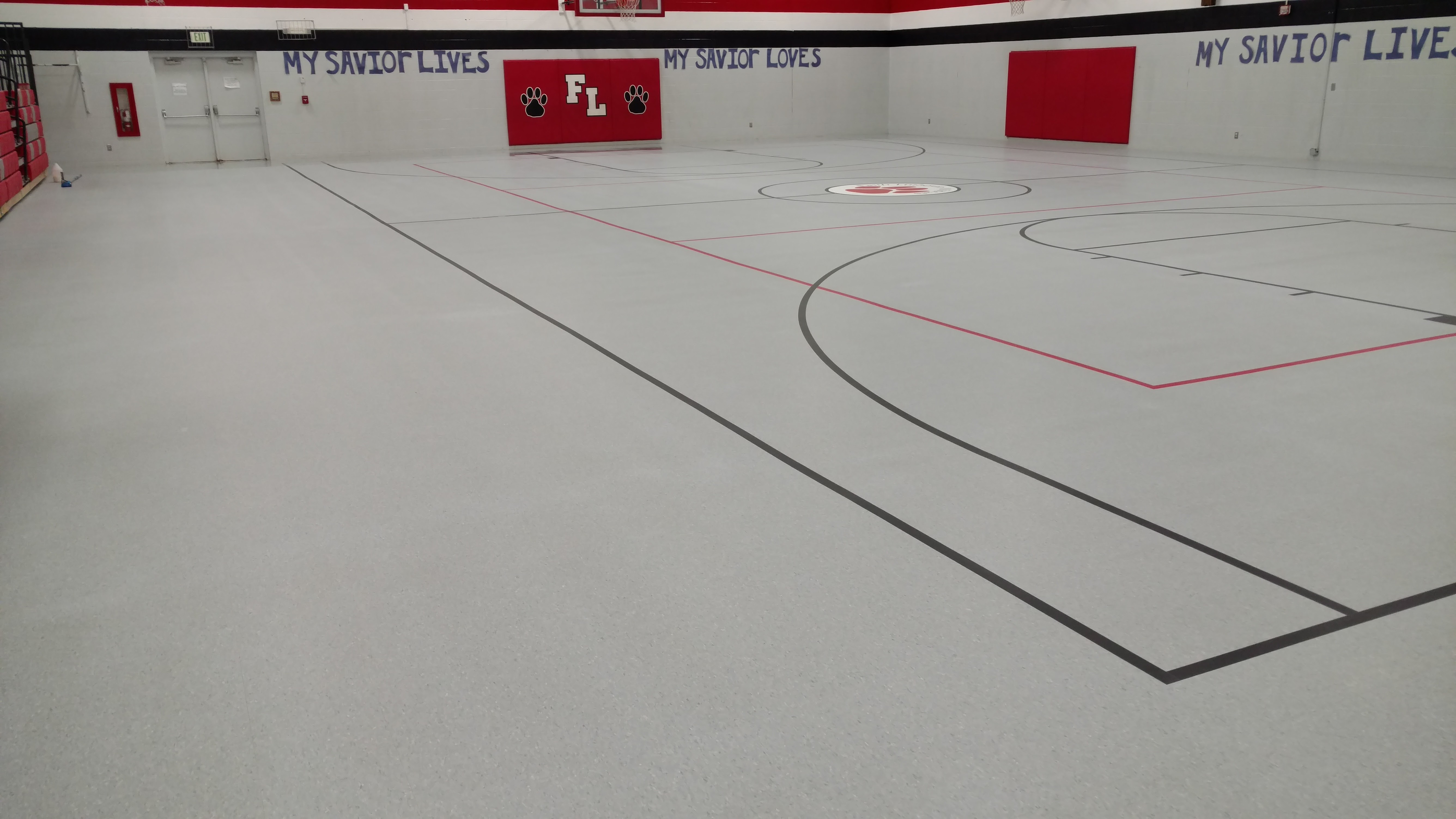

32inch flat mop , poor down about a 10ft line , then go back and forth spreading out the wax. Killing time? sitting on a 5 gallon bucket of wax. I will put down blowers to speed dry so as the wax is drying I'm moving the blowers.

View attachment 79364 View attachment 79365

On this floor I used 1 gallon jugs , I only use 5 gallon jugs at Nexteer.
I poured the wax center between the bleachers and the first black line and did the same with all the other lines , something in my head says stay between the lines :shrug:
How thick? I guess enough to make sure it will cover the area I'm spreading it over.
