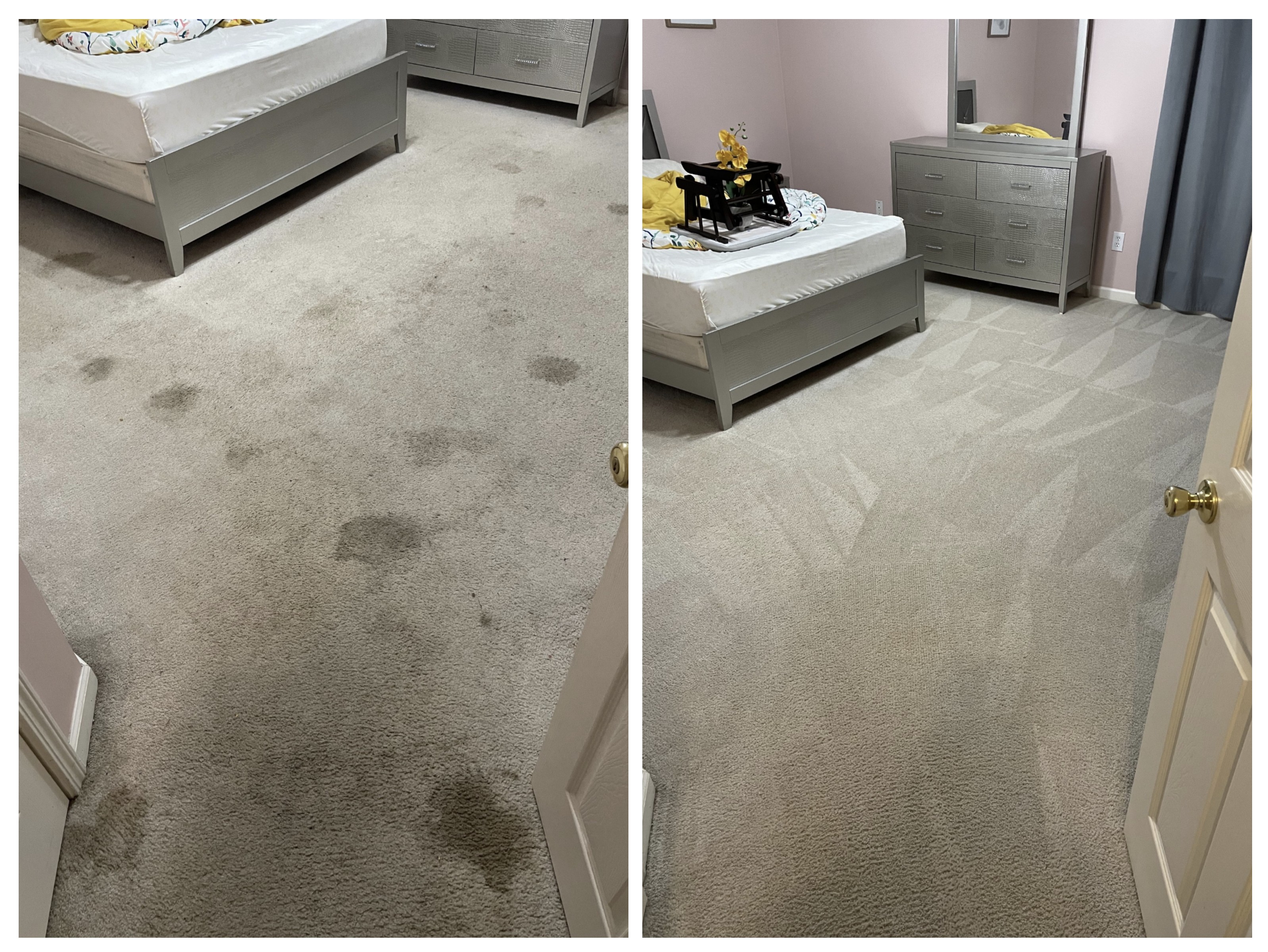

Well … the story is that it’s a rental that we cleaned 18 months ago and this lady moved in at that time. Brady did the job and told me it was trashed. He had to RV it and P-Sor it …. It was horrible.
Anyway, the lady thinks it’s old soil coming back … 18 months later.
Pet stain remover residue attract soil.
Urine salts attract moisture and will cause rings to reappear.
My bet is all the over the counter crap used.
Take a sponge rub it in dirt and rinse it.
Same sponge with a drop of dish soap foams for a week.
Hard to flush all the crap out.
11,335
California
auuunndd there's a difference in wicking and recurring spots.
trashed thru the pad, it WILL come back with traffic regardless sooner or later
Sticky spotters, I tell customers all the time take a piece of tape put it on the carpet and pull it up that area now has adhesive and will grab the dirt of the shoe quicker then any other area.
Bad spotters and soda spills with sugars do the same thing.
11,335
California
Nice before and after Marty good job.
if thats the case, the CC'er simply didn't flush/rinsed well enough.
Or they disappeared with pre-spray dwell (real common on berbers) and didn't get added attention needed.
soda spills with sugars so the same thing
only if they're allowed to soak thru backing to the pad.
Then you can get "recurring" spots with traffic in months to years(not wicking)
Otherwise, it's not flush/rinsed well enough to the base of the fiber.
t'ain't rocket surgery
..LT.A.
14,197
It is. If you’re a Matt type of guy you can easily get in trouble using a RV. That’s why they tell you to lower your pressure and heat when using one.However, that is a moot point in this discussion. You see … if something is going to wick it wicks as the carpet is drying. Wicking of soils is not going to appear suddenly 18 months later.
This is why I seldom take seriously what I read here because the average idiot here shoots from the hip without thinking. The idiots like Pemberton being the exception.
18months later. Did she say it appeared back 18months
Because
The property manager never mentioned any of this. She just said go clean it and send her ( the property manager) the bill.
How I figure it out was when I first went into the room with the customer I said “oh man… what kind of dog do you have”? She said “I don’t have a dog.” “This all came back after the last guy cleaned it.
I think it wicked back shortly after you had it cleaned and she just tolerated the spots for 18months

Like you said padding.
Also some spotters take for ever to flush, you could use a product called ARA that will kill stick spots and stop rapid resoil.
Also urine salts a hydrophilic and attract moisture, if your not getting those out completely they'll cause a ring after time.
Obviously you could lift the carpet cut out the pad and flush it out as best as possible.
But I doubt you'll get it all.

1st Larry great observation on the dresser. Yes kinda creepy.
2nd Marty did Brady or yourself use a black lite to confirm and deny the clients ignorance ?
3rd -No biggie you did a superb job , let the slob pay thru the nose next time also...
4th -definitely pet stains ,next visit look at him tell him look Doofus ,I been doing this for decades now smile as you tip me !
