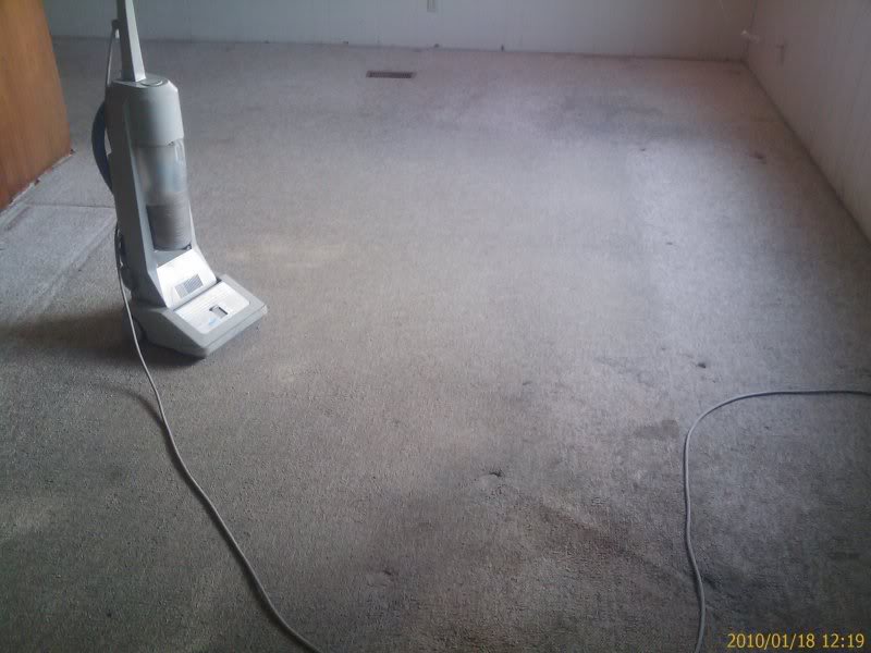

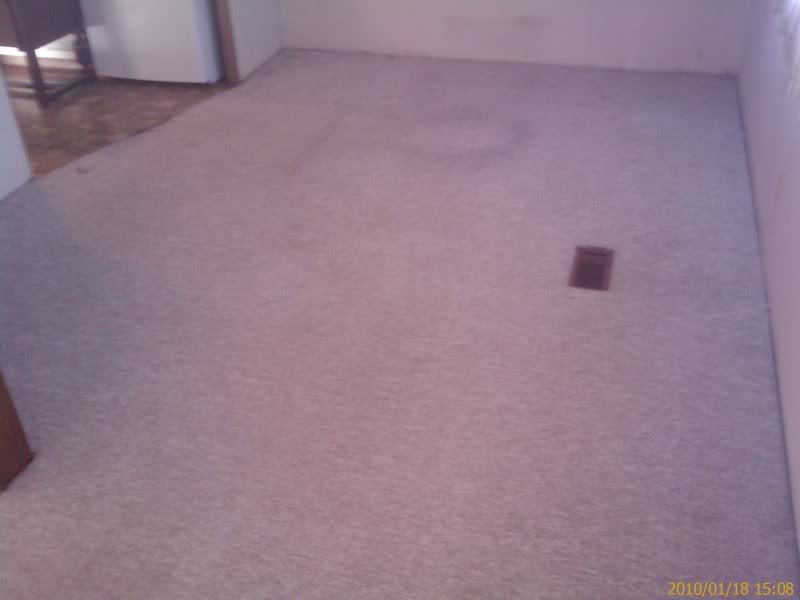

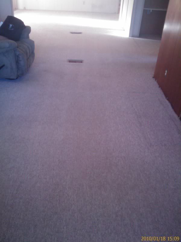

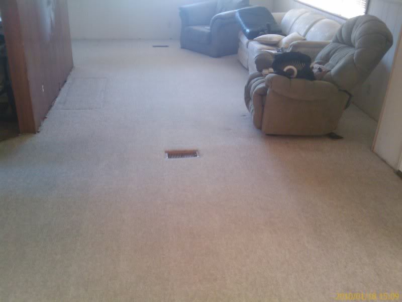

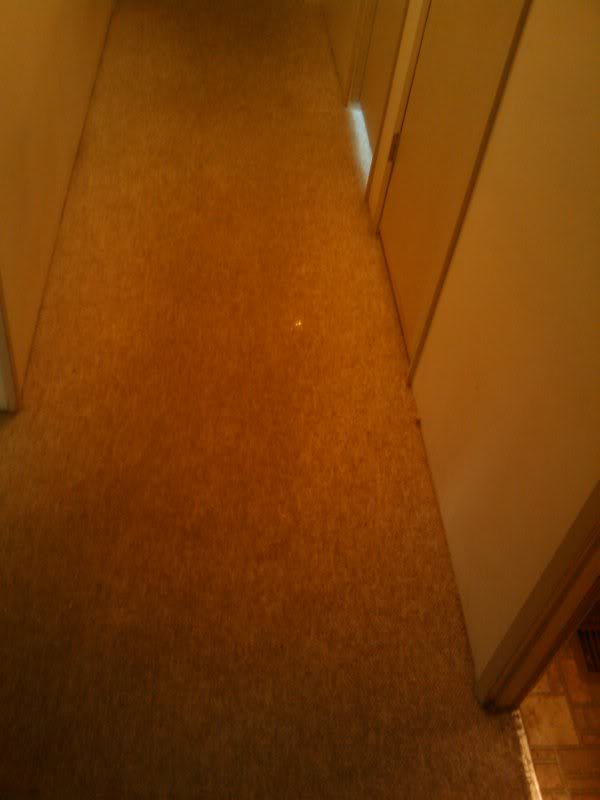

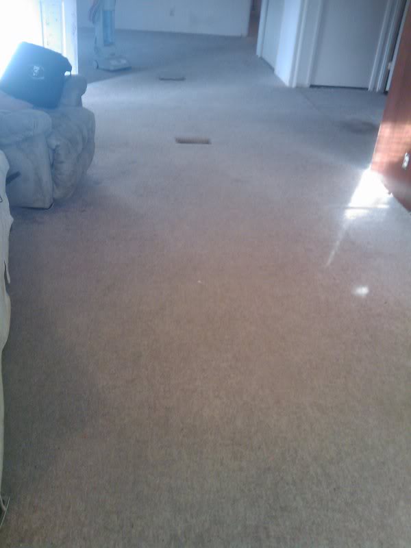

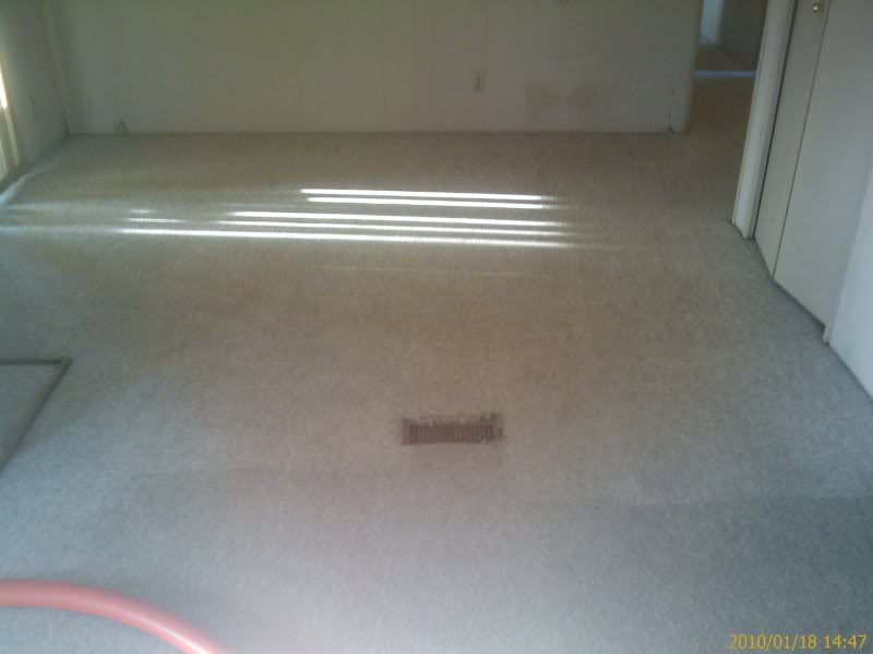

In response to Art's request to help teach how to successfully HWE berber carpet, rather than pretend to with dry cleaning, I offer these pics.
You can observe the time spent with the time embedding in the pictures. Took a while but they were pleasantly surprised with the results.
Oh, btw, I had my heat setting down, temp did not get much over 200F if it even did.
Before

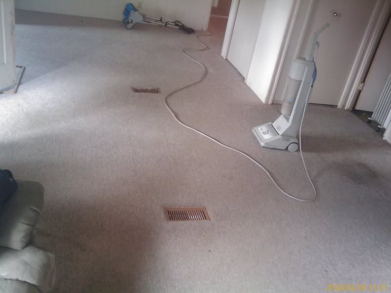

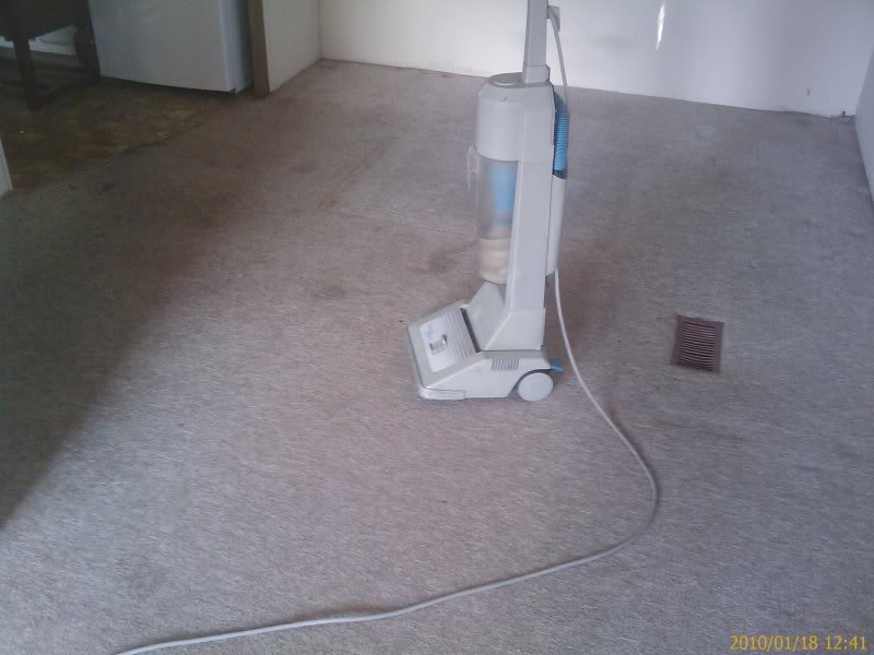

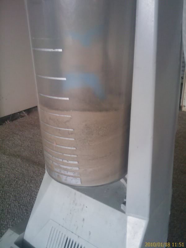

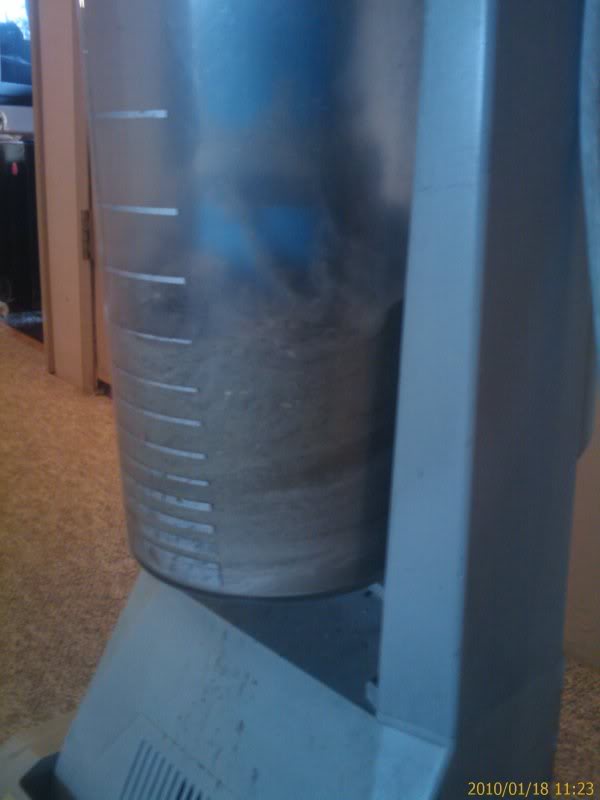

Vacuuming the hall and about 10ft of the main room

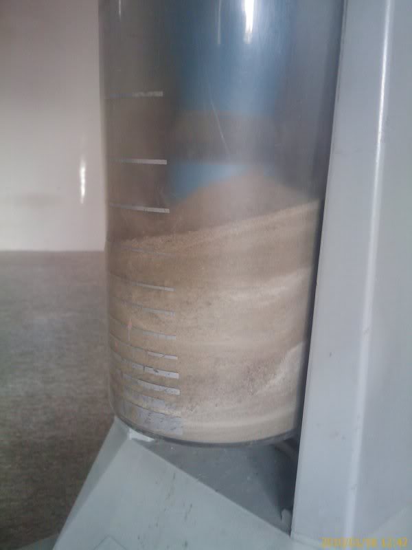

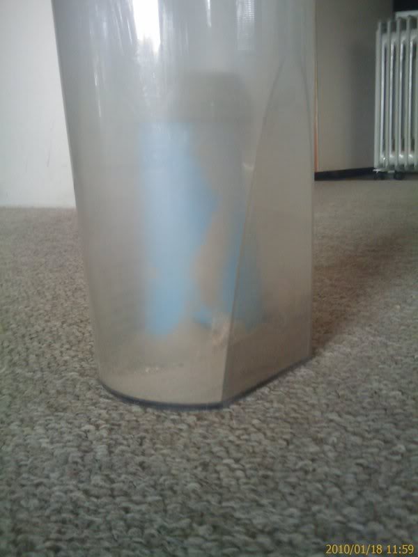

I went over the carpet again and recovered this soil.

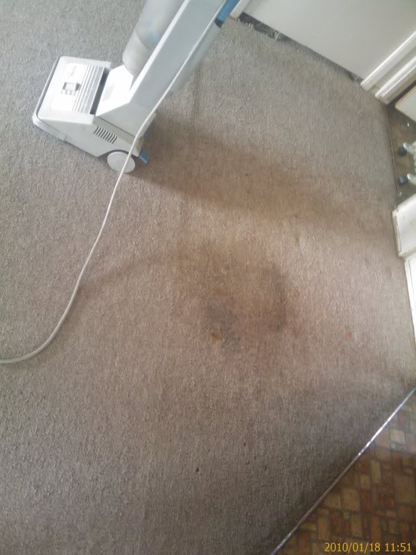

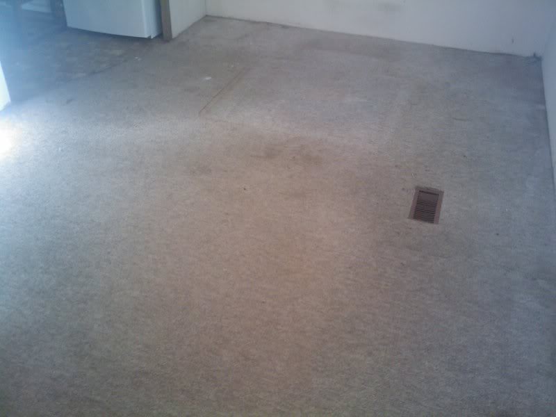

Vacuumed the area between the registers
note the big black spot.
Revacuumed the area

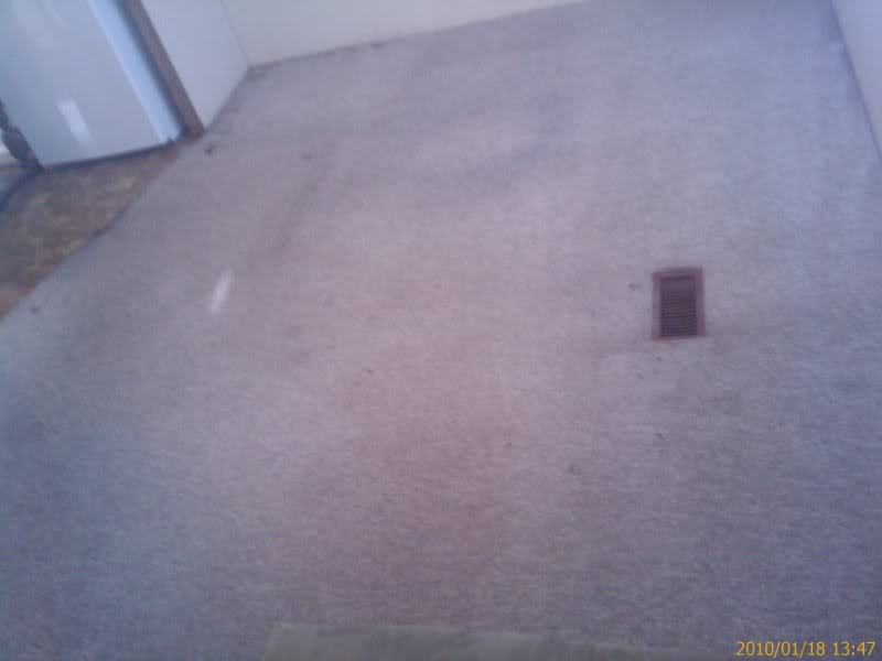

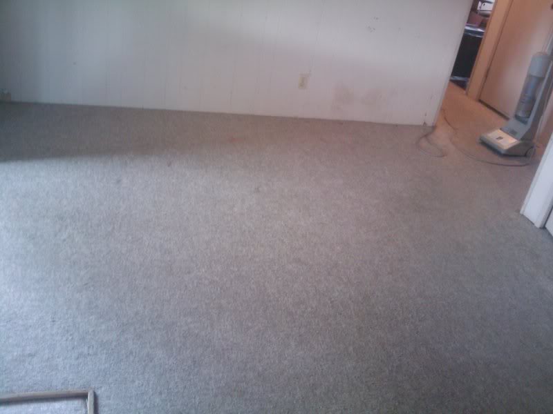

Vacuumed this area, the LR
And the final area to vacuum, the dining room.

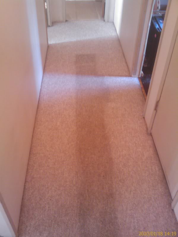

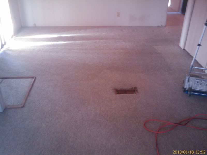

Applied prespray; O2 with modifier. Mixed it at 16oz/2gallons, filled a yellow tip hydroforce sprayer.
Added about 4 tblspns of Hot Sauce.

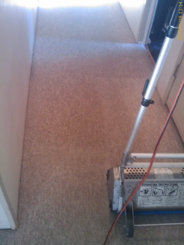

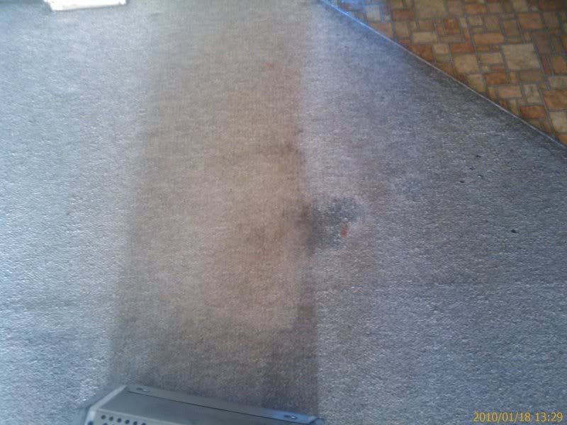

Scrubbed it in with a Whittaker CRB. You can see the difference already in the hall.
remember that black spot? Scrubbing only has removed most of it

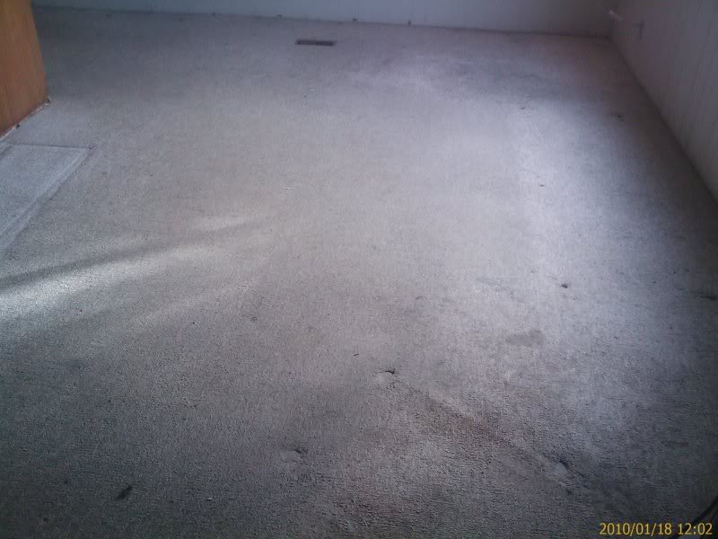

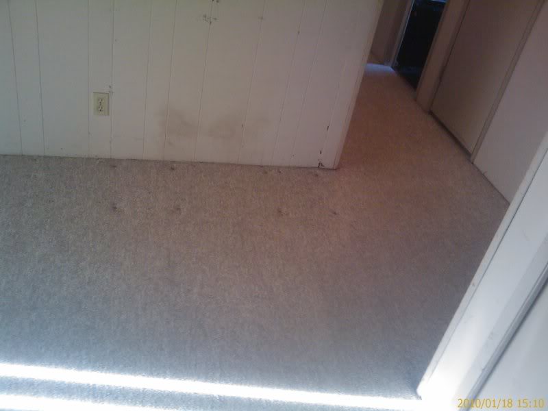

And in the LR
and the DR. You can see a circular wear area where there was an office chair.

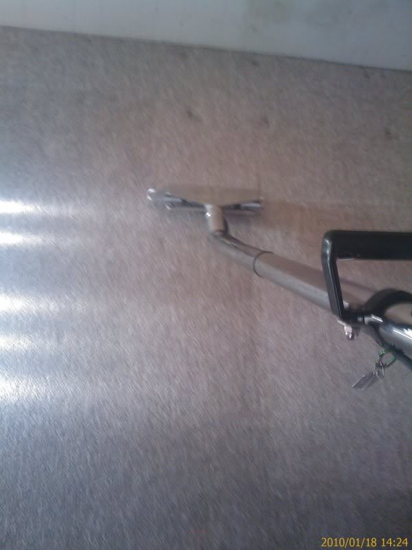

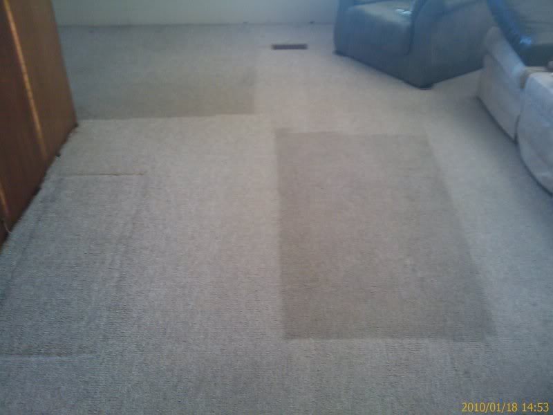

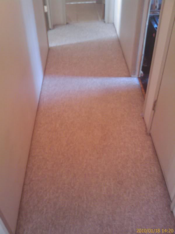

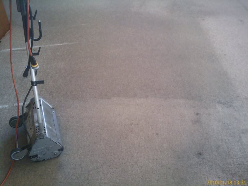

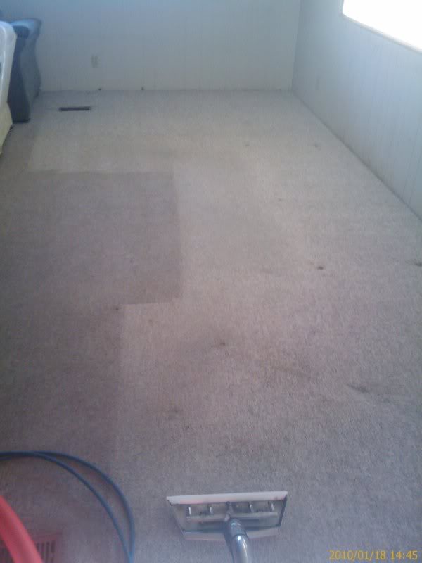

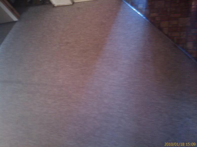

Finally the rinsing. HWE with 15 flow, holed glide, temp around 190F. Had the temp down for prespraying and forgot to turn it up. Prep work did most to the work. Look how clean this hall came and it stayed that way!
What black spot?!
Best way I know to clean berber, vacuum the snot out of it, then clean it.
Remove the soil and its no longer an issue.

Oh, took about 2 1/2hrs to vac, total time in was about 5hrs. Charged $400.
Water pressure was 600psi with that 15 flow.

use a better vacuum cleaner and it would take you 30 minutes to vacuum

If someone knows of a vacuum that will pull that soil in 30 min, please post.
John at Mytee and I have talked of designing one. It'd be fun!

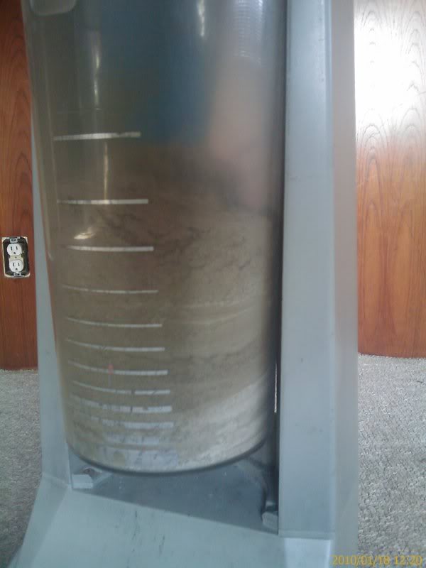

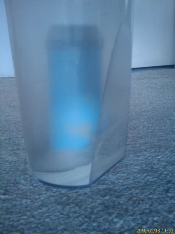

There was one other room I cleaned in this trailer, the master bedroom. It has plush carpet so I didn't include it with the pics, just focused on the berber.
I got 2 canisters of soil out of a 150sf room, cut pile carpet, and it came up just as great. The CRB really brought that carpet back to life.
