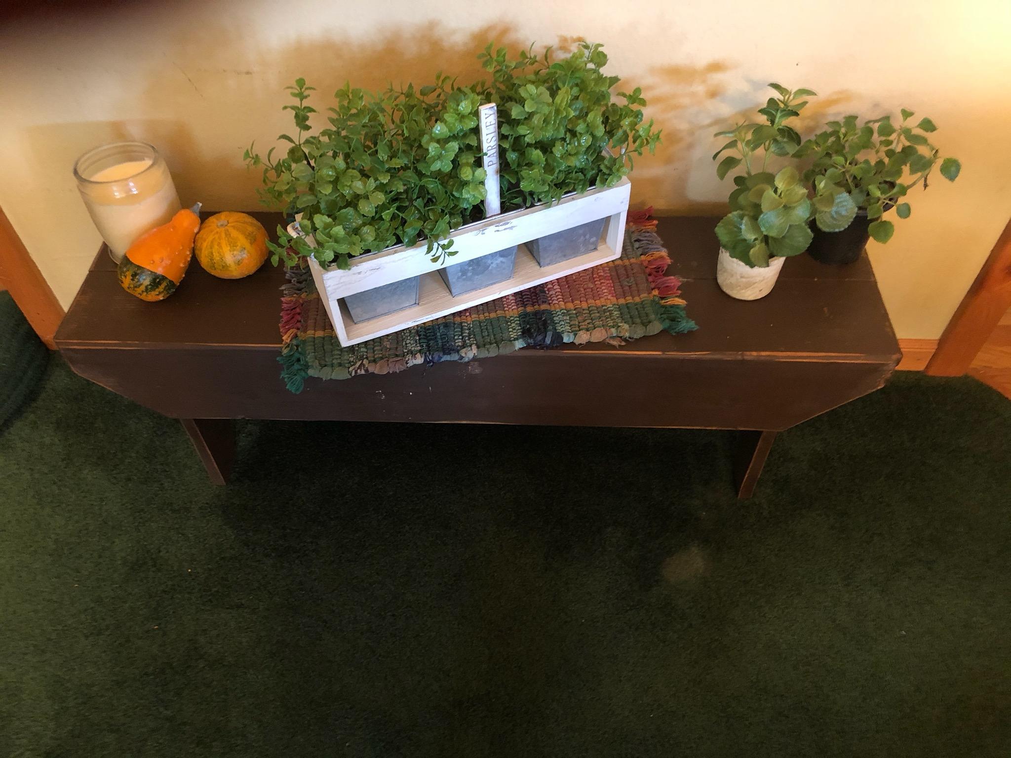

Probably does but I've never noticed. I have a condo tower where the janitorial loves hydrogen peroxide cleaners. Nylon commercial carpets, mainly brown and green. I am able to blend the colors a little so that you don't notice. I clean them every year and most of the time I don't have to retouch.the oily residue doesn't attract dirt?

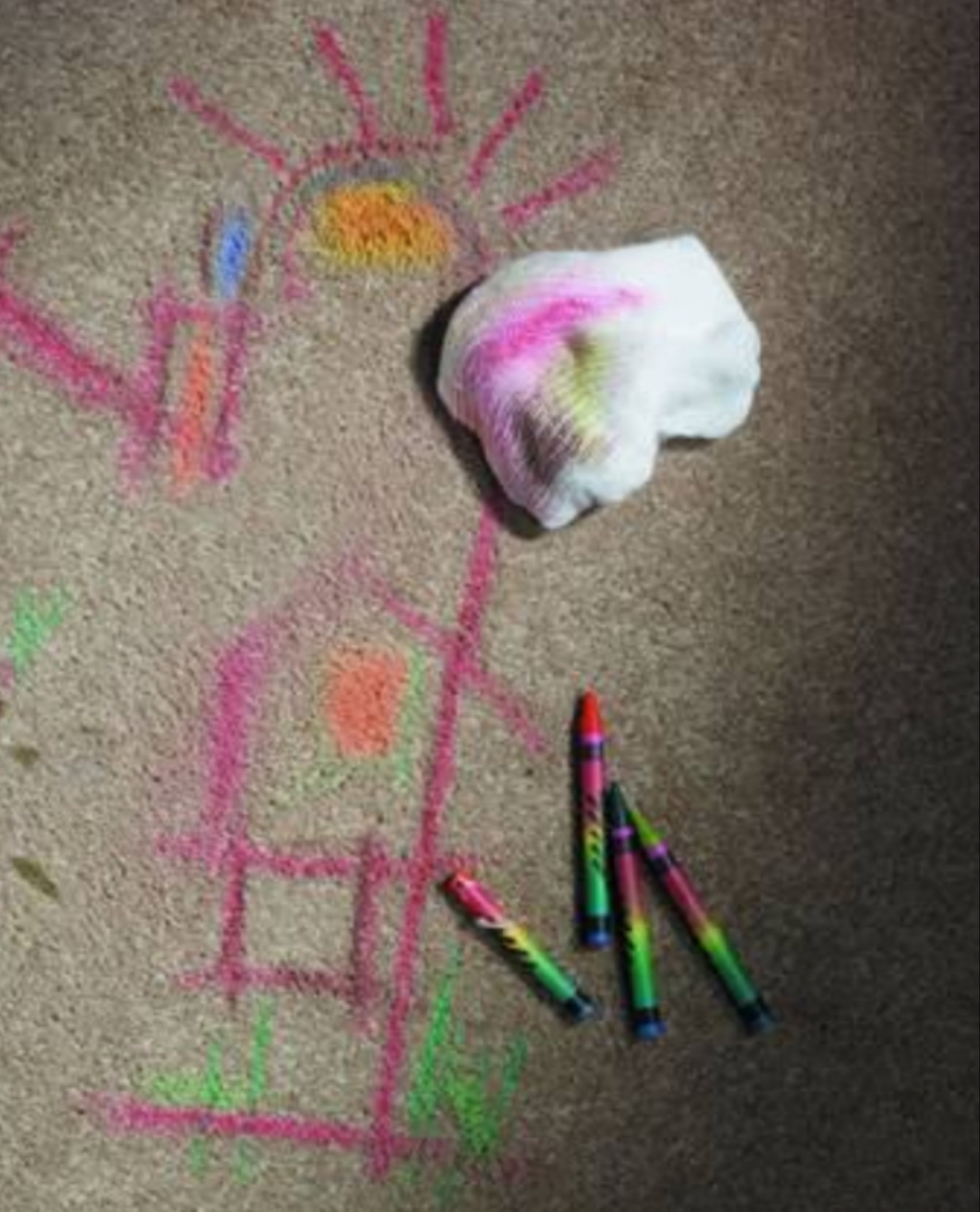

Wax crayons are better.
Use a hair dryer to melt the wax into the fiber.
It's permanent.
If working on Sisal, use boot polish, you may need to mix different colors to obtain the correct color.
Some can even be done (rental vacates) using chalk.
Has anyone tried these?
I have had much better luck, if you want to call it that, using pemenant markers for a quick fix. Good enough for rentals.Wax crayons are better.
It's permanent.
Oil pastel crayons
