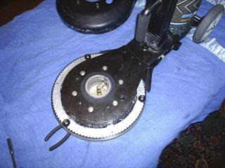

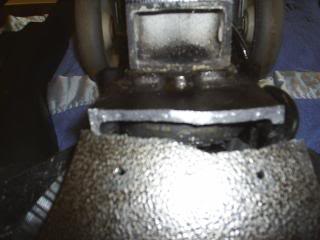

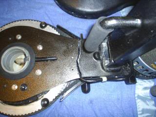

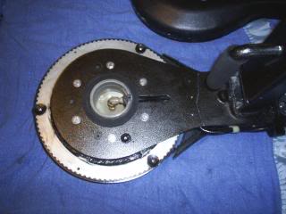

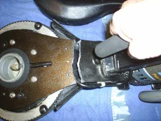

THIS PICTURE.............................. :shock:
sweendogg said:Harper check your local Jon Don for ideas or to see if hydra master might consider replacing/repairing it. Otherwise I'd check with hydrmaster diret and then if all else fails, take it to your local metal shop. If its aluminum they may be able to tig weld it back together and gring it down. If its pot metal it will more difficult though I suspect it is aluminum and you are correct. Crystalization of the metal causing the crack is a defect.
HARPER said:HELP....................
One of you GURU's....Has to have some IdEa'S....![]()
HARPER said:We only use this unit for area rugs on HARD surfaces...."It is a MONEY MAKER for us..!"
Long Duk Dong said:HARPER said:We only use this unit for area rugs on HARD surfaces...."It is a MONEY MAKER for us..!"
If it's a "MONEY MAKER" go buy another one.....are you a cheap ass like MARTha suTlee???
Shawn Forsythe said:You may want to consider just replacing the frame/base for around $ 600.00
Welding cast aluminum, with porosity already suspected, without dimensional distortion can get pricey and "iffy", and you would still be hoping that it wouldn't break again.
