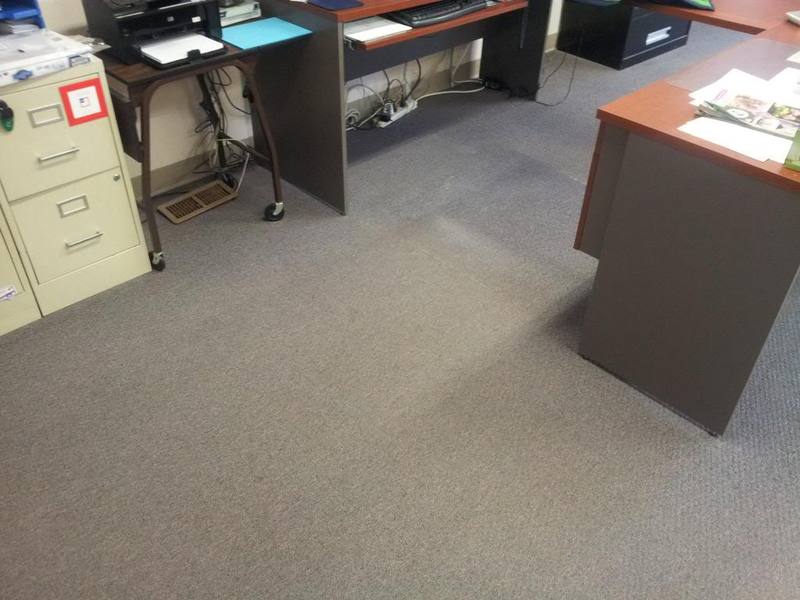

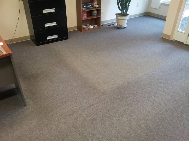

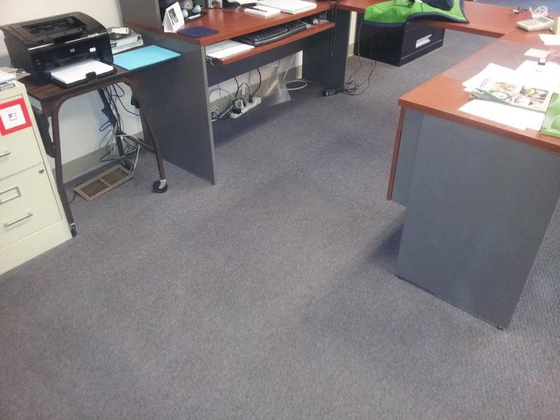

the pic's below are from a REALLY small job, i think it is our smallest commercial office (one of our insurance agent's satellite offices in a very small town.) probably about a 16'x17' room basically, with 3 mats. last time we cleaned it was 2 years ago. every time we clean it, it gradually looks a little better than the previous year...typical of my experience with encap on CGD. the 20" Trio cleaned it slightly faster than the Cimex it seemed, last night's larger job was a better judge.
hard to say on this small job if it gave a better appearance of clean than in past cleanings. overall i was happy with the outcome. it used i'm guessing half the encap juice that the Cimex would. and it dried in about 20 minutes, i was quite surprised. i was happy with the area of carpet that transitions to the chair mat...you know that area where the chair wheels roll off of it all the time and the carpet gets really worn (permanent damage) because the chair mat is too small? i'd say it cleaned that area up about as good as the Cimex. but i'll need a full day of using and cleaning 100+ cubes/offices and i'll get a better idea on that front.
my 2 biggest worries when running this CRB was:
1) it grabbing a loose seam and pulling it out (there was a seam all the way down the center of the carpet, i cut 1 piece off with my duckbill shears.)
2) it grabbing a phone/computer/monitor cord and tearing it out of the wall...i stayed far away from those things! with the Cimex i can get right up to them and let the Cimex push them out of the way a lot of times (although my Cimex did tear 1 phone cord out of the wall about 7 years ago :Oops ... but that is a rare thing for the Cimex.)
here are some pic's.

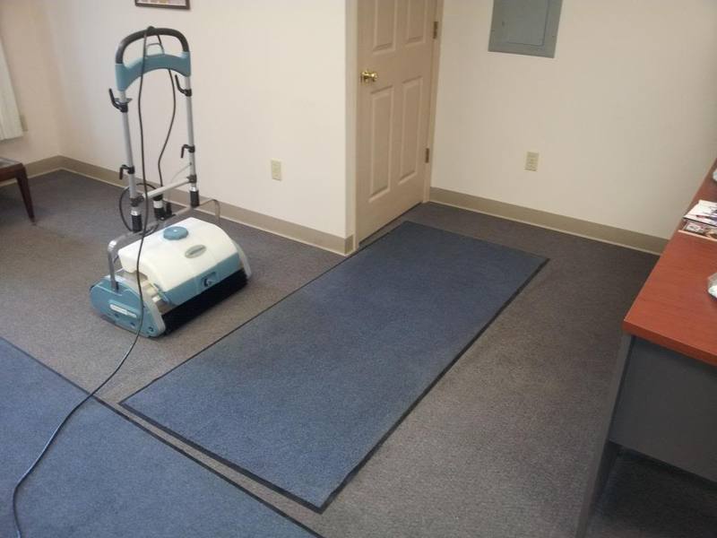

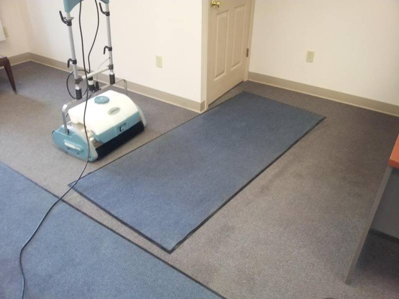

before pic of a mat with a spot:
after pic of clean mats and spot mostly gone:
i wasn't happy with seeing some of the spot still. i thought it was something my Cimex could clean up with ease, so i fired up the Cimex. well i'll be, the Cimex didn't do any better of a job at removing that spot:
chair mat transition area before:
chair mat transition area after, it looked great:
"waiting area" before:
"waiting area" after:

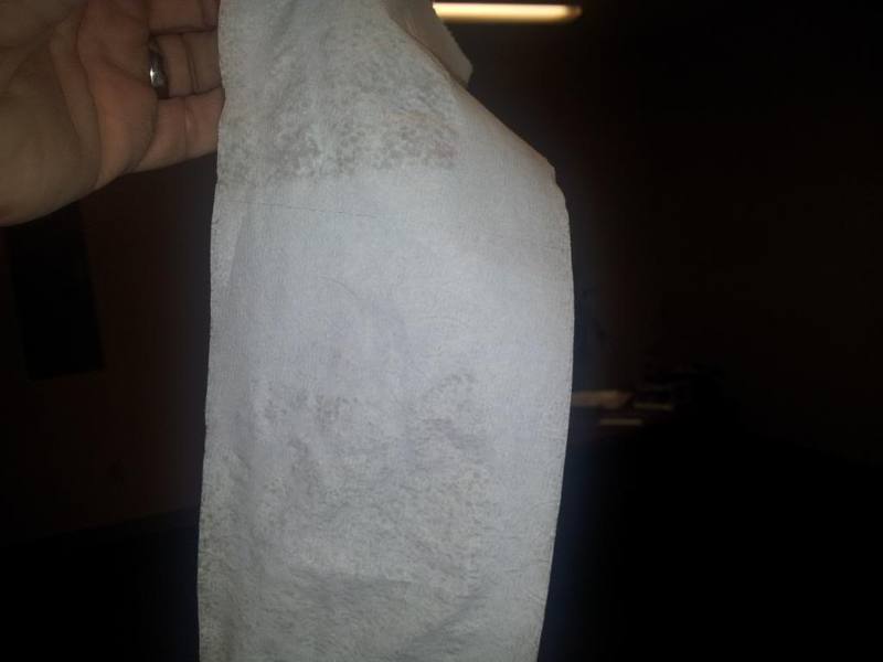

the "toilet paper" test (i placed it on the last area of carpet i cleaned and stepped on it, see my fat foot print? nearly dry already!):
renovator tray after i finished (i thought it woulda had more in it, i guess my Dyson does a decent job of pre-vac'ing after all):
the 3 brush rolls after i finished. still as clean as new:
when i was done i was pretty excited. i called my contact there on Thursday and she was very pleased and thought it looked as good or better than in the past.
last night i completed a larger project, an oily machine-shop-type office, mostly halls. sorry no pic's, i didn't stop for anything. i wanted to see how long it took compared to the Cimex we've used in the past here. it took the same amount of time as our Cimex did in past visits.
BTW, this project was so oily/dirty that i used as much encap sol as i normally do there with the Cimex...carpet dried faster though. almost gobbled up 1 ethernet cable and the Trio's own cable with it. that is basically going to happen at some point. hopefully i don't ever pull a monitor off a desktop and smash it.
and 1 small mat it gobbled up the end of it, had to have the missus stand on it to clean it effectively.
i'll know better on Monday when i call my machine shop contact to see what she thought of how it all turned out, but i was VERY happy. i didn't need to use the Cimex at all. the toughest areas for the Trio to clean was under some desks at this office (we CC'ed 3 offices and 1 cube also.) the Cimex can reach under them better. overall i think it cleans just as good.
if the Client is happy on Monday then i'd def recommend this machine. so far i gotta agree with Randy, seems we have a VLM machine that will encap clean a CGD extremely well and is mill approved.
overall, it seems to clean much better than i anticipated. i couldn't be happier. i think the only question now is, do i keep this 25" wide machine or get the 20" wide machine (which is their 15" model.)
