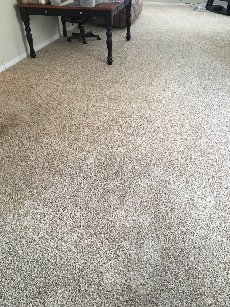

Did a whole house cleaning and some stretching for $$779 today 5 hours, and I got a bucket of scraps to.
Boy does restretching a Home Depot install suck!
I feel like a one legged man in a ass kicking contest.

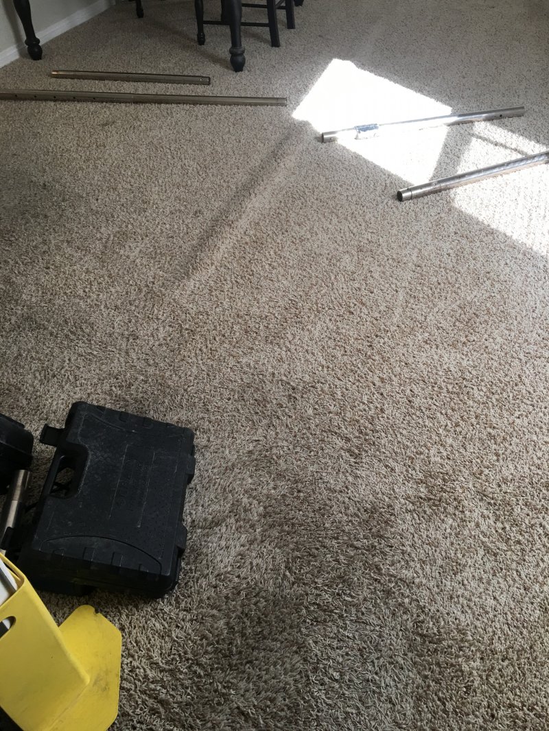

I usually request all furniture out if possible, this one had some easy pulls with a kicker then power stretched the opposite direction.
Also opened a hall seam I just pulled it apart by hand, not a good install at all.
Power stretched towards seam locked it in,
Then I kicked from the other direction and used some nails into the carpet through the plywood to hold it while I trimmed it and reseamed it up.

Use a "stay block" to hold tension on the carpet to minimize damage instead of just nails.

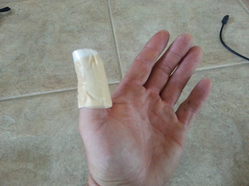

The day I found out my 2001 Express 3500 loaded with 2,ooo pounds of equipment could do 95 MPH, was the day I was driving myself to the clinic due to a repair gone horribly wrong with a bloody mary. Cut my thumb right down to the bone. Blood spurted across the room.
The second picture is when I burned my ankle with steam. I just uploaded it for sympathy.
