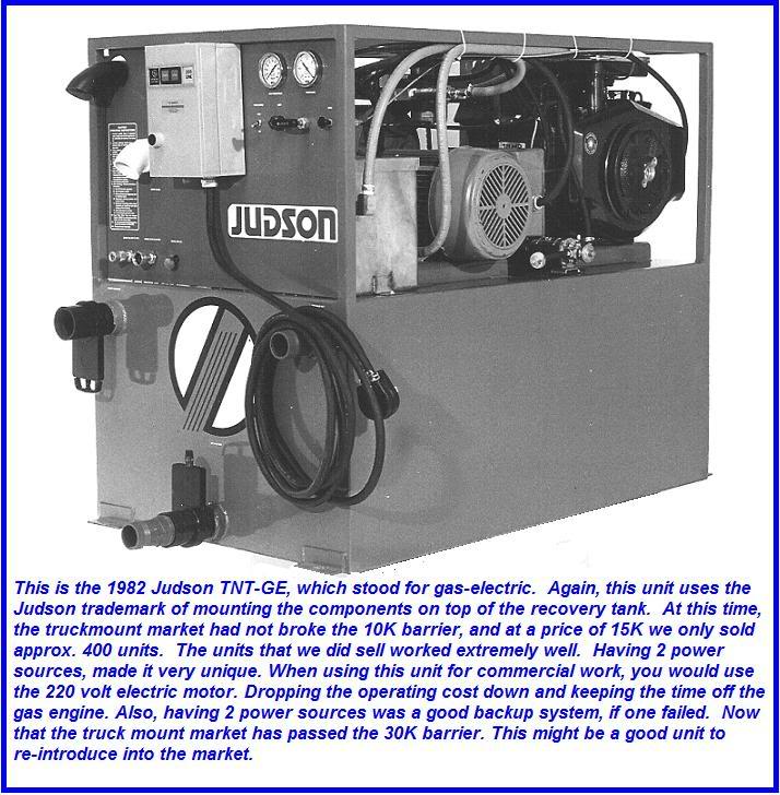

I love my Savage TM. I choose it for different reasons than most as I do power it all with a 18 hp Vanguard.
help me out with that one, Bill
why an 18HP GAS motor for a 'lectromount?
is that 18HP driving a generator?
an 18HP motor will drive a pump and positive displacement blower.
what am I missing?
Yes, it's a generator.
I know it's hard for some to understand but the reasons are many. I will try to explain. My only option in Canada wasteland was a cleanco or prochem. Having worked on PC Everest I knew PC was way to complicated and I did not want a CDS. Waiting for special order parts and dealing with inept TM mechanics really sucks and would have killed me as a start-up. I did not want a machine with proprietary parts. I did not want a used gasoline TM. Looked into Judson, but too complicated to get one up here and would not have been cost effective. Lot's of heat was really important for our cold winters and cleaning cold damp basements. I watched to many of my friend go out of business with used TMs, or complicated TMs. One company was forced to go total VLM when they could not afford to keep their 2 steamway machines running. They were spending $600 per month and way to much down time. TM breakdowns really suck when you cleaning in sub zero weather. Winter brings out all problems.
I picked up a good deal on a used Savage and then decided I wanted to have the flexibility of using gas or plugging in at the job. I bought a kick ass Voltmaster generator (BTW the best IMHO and got a sweet deal on it) so it runs at just a little over half load. The Vangaurd doesn't even notice the 40 amp load so I think I will get long life out of it. I have seen these Voltmasters in the oil fields running continuously for 4000 to 6000 hours. The since the 18 HP genset runs so sweet on such a light load and only sips .75 gph, I just always use it. My favorite electric configuration is 2 big vac motors at the truck. I could use a low amp 500-600 psi pump like Bob now sells as an option and run it all on two chords, but for now I want to change over to a more reliable General 1500 psi pump and keep using the generator. If gas every sky rockets again, I always have the option to run on two chords or if wasn't so lazy when doing all day job.
Personally, for my one man show with very limited start-up capital I prefer my simple, easy to fix configuration over a crappy, lousy heat, sub quality, bargain machine with a 33 or 36 blower and bad plumbing. If I bought a gas powered TM, I would go for a bigger blower and motor. My Savage puts out way more heat than a PC Everest (and no over heating issues that plaques the PC) which is the only other TM I have worked with. At 150 ft and under, I can clean with the same speed as with the Everest. Actually truth be told, a little faster with the edge on heat. I run a Greenhorn 14" wand with a holed glide and get equal dry times to the Everest, both using 2" hose. Hard to believe I know, but it's the truth. Also, I don't do commercial so I really have no need for long hose runs.

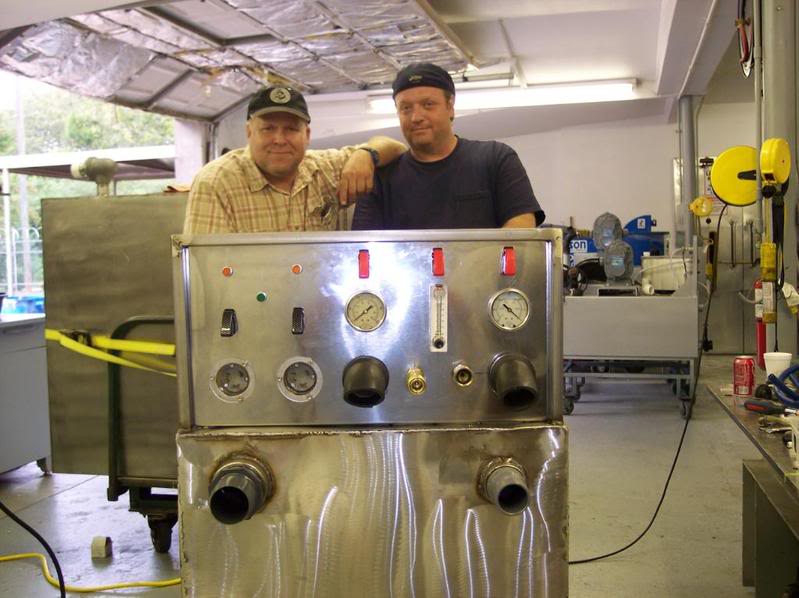

May 12, 2007
2,242
When Terry came to Greenville, and we finally built the prototype the system had already been in beta testing for two years. The conversion system that we used was developed in1982 to power our truckmount that consisted of an electric motor and a gasoline engine all on one unit. Terry and I do not want to give away the absolute secret to the unit. What is indicated on that 110 power cord is actual 8.8 amps. What really happened here is that we just combined Terry’s ideas with ours.

My thoughts are, "if" Bill is burning the fuel to run an 18HP genset, the luster of a lectromount is lost on me...
(Given the space, weight and fuel used to run an 18HP genset)
what am I missing???
..L.T.A.[/quote]
Its called a "BI-TM" there meat. It can go either way.
Hey who runs a bi-tm?[/quote]
I prefer to call it a hybrid. You can transfer as much energy to the customers grid as is convenient for you. All, a portion or nothing.
