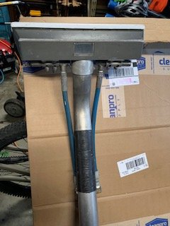

If you don’t want a swivel, just get a prochem titanium with a single lip glide to go on the rear lip. When I used my quad, I tested the performance of it without a glide, a single lip, and a full slotted.
it extracted the most water without a glide, but put the most abuse on my body.
the single lip gave both good extraction and wasn’t as hard on the body
And the slotted glide was the most forgiving, yet had the longest dry time.
