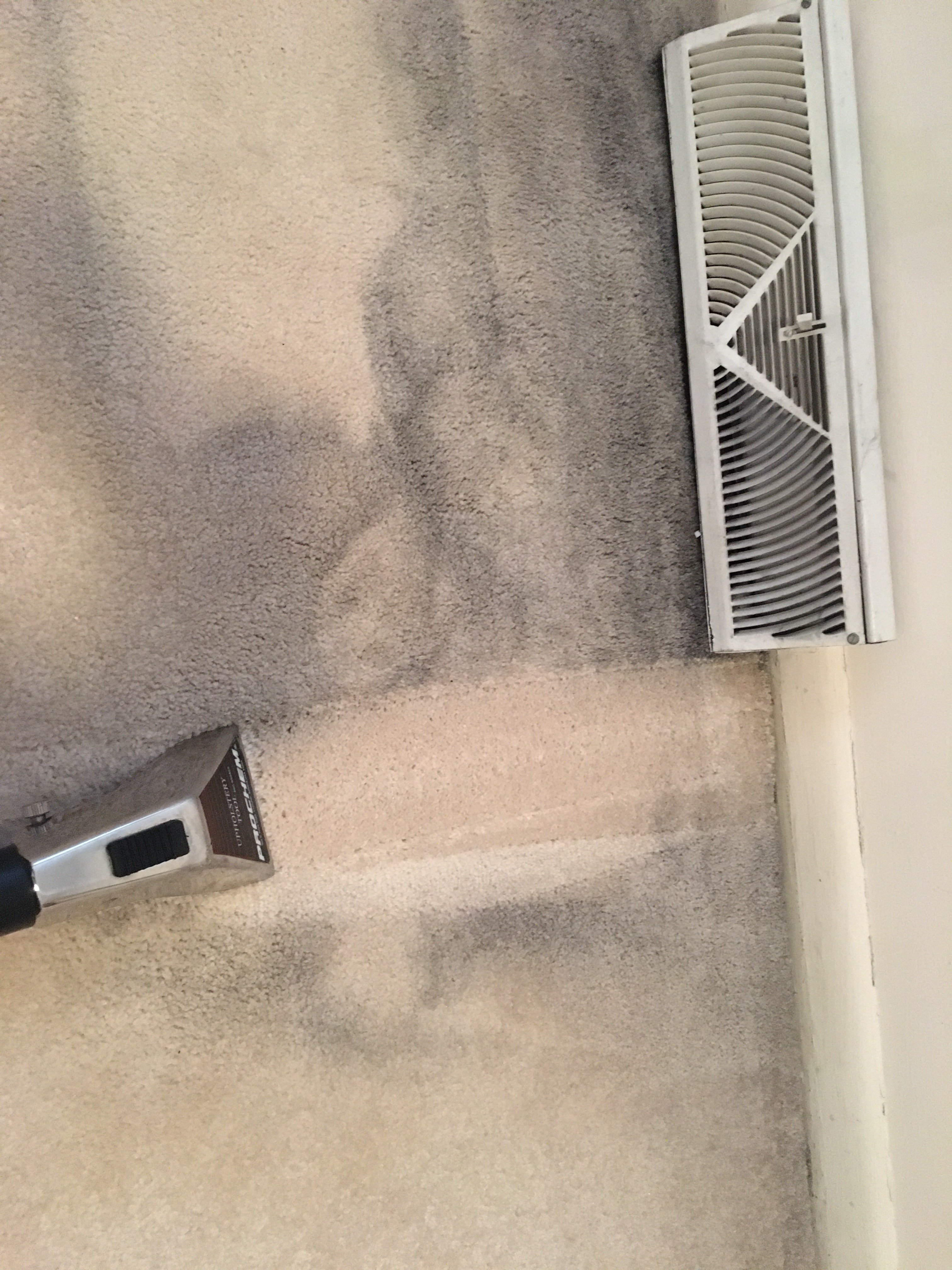

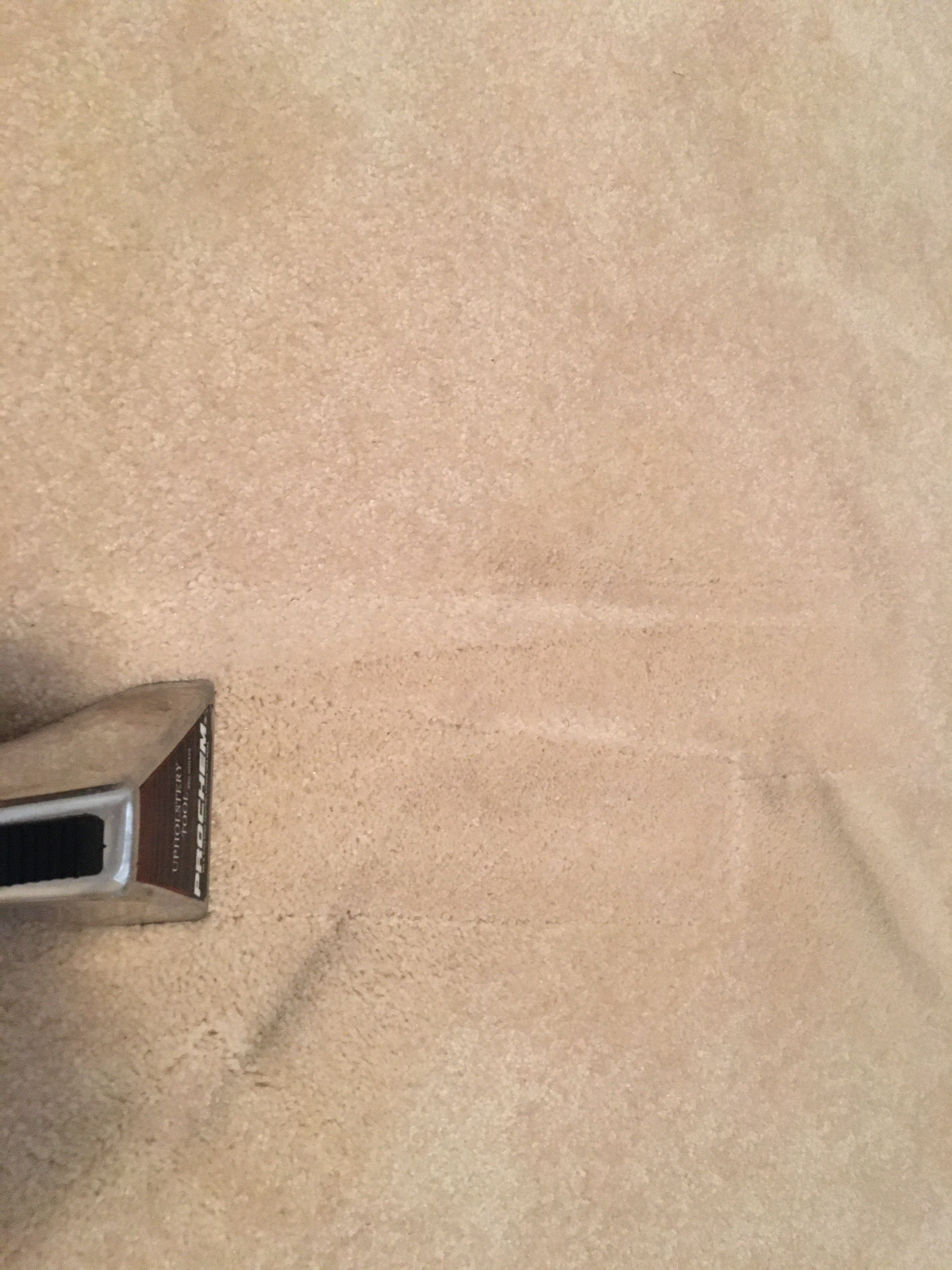

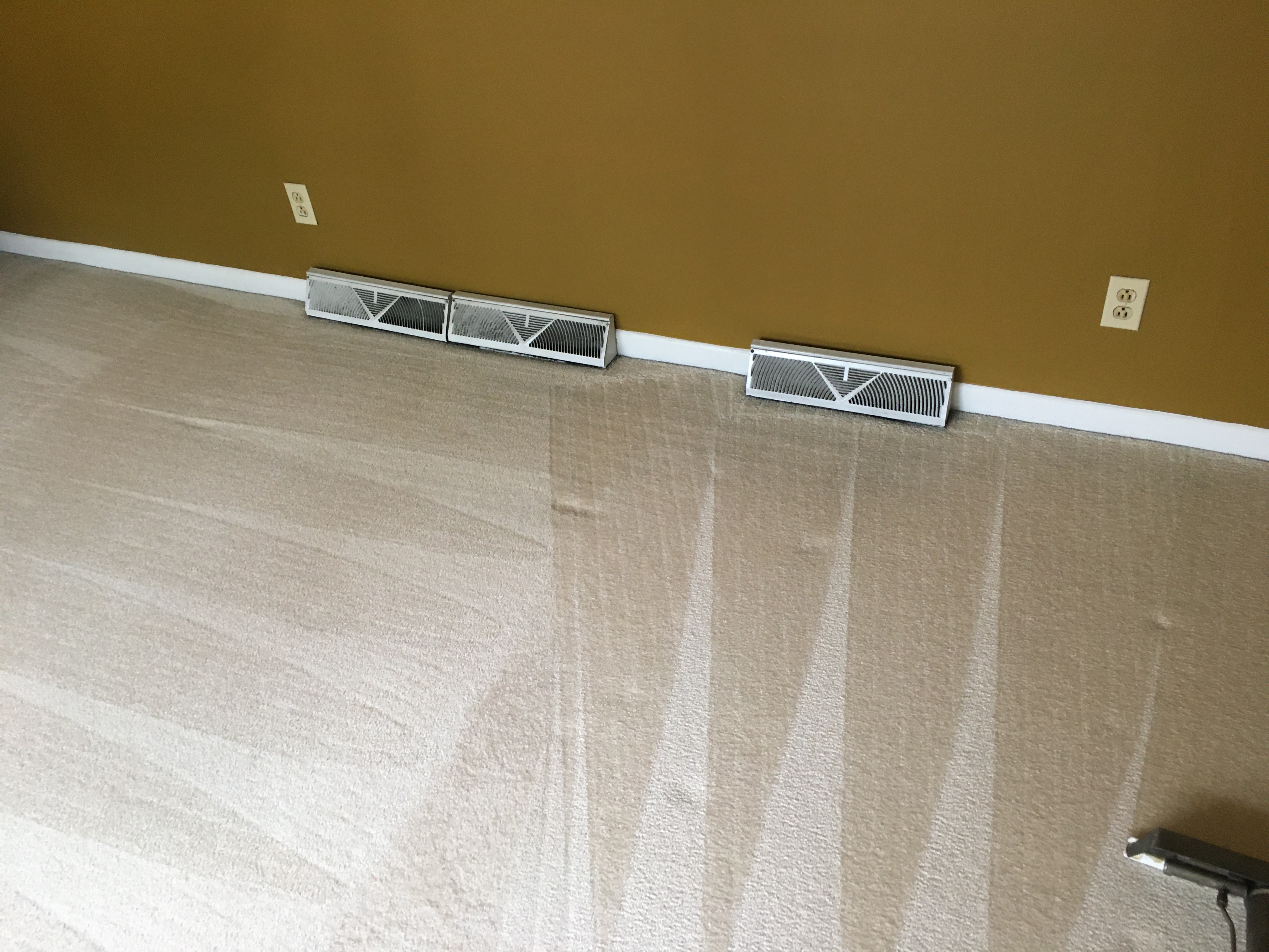

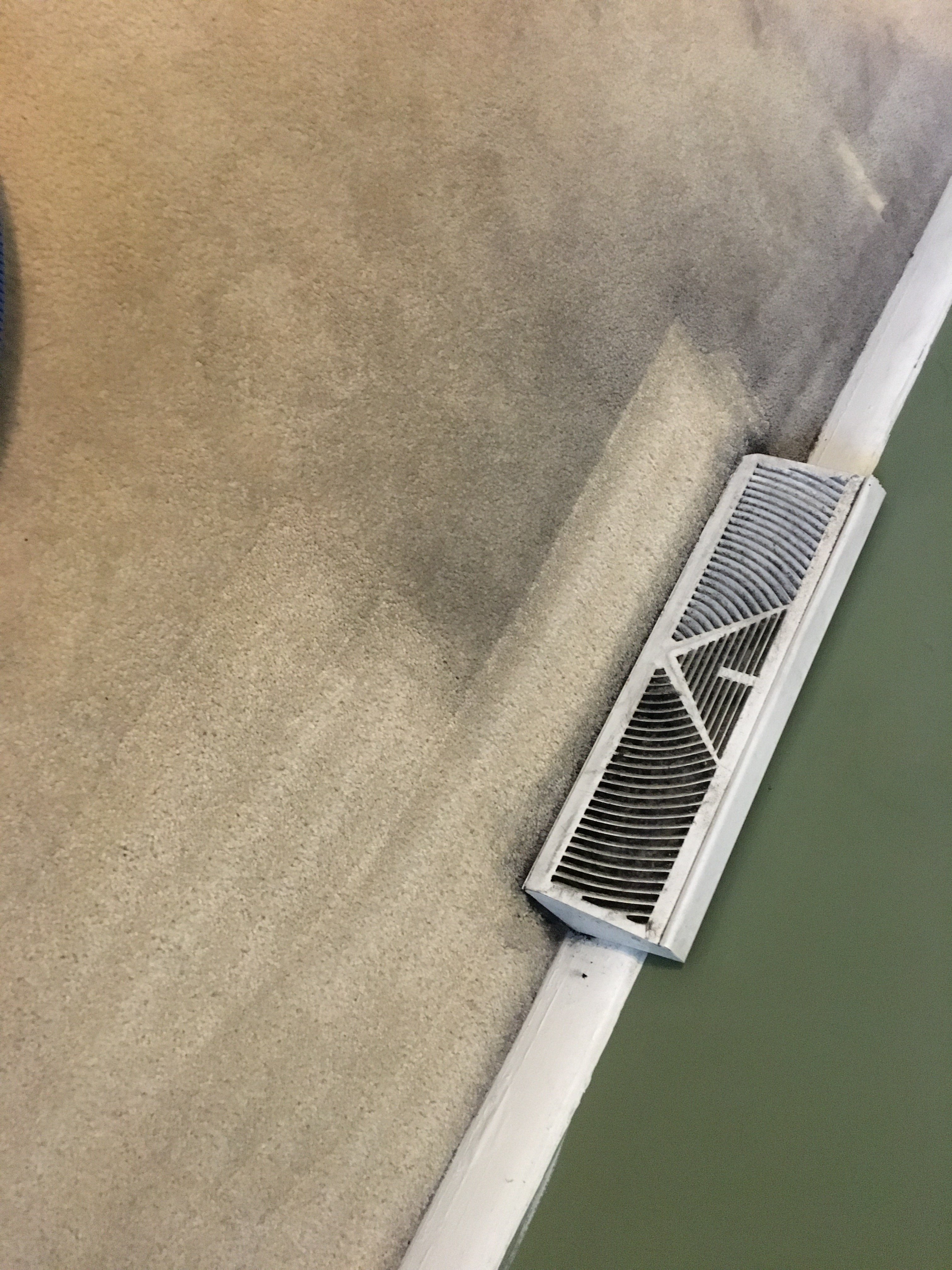

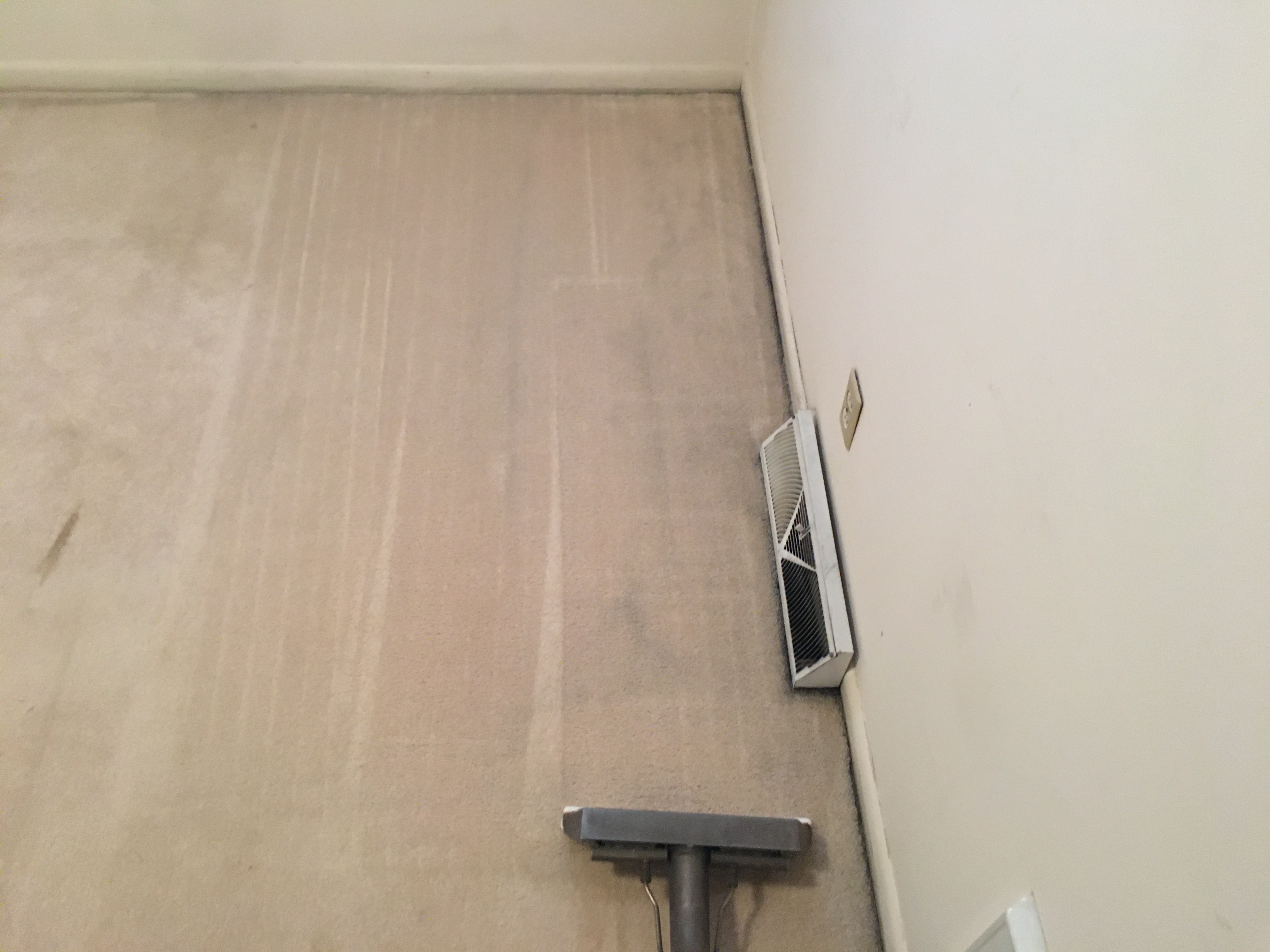

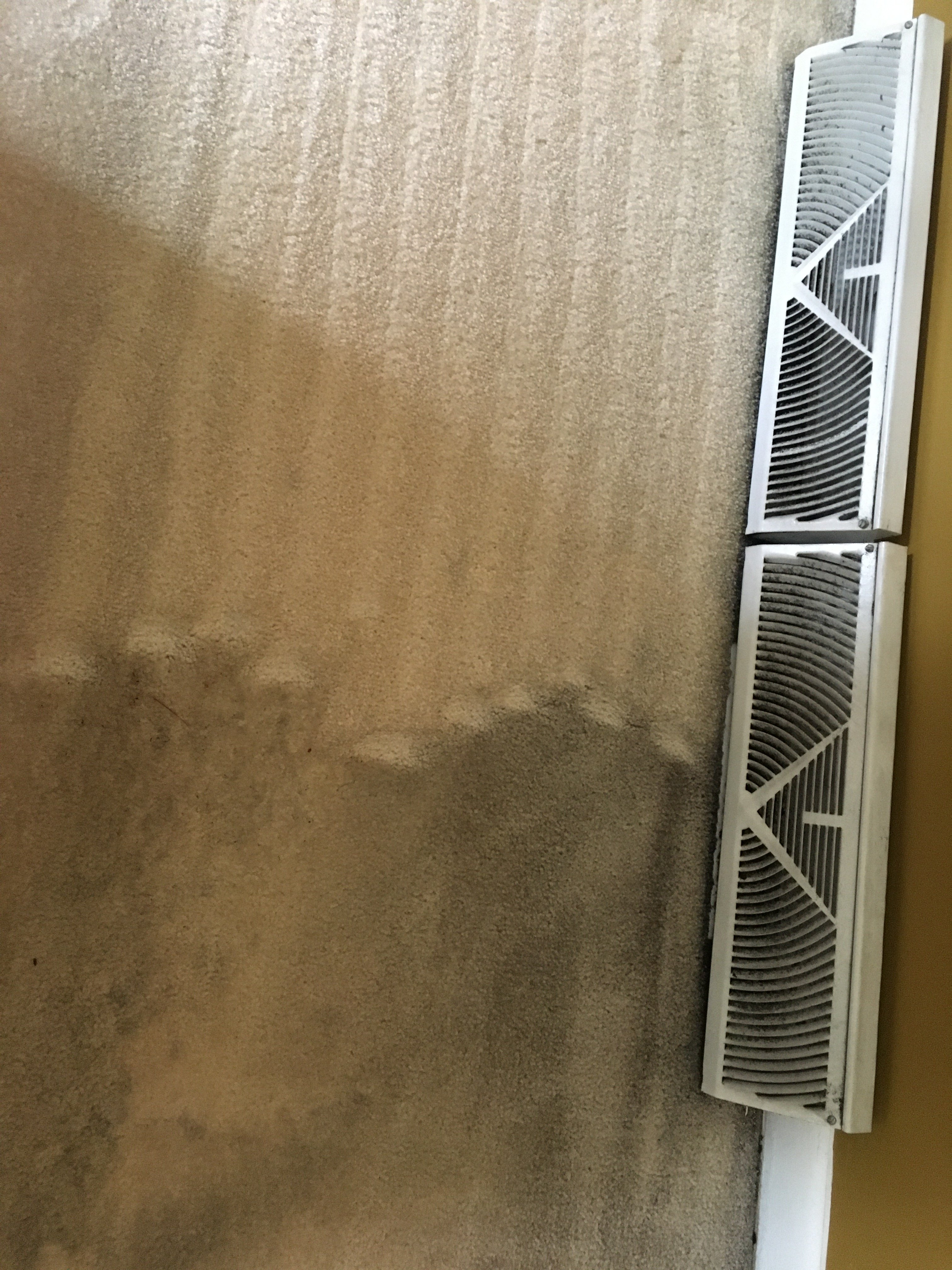

I’m very pleased with Prochem ultrapac renovate
It didn’t come out perfect, but it was presentable
