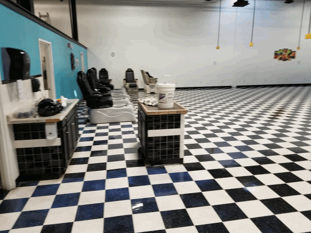

No fans, the exposed HVAC is filthy dusty..
DAT
Apr 3, 2017
6,487
Bill Cheryl
Thats rough... makes me tired looking at that.. be nice to have the propane stripper and autoscrubber... Be done quicker..
