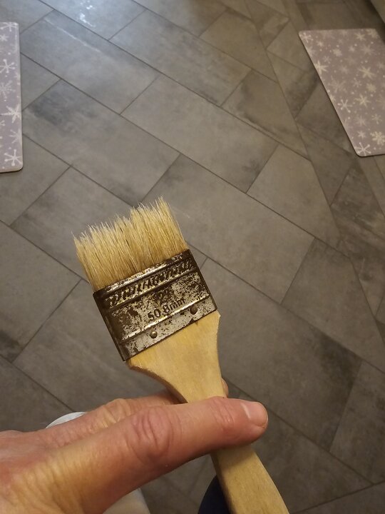

Just hwe a restaurant that juses vlm clogged the shit outa my filer box with this sawdust looking shit 3 times!
Did you vacuum first?
I used a cheap paint brush to apply it. Its lighter today so I will apply it again.
Yes I should have put plastic under it. The porcelain tile wasnt installed well so Im not so concerned about it. I did pull it off the wood though.
I had 2 small spots that didnt come out so retreated.
This is the paint brush I use.
Oops. I typed the vacuum comment but didnt mean to post it. It sat in the que until I posted that follow up.

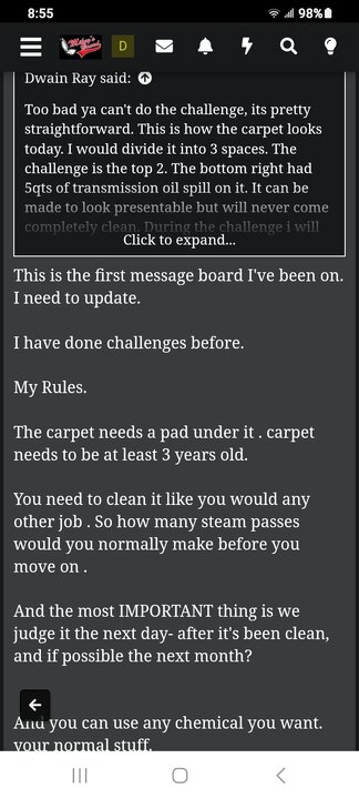

Dwain Ray
Jul 22, 2020
989

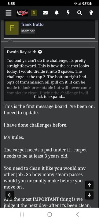

I said, Dwain. Would win if we played by his RULES.
I don't think anyone could BEAT him at his game in his shop!
I still don't understand what you mean "my rules" i simply said choose a side and clean it. you came up with all the rules had to be this ,had to do that etc. I just said out clean me on this carpet and take home the silver. You yourself came up with all sorts of rules and conditions. All i said was choose a side and clean it and ill clean the other cleanest side wins.
frank fratto
Jan 27, 2018
411
frank fratto
View attachment 133374 View attachment 133375
Dwain, you have the GOLD, YOU WIN! I Could not beat you!
YOU WIN!!!

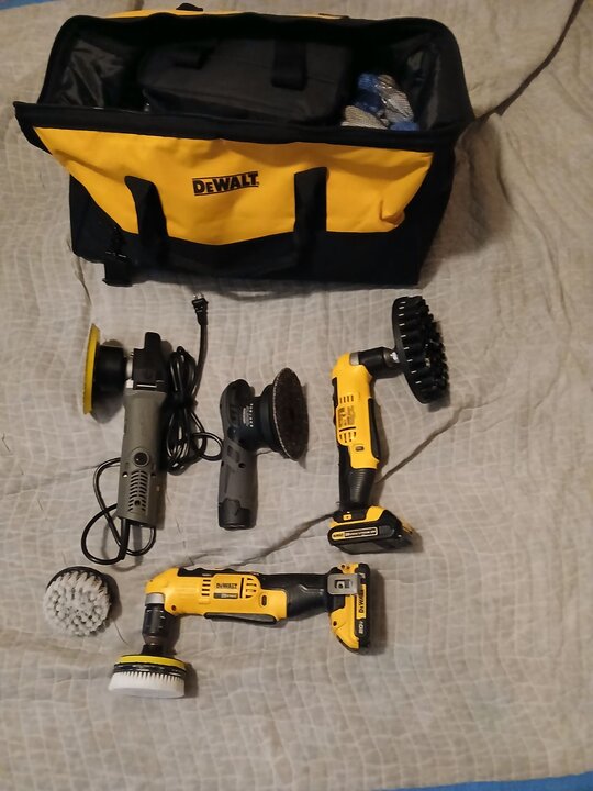

What tool are you guys using for vlm upholstery cleaning?
I mostly use orbitals
I have a 6'' electric and 6'' Battery
And I have that Bonnet Pro Rotary with 7'' Driver on Cordless DeWalt
The most important part of VLM Upholstery cleaning is the scrub. I have 2 brushes I use on Cordless DeWalt. One is very soft and the other is more aggressive
I use a Cordless Multi Sprayer to apply Detergent
And I have many 8'' Bonnets Microfiber and Cotton
George, that's a nice set up!!!
With a vacuum, that set up, is a HIGH profit
MONEY making Tools!!!

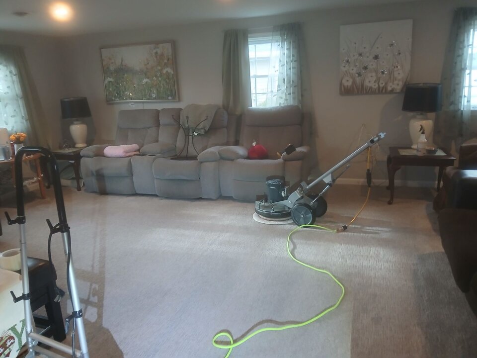

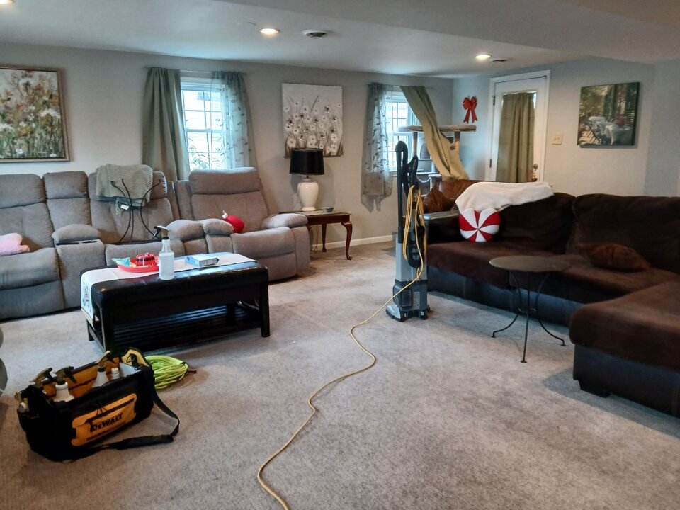

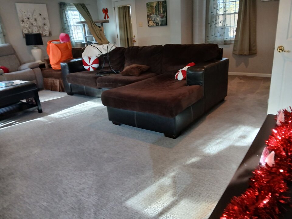

SteamwayPro
Apr 8, 2012
573
George
Now that it's cold the first thing I do is get a bucket heater in my cleaning solution and start to vacuum
I bring soft water to the job and just drop bucket heater into jug. That way I don't need to use or search for water at customers house
By the time I start to clean my cleaning solution is ready. I just want the water warm not too hot
Long time customer. That room is always a mess
Yesterday it had cat puke stains, soda spills, cat hair, and the daughter knocked over a white candle
I made sure I put in a picture of my Pro Team Vacuum for THEY LIVE 😀
That carpet is easy to vacuum so I used Pro Team
For Houses with People, VLM with 1-2 Hour Dry Times is BETTER than HWE !!!
