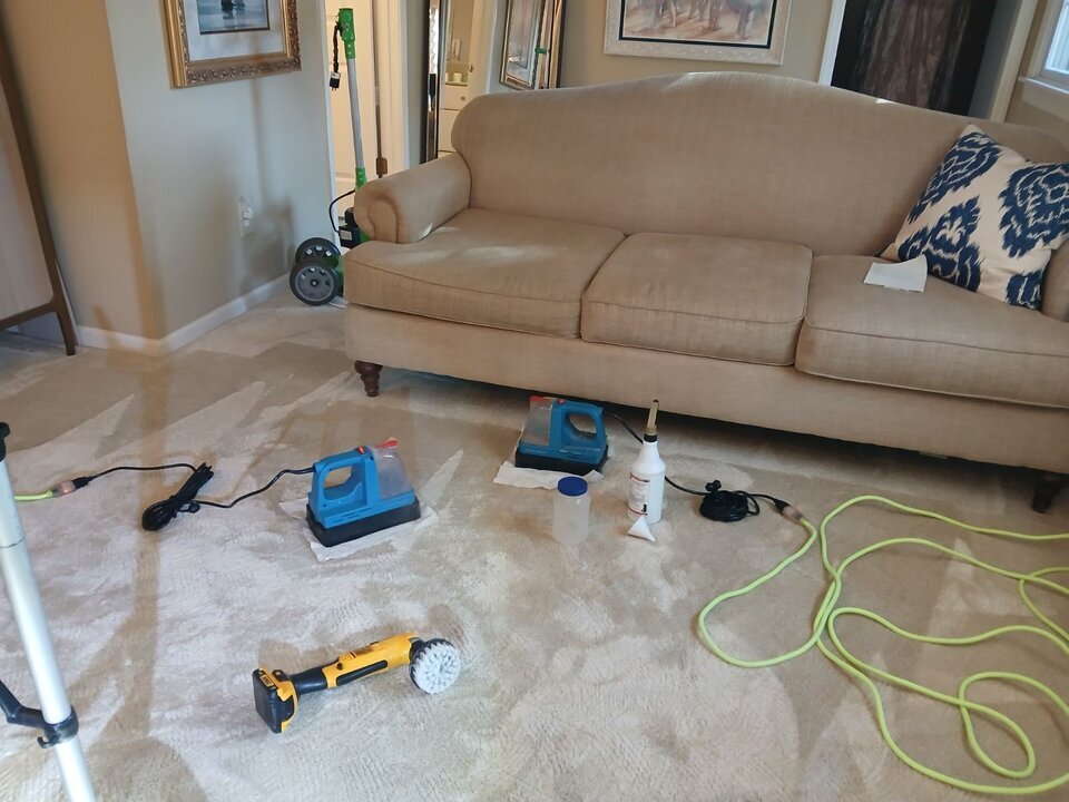

What is your process for removing candle wax?
I use a Namco Steamer to heat up and soften up and loosen the wax. Then use a drill brush or scraper to scrap wax off carpet
Never a problem getting wax off carpet but sometimes the red stain from red wax can be a problem
Need to use red stain remover for that but sometimes still very difficult to get the red out
I also have a Wagner Wall Paper Steamer, that can be used on wax or red stains, but it never gets out of my basement
Only problem with Namco Steamer is they don't last. They usually stop working after 2-3 years and yes I use distilled water in them
That is a picture of Namco Steamer removing Red Stains

I love that steamer

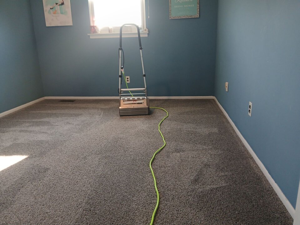

Frank
Do you use Bonnet Pro Ironman Bonnets on your 175 to extract
They're made for 175's but work on OP's. I only use them on nasty carpet. They really pull out dirt and grab carpet
I use a CRB to scrub. I guess you use a brush
What bonnets do you use
What vacuum do you use
Life is BETTER using the VLM Method !!!

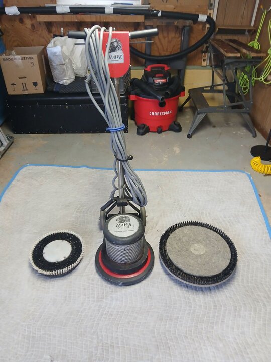

When I first started experimenting with VLM back in 2012 I used a 13'' Hawk 175-300 Rotary
I do a lot of Rentals so usually no customers around and that gave me a chance to work on the Method
I used a brush to scrub then Cotton Bonnet to extract
Have you ever tried Bonnet Pros Multi Brush. You can put a Fiber Pad or Bonnet in the middle
The biggest problem with rotaries are the small wheels. Not fun carrying them up and down stairs

Small wheels for sure!!
