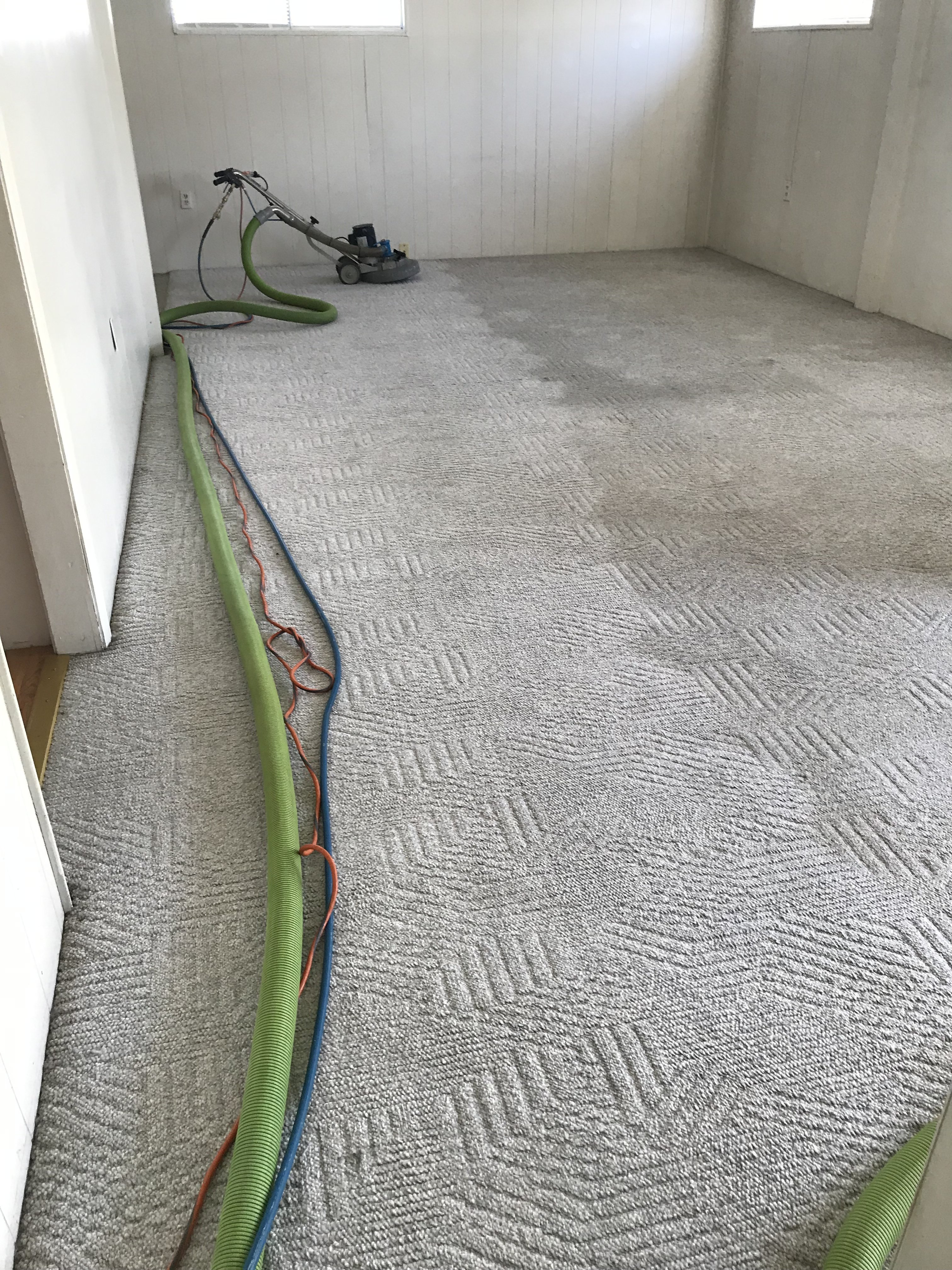

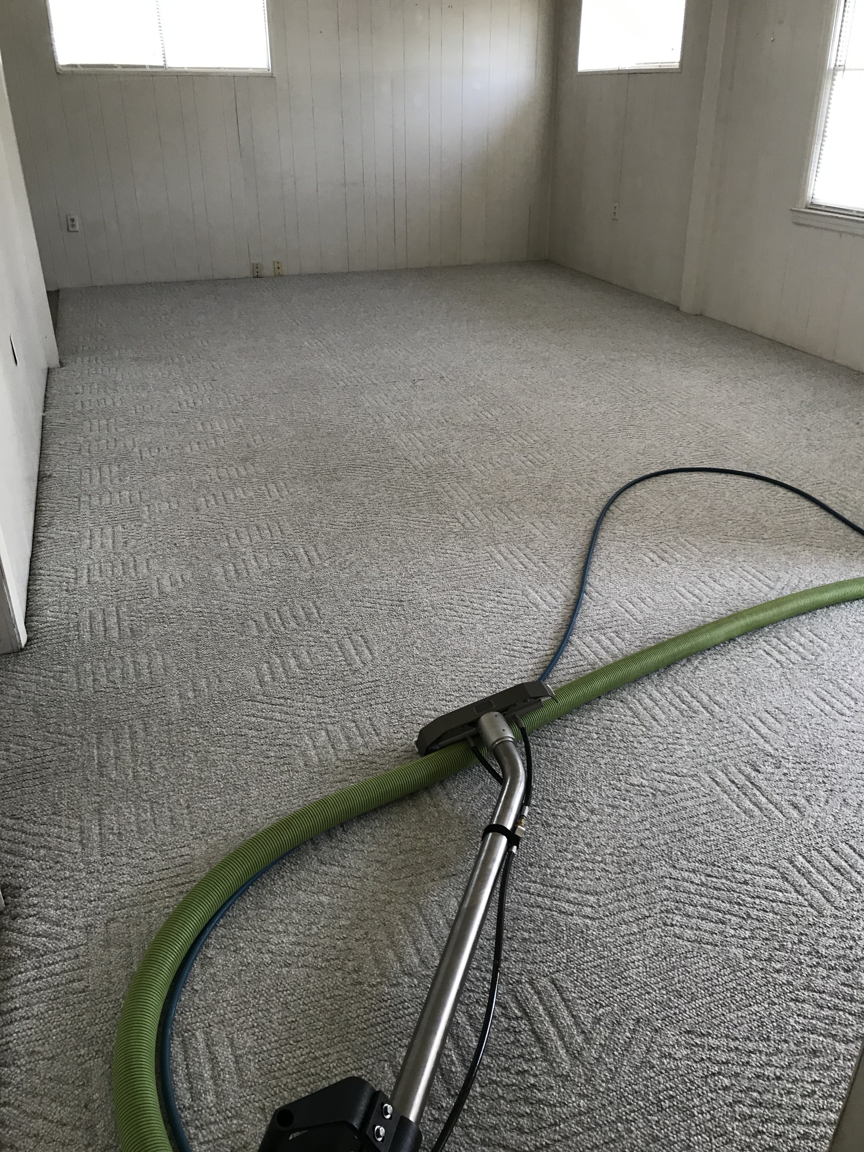

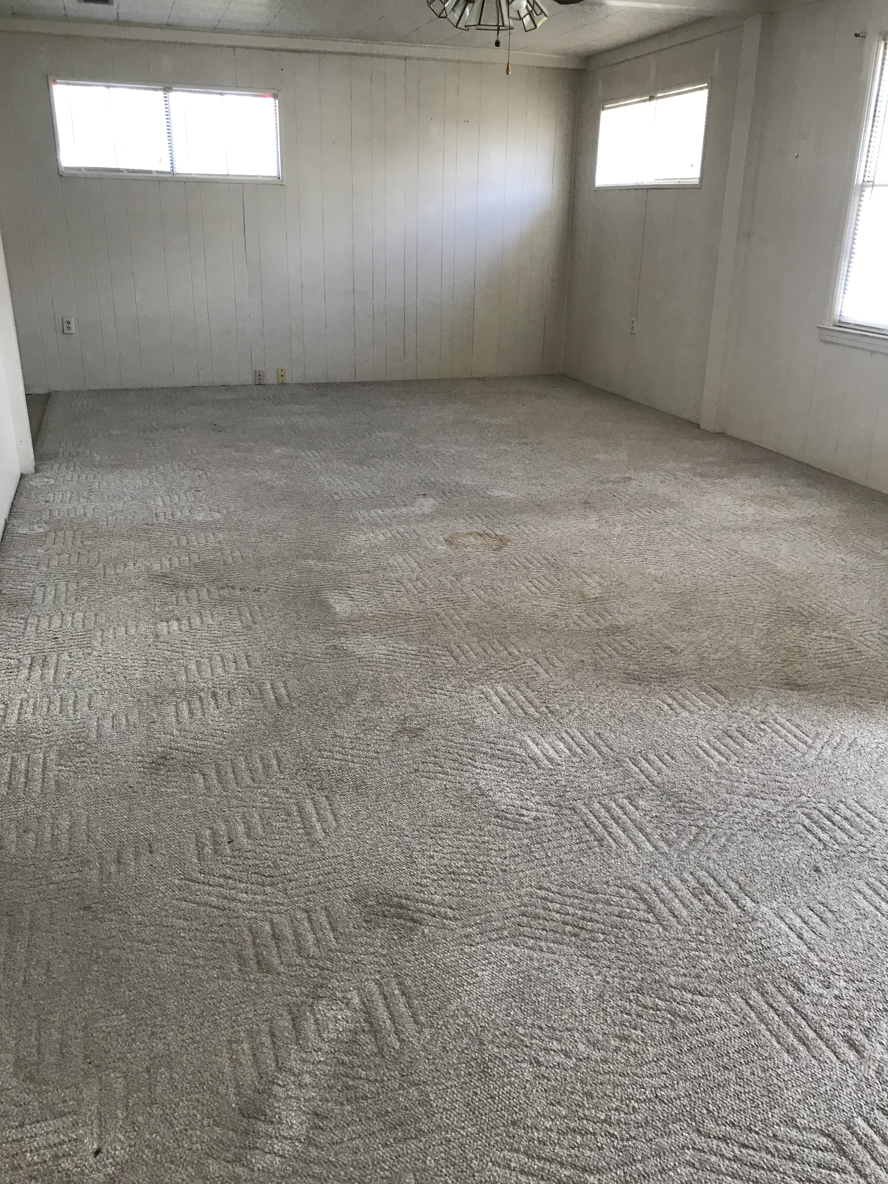

with some Code Red and a Rotary. It was a nail bitter....but no snags!!! Rinsed with Saigers also. I did this Monday and I’m positive it’s already trashed. This carpet is in a double wide trailer with a dirt driveway no walkway and no porch.

Me neither. I guess if something is lacking in your technique Berber will Rat you out, whereas cut pile will keep your secrets. Sometimes.
I think maybe because of the texture, some guys would wand too quickly or use a machine not powerful enough to extract everything. Soil will wick up and the carpet may brown. Taking your time and using the proper equipment will deliver results like yours.

the berber probs some have are due mostly to wand technique, not so much equipment .
The dudes that "saw" back and forth with keyed wand have the most troubles
