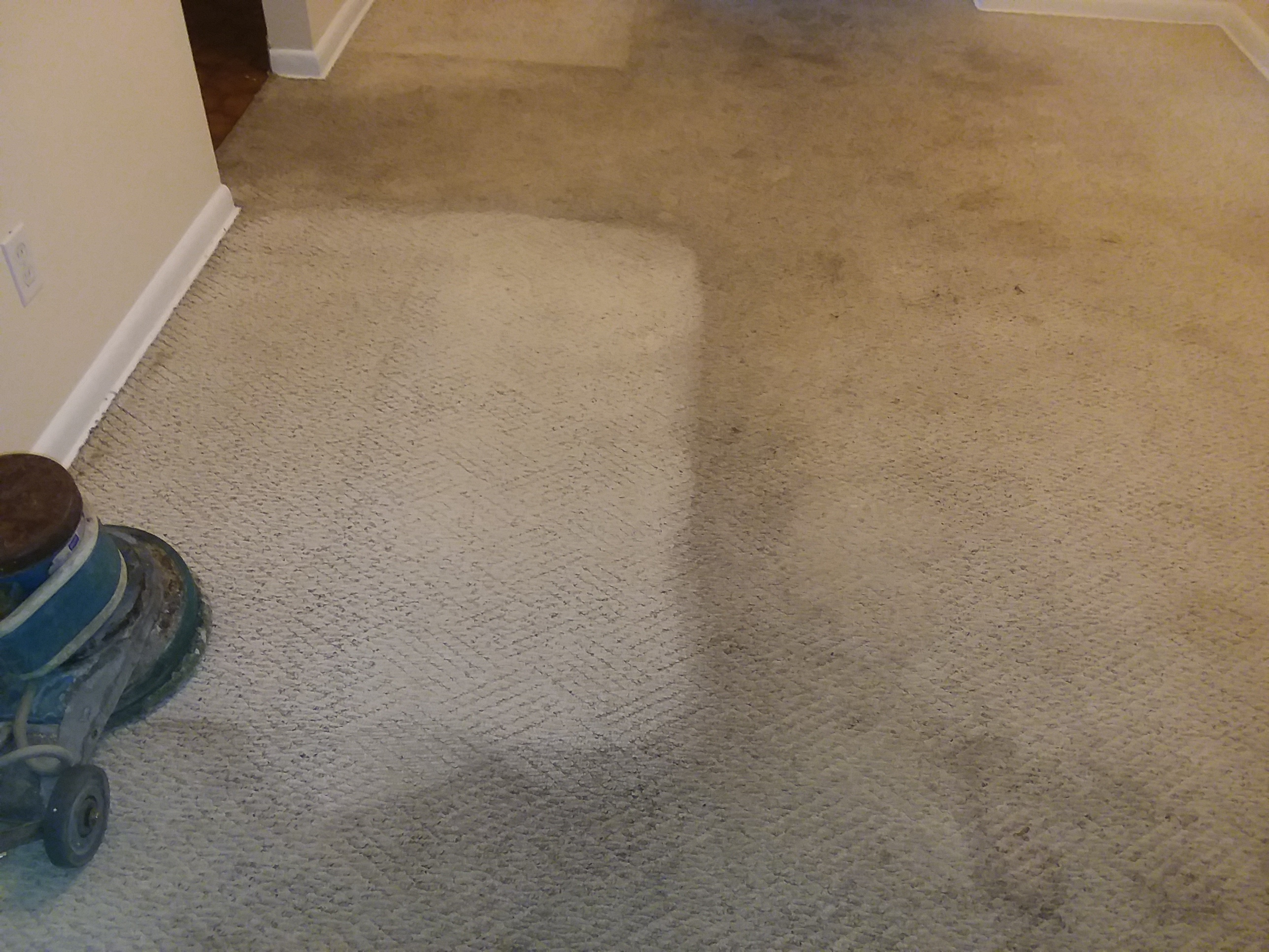

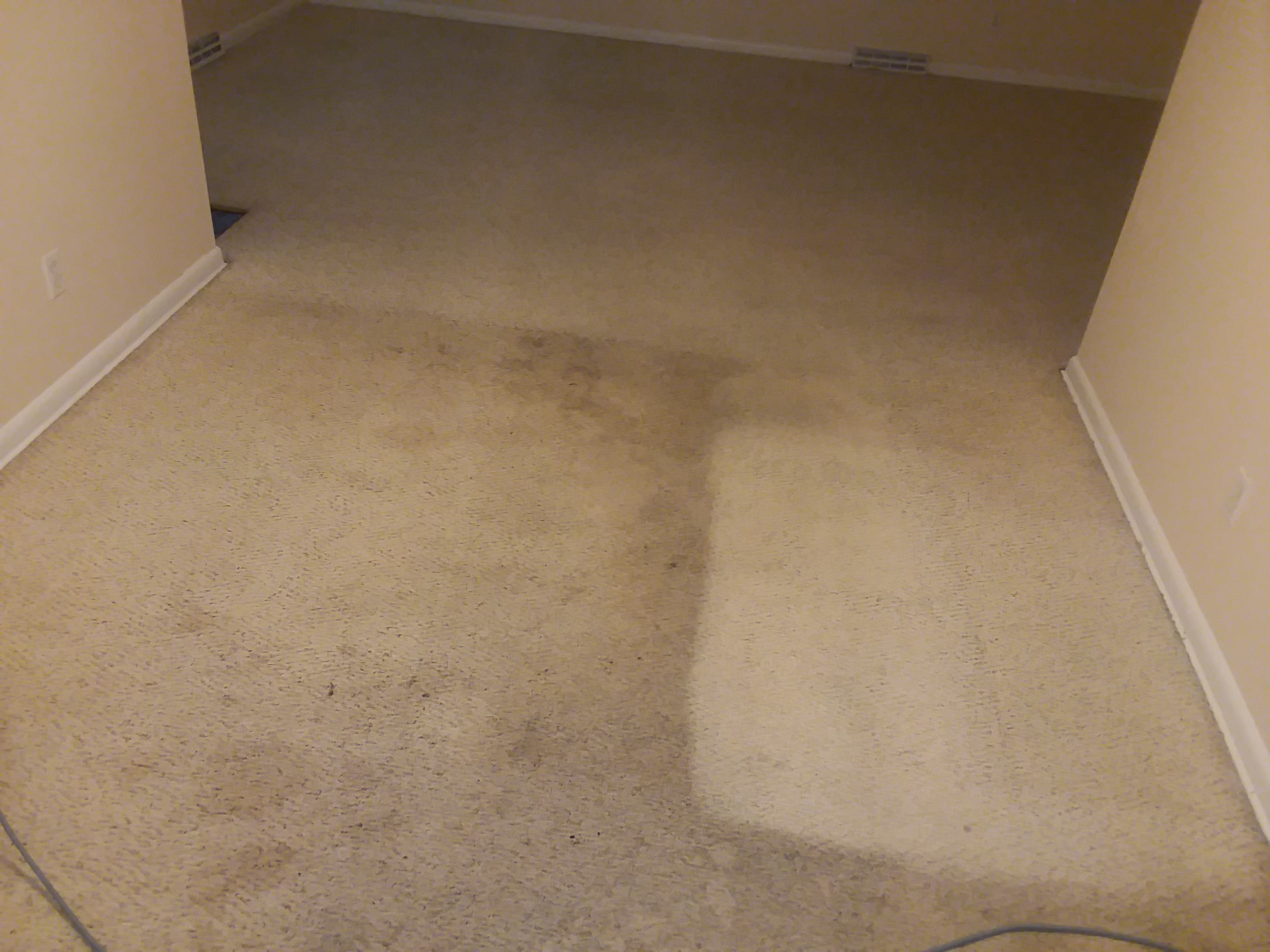

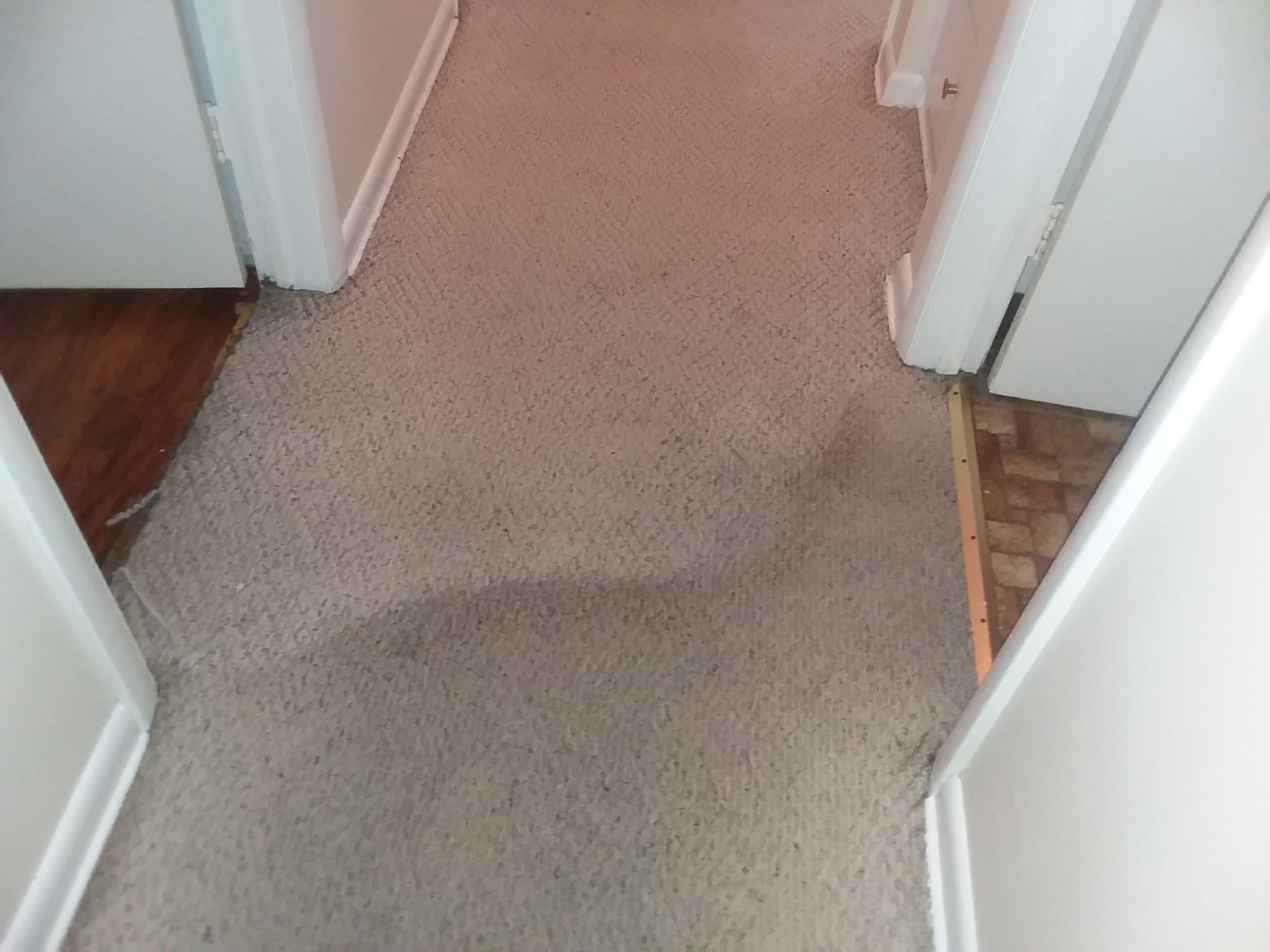

a while back... trashed--- rental of course.
around the time PB Extreeme came out and was getting the pub here, Scrubbed using extreme, stronger that directions 175 shouwer feed and green pad. So essentially I foamed it!! :biggrin:😛
These pics are of before extracting.
