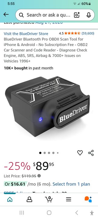

Do you have an engine analyzer? If so does it show live data? If not i recommend one of these blue drivers i have 3 (1 in each vehicle) their inexpensive because the expensive part of an analyzer is the computer and screen this uses the computing power and screen of your phone. you already own the expensive part. Anyway you need to see the live data for the o2 sensors on the lean bank you may not even have a vacuum leak. My 08 ranger had lean codes for bank 1 turned out to be catalytic converter
Thanks for the recommendation Dwain. I'll grab one of those. I'll be doing more and more of my own eepair work for now so it will certainly prove handy. I imagine the money and time it saves me in not throwing too many random parts at it will be more than worthwhile. Thanks man!
For an all around analyzer you can't beat the blue driver there's cheaper imitations but they don't have great customer support or lifetime free software updates. The only criticism I have is that it doesn't do transmission temperature which is what I require for changing the transmission fluid in my new Toyota. For that ill invest in another analyzer for the shop . If you're like me and carry iton the truck. I highly recommend that you popthe extra for a carrying case you won't be sorry
