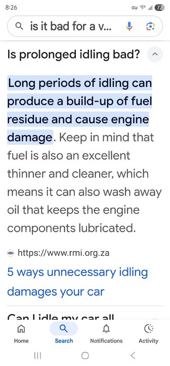

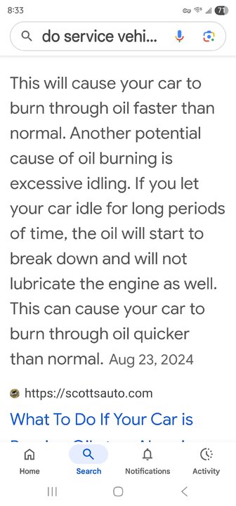

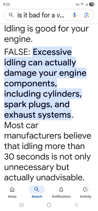

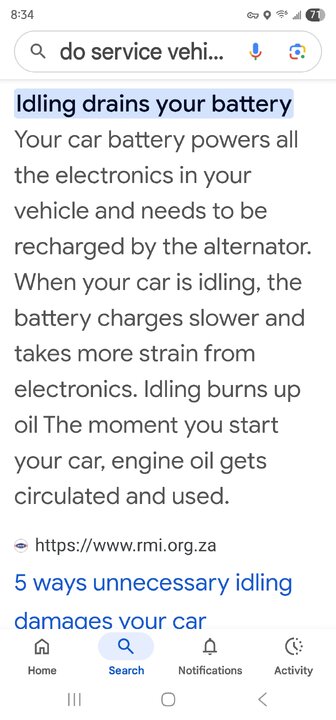

You know i keep hearing that idleing wearing out engines but emergency vehicles like ambulances fire trucks forestry trucks and police vehicles all idle for long periods????? All my pto's idle for long periods . Unless im fueling or in a store or something i generally start um in the morning and shut um down when i get home . my old 93 ford has 246k and 11k hours on the machine. My backup van has 216k and 10,563 on the machine. So i call BS on that theory as for putting a larger alternator on your van i say ,why??? An alternator only puts out power needed so if you only need 10a to keep your system topped off thats all your alternator will provide regardless of its capabilities. Newer vans like mine its a 2020 it has a circuit that cuts the alternator off till the charge runs down then activates to charge for awhile. Took some time getting use to seeing tha volt meter fluctuate that much .
Well apparently google says prolong idle can cause damage. But i haven't experienced any so i will continue but if you ask google " does prolonged idling of modern engines cause damage" theres some good reading there .as for me its still business as usual. I think starting and stopping causes more harm than left running

I think alot of the information about idleing is propaganda and is there to push an agenda 30 seconds???? They don't want you to disengage the start stop on new cars the autos ecm is monitoring and adjusting fuel trims hundreds of times a second also adjusting cam angle timing spark duration etc etc also temperature of engine is controlled by the thermostat so unless your idleing during a blizzard it got it under control. So i say get your covid shot its good for you and the world it is good because we, the one's in control say it is and save gas don't idle your car

Fuel is atomized and not a liquid in most vehicles direct injection is the exception. But vans with pto's don't have direct injection yet and they have found that vehicles that only have direct injection well they have all sorts of problems just staying in good running shape period. They have serious carbon issues because the fuel bypasses the intake valve making oil vapors that pass thru your pcv valve into the intake stick and cause severe carbon buildup on the intake valves where port/manifold injection doesn't have that problem. Because the injector is aimed at the intake valve and keeps it clean. Manufacturers are addressing there screw up/this problem by quietly implementing duel fuel systems port/manifold injection for idle/ low power use and the ecm switches to direct injection for higher power requirements. This way they can produce the power while meeting emissions standards and solving the carbon issue they themselves caused. So i believe that alot of the idling controversy stems from direct injected engines . But in my opinion if you have an engine solely direct injected , well your just f%$@ed no matter what you do. And my advice is get a lemon law attorney and put um on speed dial. As for duel fuel injection ill let you know i just bought a 23 Toyota tacoma and it has it . The first thing i put on it was an oil catch can just in case
I agree the manufacturers have an agenda to push.
Idling creates higher emissions per rev. Im not sure vehicles still have them or not but EGR valves and cat converters plug up faster from idling too.
The service vehicles you mentioned do get serviced more frequently due to the idling. I think the oil changes are every 1500 miles instead of 3000.
If you had vehicles that idle a lot you might remember replacing batteries and alternators and wondering what killed them
When people started putting amps in their cars they started killing their charging systems too. Now they use multiple batteries and two bigger alternators to prevent the damage.
Your coolant pump doesn't pump efficiently at idle. Think of how cars would die on highways when they came to a stop. The motor was still hot but couldn't cool it fast enough because of tge pump doesn't circulate it fast enough. Its not just the numbers like thermostats kicking in at at a certain temp.
Just because it kicks in at 210 doesn't mean the engines temp is 210. Numbers are deceptive. Or as I say numbers lie.
