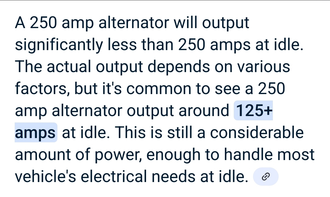

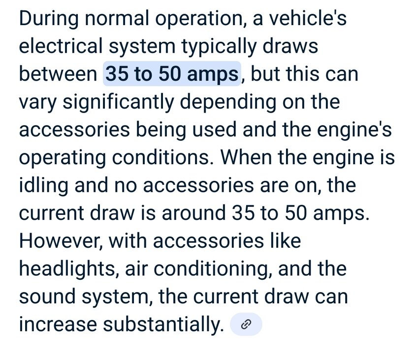

Do you mean it has a 250 amp alternator? Tell us what the actual amperage output at idle is. 250 amp alternators put out around 125 amps at idle, and your vehicle is consuming about 50 of those amps while running........
Why are you so hung up on a huge alternator??? You gunna power up the ho
I'm always concerned when I see motor oil getting significantly darker. If it is high quality synthetic oil and you're only 3k in since the last oil change but the oil is quite dark compared to new... still fine to wait until 5k to change it?
Oil changes color partly as a chemical reaction to the detergents and additives working more than being dirty
Screenshot_20250806_193825_Google.jpg Screenshot_20250806_193834_Google.jpg Screenshot_20250806_193850_Google.jpg

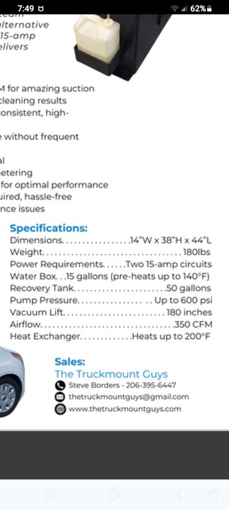

Regarding this Hydroclean electric tm? If he's not running a generator, or plugging into shore power from a home or business.. the power to run electric vacuums, pumps, and more has to come from somewhere.

A 400 amp alternator with a small pulley will you give you the most rotations and output at idle. With a small pulley that could produce about 250 amps at idle, and produce about the same vacuum and psi of my Hydramaster PEX 500 portable. But then 120 feet of vacuum line creates a loss.
Unless I missed something he is planning on powering the vacuum and pressure from the van, electrically.
Dwain Ray
Jul 22, 2020
1,100
I don't know anything about that machine except what the information sheet says and it says it requires 2-15a home circuits in addition to the van so im assuming that its a portable mounted in a van and possibly using some sort of a heat exchanger

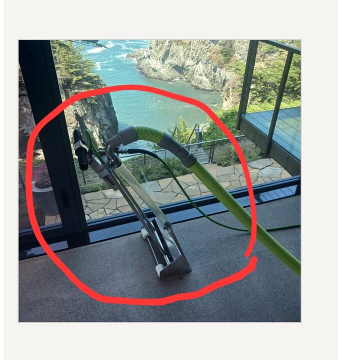

I used to ride on the front to get some weight on it for my father for floodwork. Seemed to work great though he had a 45lb donut weight if I wasn't there. I was a lightweight kid but I am sure I was at least 100 lbs. Still has it in his back yard on the side of the house I think 🤣.
If it's a 24" i would be interested in buying it. I use a 16" normally and i have several. I have a 12" for for area rugs and5th wheel trailers and tiny houses. Ive been looking for a 24" for commercial jobs but they've proven to be elusive
