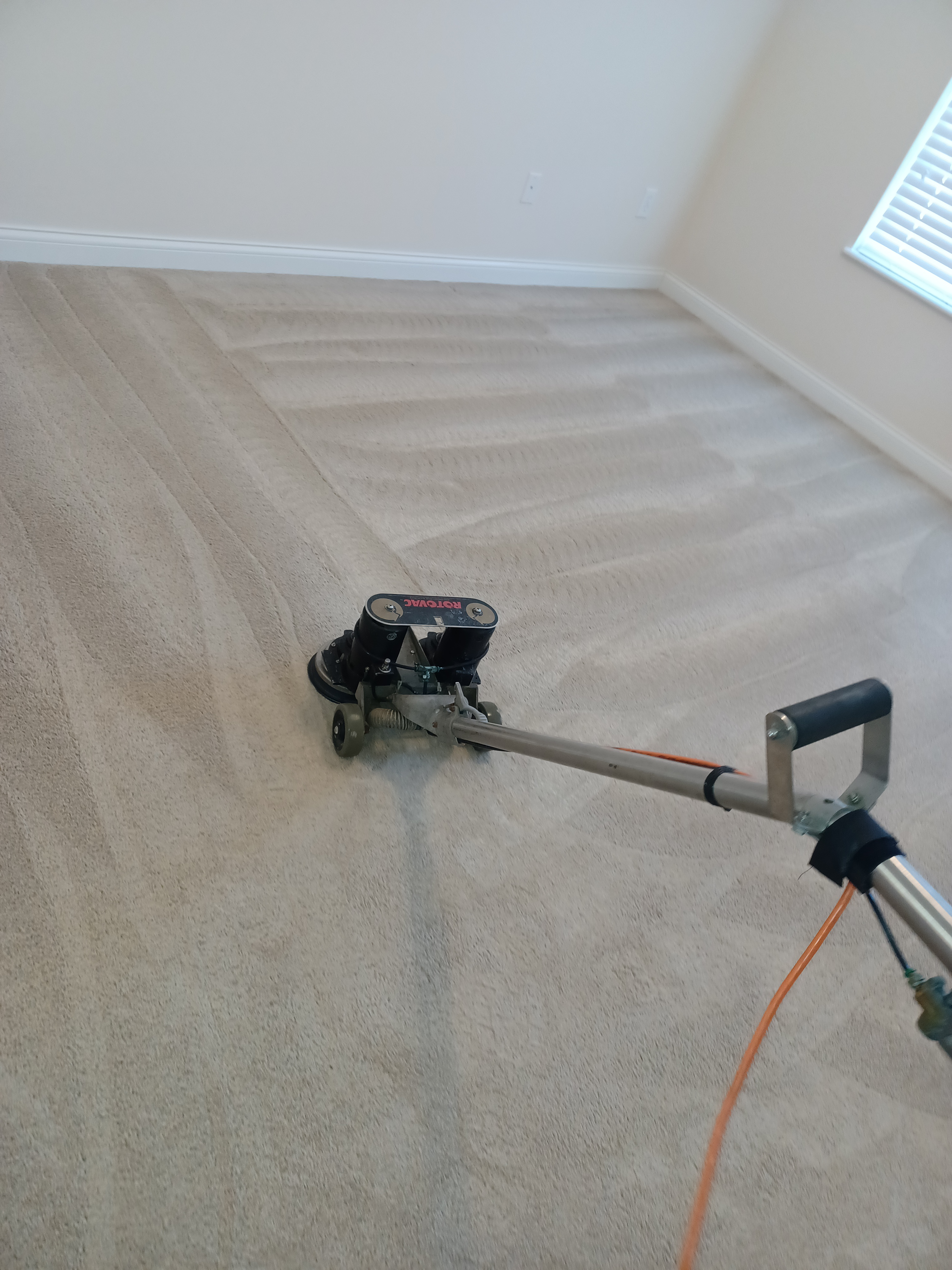

Vlm by definition means under 3 hour dry times.
This things pretty much guarantee 36 hours of suffering.
Noope!@@ I use less h2o. Who says you need to hold the trigger. Jeesh!!!!:stir:
Let the agitation do it's thing!
Low moisture on thick cut pile!!
Wheels turning?, light bulb moment?

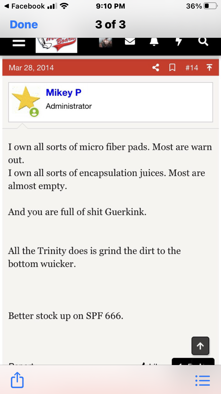

I get it! He does not "trust" encapsulation.
I used to clean a very busy Mexican Restaurant monthly, which in some places it was so black with grease that you did not know the color of the carpet. I usually OP'd and sprayed heavy and blew through a lot of pads, but is always came out. I purchased a CRB and wanted to test straight encap. I was astonished at how well it removed the grease, but I had to really load up on moisture and several passes to get the black areas out. I expected to have to come back to "fix" the problem the next day, but I was utterly surprised that it looked and felt great! I repeated it the next month, noting that resoiling was a bit faster than when I used pads. I used a CRB and repeated it the next month and it started resoiling faster than the first time around. I was astonished at how well encapsulation lived up to the hype, and it exceeded what I expected of it, for a greasy restaurant is not what it claims to work on. I returned to padding, and flushed it with HWE once a year as padcapping started to fail and resoil quickly in about 10 months. Flushing it with HWE meant that I had to return in the next few days to eliminate the streaks and wick-backs with Encap and Pads.

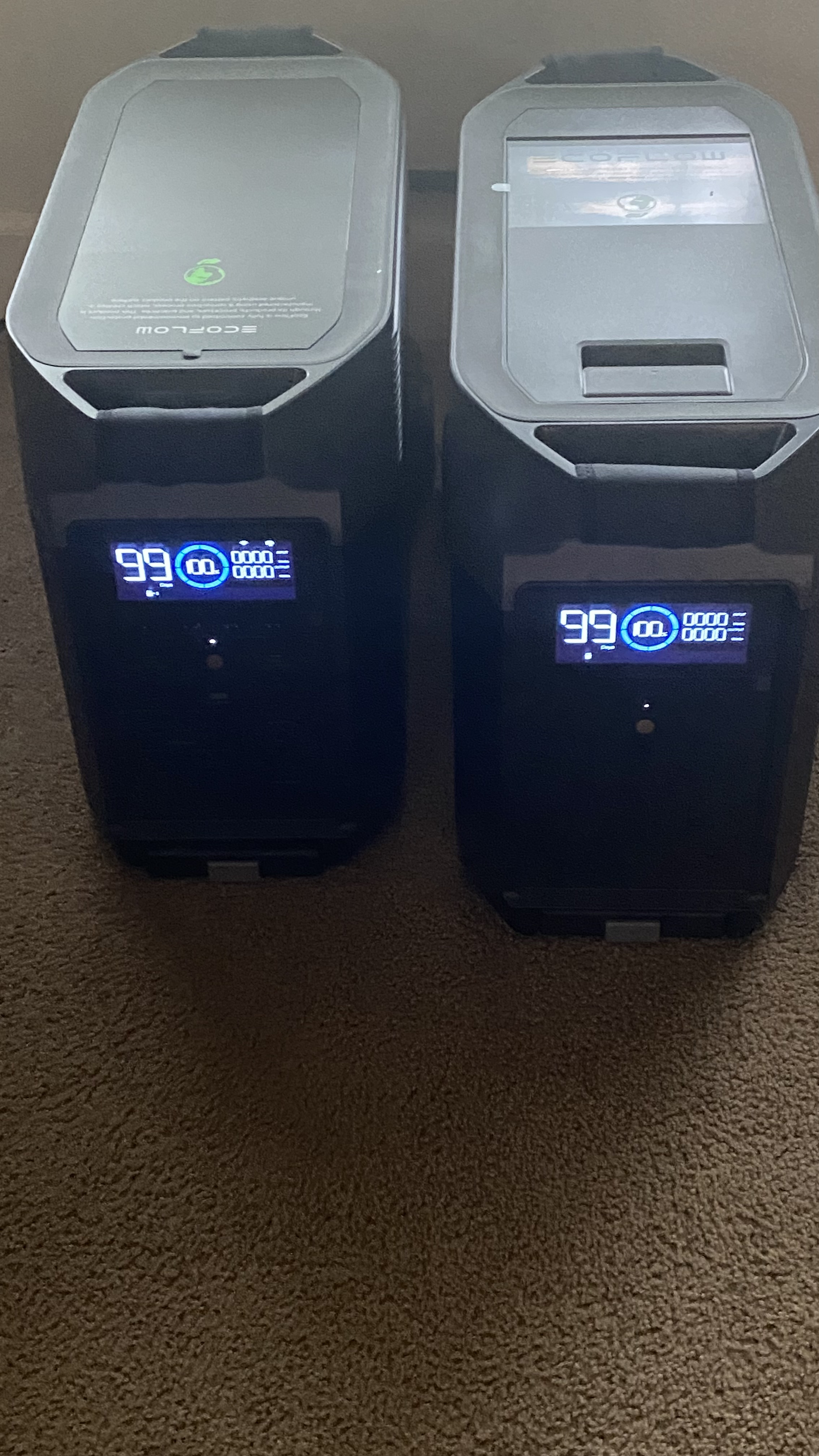

So, if you used one of these power units, how long could you run a Pad Machine on one charge? It could be a viable option in situations where power has been shut off.
I have something like 7.6kwh with that unit so probably all day if needed. Maybe more.
I might have this f'd up, but if you were using something like a Phoenix that draws 5.5 amps and 660 watts an hour. You would get approximately 37 minutes from a Yeti Goal Zero 400.
