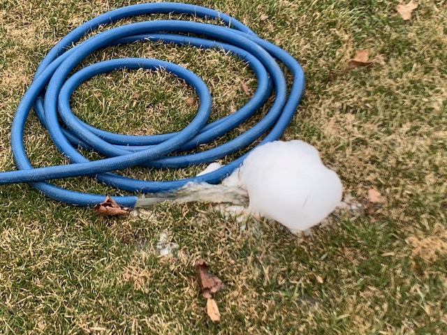

VLM removes soil as do all carpet cleaning methods. What I do need convincing on is what they leave behind.
The way I clean with HWE is very similar to washing your clothes. Wash cycle/Agitation/rinse cycle. Apply cleaning agent, CRB, rinse with water and groom. With the CRB doing most of the work, I can reduce the amount of cleaning agent and water pressure.
So when I clean for a repeat customer. At any point, I can remove the hose cuff off my wand and I will see just water inside the hose, extremely little or no white (cleaning agent).
Today I cleaned for a past customer that I used to clean annually. Last year she tried a VLM cleaner. She said it looked good at first but then kinda *dulled out*. When I started cleaning I noticed a slight reduction of suction, so I take off my cuff and see lots of white (cleaning agent) so much so in fact that from that point on I just presprayed water because there was enough cleaning agent in the carpet from the VLM that I just needed to activate it.
Pictures say a thousand words. Again, all I presprayed was plain, softened water.
Lots of VLM cleaners use the wrong products or too much or too high a dilution rate, just like many hwe cleaners. It's not necessarily the method, it's the cleaner.
