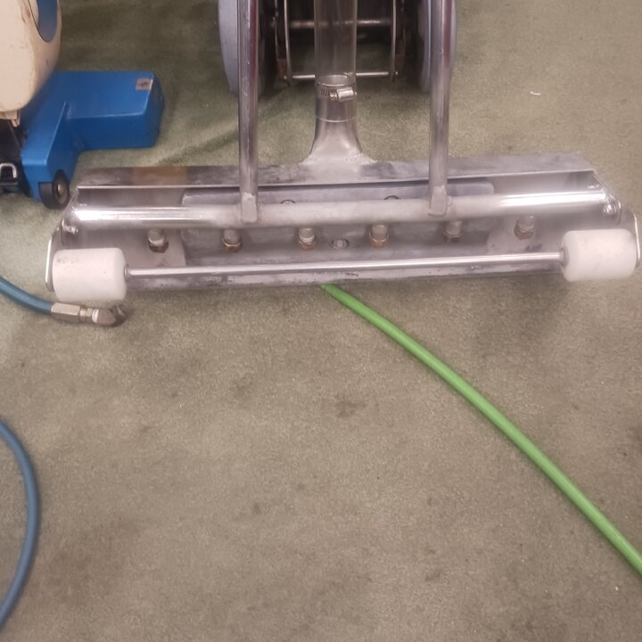

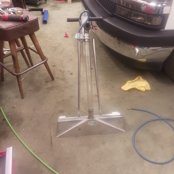

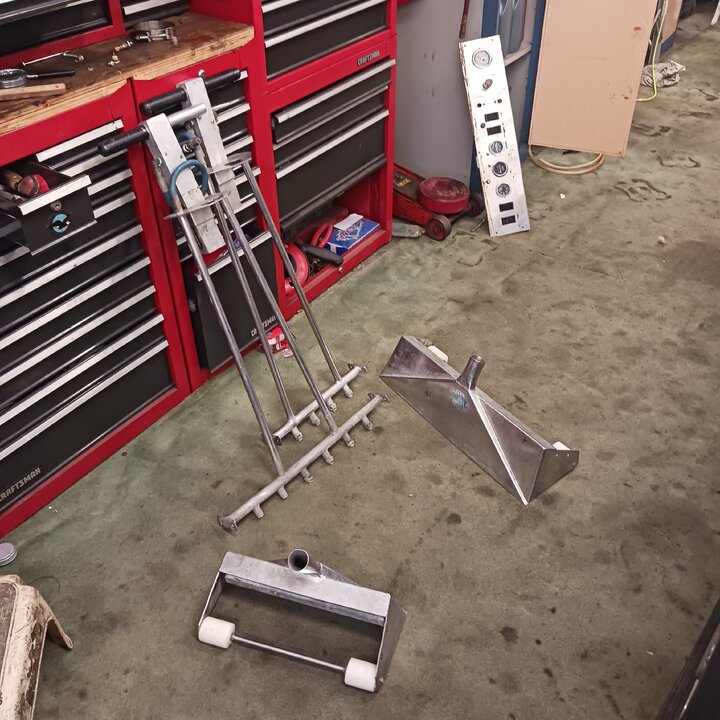

Funny you should ask i just did a bid for one kast week. Its not a senior home but alot of low income people with disabilities
Its 2 story and has halls approximately 175' long.i dont know if im going to do it though. I gave um my I don't wanta do it price @.60 per sgft they approved it but gave me a butt load of paperwork to become a vendor. Buried deep in the paperwork i read net30(or longer depending upon how payment is processed) i said that if i have to wait 30+ days to get paid i want 15% more so now its a wait . I sent the paperwork in and waiting for official confirmation. But ill stretch out hoses here and clean my regular way but i did finally go my hands on the perfect wand for rinsing and drying here just a week before. A 24" steamgeni drag wandthe original bid for this job was 5,040 sqft @.60 $3024.00. My i don't wanta do it and deal with corporate crap price now is $3477.60

Dude, your 24" Steam Genie drag wand is an absolute beast!
It is a beast. Nate found it for me on Facebook. Ive wanted one for years but most people that have um want an arm and a leg for it. I got this one along with a 16" for 100.00+ 320.00 shipping for both a couple of parts i stock later and completely rebuilt 24" drag wand.it uses 6-9501 tee jets my 16" uses 4. I have 4 or 5 16" drag wands so i didn't bother assembling the one i just got rather put it on the spare parts shelf

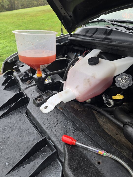

When filling and burping the system with coolant, is it normal for the resrevoir to fill with coolant?

Ibe never used the funnel system instead i opted for a vacuum fill system recommended by Chevrolet and cleanco. But by the picture it appears to be a simple junior high-school science experiment in gravity and or how liquid levels work.( The level appears higher in the funnel than the expansion tank)perhaps clamping off the expansion tank while doing this process would help or unbolt the expansion tank and raise it above the fill line in the funnel

It feels like at least a senior high school experiment to me 😢
Good tips, thanks!

im pretty sure that if you raise the expansion tank higher than the funnel the coolant will lower in the expansion tank and rise in the funnel. If so you have completed the course send me 65.00 and a self addressed envelope and when the check clears ill send you your diploma suitable for hanging 😂🤣😅

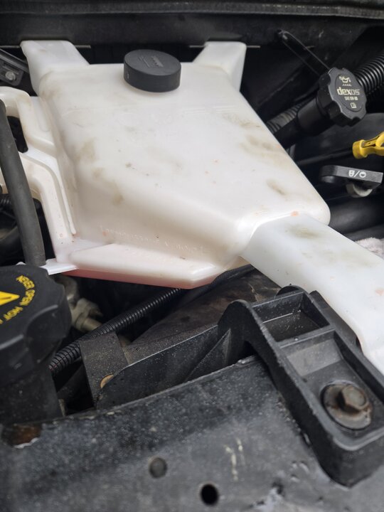

The engine is not overheating, it won't take any more coolant or release any more air, I ran out of time to take it for a ride. I hope its all good for tomorrow. Its cold and raining all day over here. Just got finished wiring up some electrical stuff for monitoring and maintaining temps before it got dark. Everything takes me a really long time.

Well hopefully you got it and will have no further problems. In the morning before starting the engine, pop the radiator cap and look to be sure it still topped off . If not top it off and put the cap back on before starting do that for the next couple of mornings. Till your sure all the airs out

Bazinga! No overflowing coolant on the ride to our first job or after running the TM for 30 minutes! 🥳
